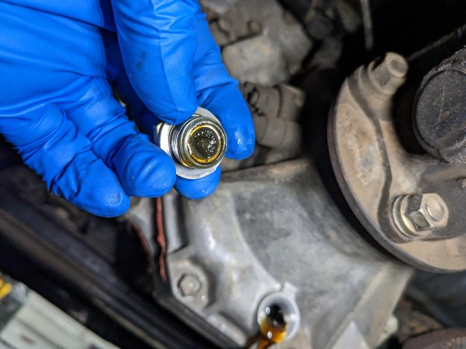

Did my front diff fluid a few weeks back when I was doing diff bushings, finally got around the t case and rear diff.
30k and t case fluid looked almost new and both magnet plugs had barely a pea size amount of fine debris. Rear diff fluid seemed very premature as well with a gold hue to it but I'd rather do it too often.
Toyotas, man!

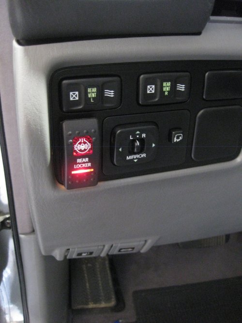

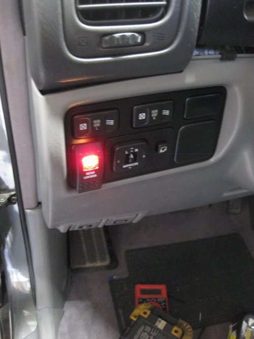

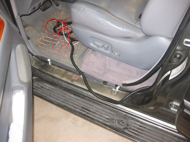

Spent about 5 hours wiring up the new LC locking axle in the '99 LX 470 with the Trail Gear harness. Works like a champ and doesn't look too aftermarket-hokey. Had to egg out the dash hole quite a bit to fit the harness and switch.

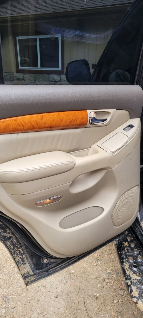

My driver's switch panel had a broken tab so the whole thing would flop around every time I pulled up on the window switches. So I swapped the switch panel, as well as the armrests, and finally got the little covers for the ashtrays (which had been broken off by the PO). I even cleaned all of the 🤮 out of the little grooves on the switches.
It's all cosmetic, but it's a Lexus, so we are fancy like that. Pinkies up. 🤩
