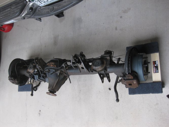

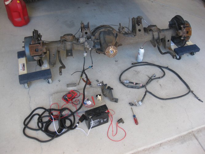

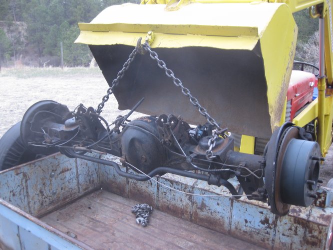

Yanked the locking junkyard axle out of the trailer and put in the garage before the storm. Trying to get a Trail Gear aftermarket harness to work with this '99 LC e-locking axle, to go in my '99 LX 470.

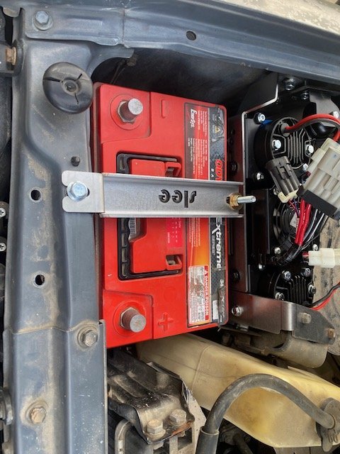

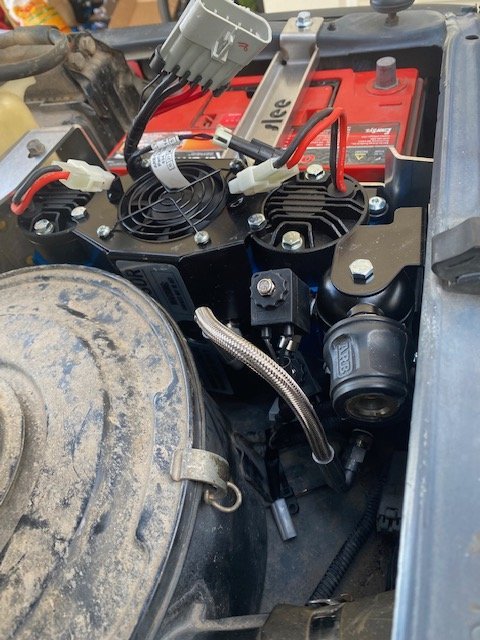

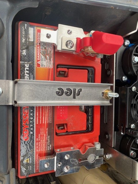

Well, I finally got around to getting the locker process going on the truck. Started out with the Slee battery tray/compressor mount kit. Man, what a pleasure to install. So well done! Decided to cut out the blade fuses that come with the compressor in favor of some buss fuses. Amory has a way with convincing me to do things the clean way.

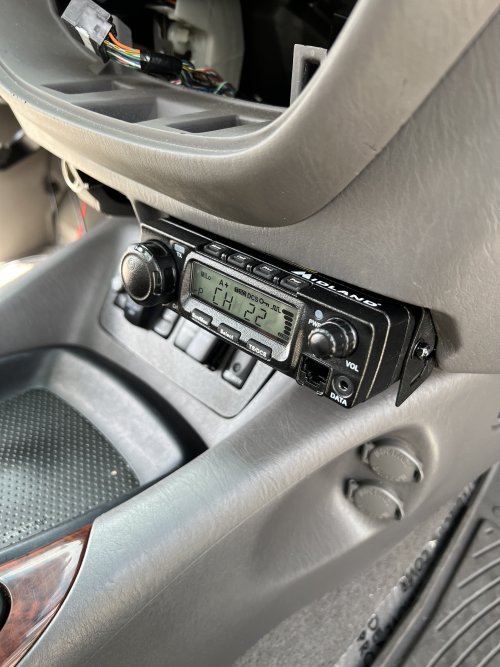

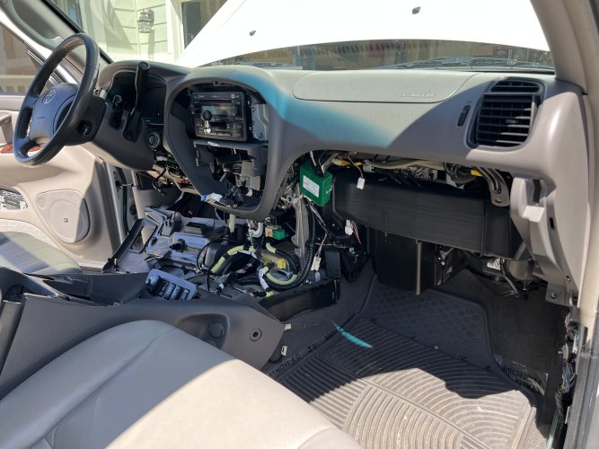

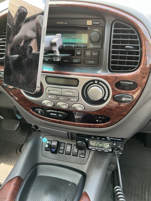

I finally installed the MXT400 in my Sequoia. It was a challenge as I had to remove most of the dash to get to that spot which holds a set of cupholders. The back of the MXT400 did hit a support bar because of the length of the unit so I had to make a little notch in it.

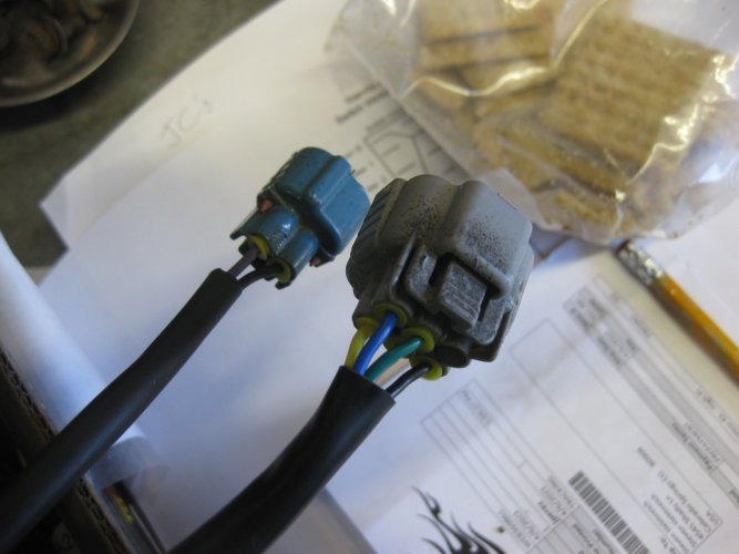

Swapped over the 100-series axle wiring connectors to the Trail Gear locker harness and have success. Locker engages and disengages as it should.
Now, to install the '99 LC locking rear axle into the locker-less '99 LX 470....
