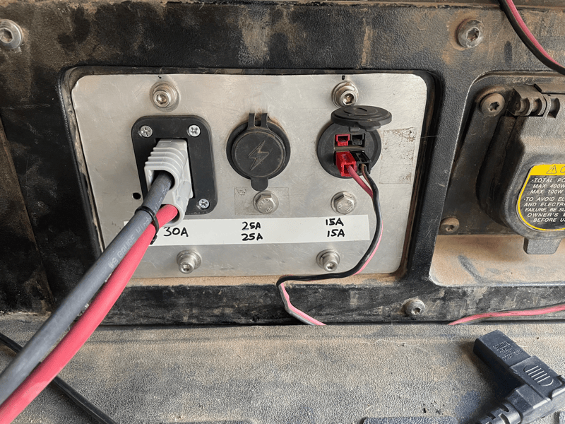

Upgraded up a few things in the chain so that there's nothing smaller than 8 AWG or SB50 from the truck battery to DC-DC all the way to the lithium batteries in the box.
Got the total voltage drop down to about 0.65V compared to what the truck charging reads at the input to the DC-DC with 18A of charging on the output (so full 220W it appears, about 5% total drop end-to-end). This is a significant improvement. Was getting around 1V to 1.25V drop since there were a few lengths of 10 AWG still in the circuit and I was using PP45. This was causing the DC-DC to current limit and the most I'd see is roughly 180W of charging.

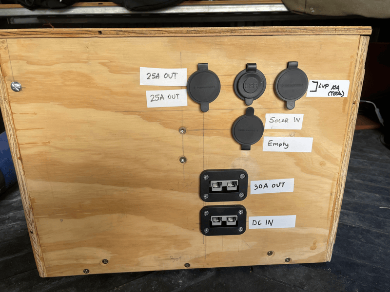

Also added an SB50/30A output to the battery box to accommodate a 300W inverter I'm thinking about mounting. Just not sure where yet. Probably time to start thinking about Mk3 of this thing, which is to put the whole mess in something the looks less like ass. Or Mk2, rev. D, which is to paint it at least...
Stumbled into some 4 AWG marine wire that's duplex jacketed. The prospect of replacing the front-to-back run with it isn't high on when I think of a few of my favorite things.

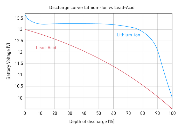

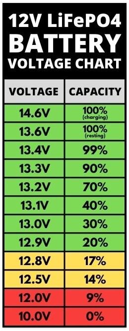

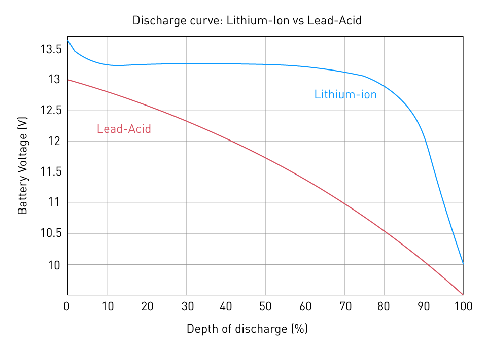

I typically use voltage, but just as a close proxy for state of charge. I don't really have another easy way for the current or AH draw. When I get below 13V I charge :) I know this isn't perfect, but for how many charge cycles this will see, I think I will be OK.

I didn't mean to imply otherwise @LARGEONE. I only meant as a general rule not to trust voltage on lithium the same way as you can with lead-acid.
The chart you show is right on but a graph to visualize how narrow the voltage difference between 100%, 80%, 20% and 0% is between the two types. You want to stay between 20% and 80% on lithium for long life and safety but the high/low change is on the order of 0.25V across this working region while on a lead deep cycle you'd have 2V of room to voltage change to work with over that range.
The point I failed to make is when you have this narrow margin of error your meter quality comes into play as to how much you're sure you're staying between the ditches.
For example a 3-3/4 digit DMM might specify a 0.1mV to 100mV resolution depending on range and 0.5% + 4 counts accuracy.
This means if it has a 40V range it can show 04.00V to 39.99V, thus the resolution is 10mV per step. When displaying 13.10V the 0.5% accuracy will means the measurement could be as much as 0.0655V in error plus the 0.01V resolution plus 4 counts of the least significant digit.
So that means when the voltage is 13.10V the DMM could show as low as 12.99V up to 13.22V and be within it's specifications. It's probably better than this (likely close to 13.03V to 13.18V) but you don't know. In any case this amount of uncertainty is only enough to give you an estimate within about +/- 25% as to state of charge across the plateau.
Using 13V as the re-charge point is safe in the sense you'll never risk dropping off the cliff below 20% but you might not end up using a lot of capacity if it's really closer to the 45% state of charge when you think it's at your 20% floor.
On the charging side this theoretical DMM is good enough to make sure you don't go too high (this being above 14.6V) as long as you stop at around 14.45V.
On lead-acid using a DMM to judge state of charge based on DMM voltage you're able to estimate within a couple of percent because the SOC-vs-voltage response is so much larger and linear.
There's not much you can do about meter accuracy, even calibrated it is what it is based on what you're willing to spend. So if you want to really know it's considerably cheaper to get an accurate enough (because 1% is fine due to the larger changes in magnitude and time averaging) current meter than it is a better voltage meter in this situation. To further complicate the question a cheap DMM is often still quite a bit better than your typical panel mounted volt meter, which may only be full unit accuracy (+/- 2% is not unusual), so showing 13.1V could very plausibly be as much as 0.25V in error and that's enough you could be at 20% and think you're at 80% or vice versa. To some extent you can calibrate by comparing to a known good measurement but the offset may not be consistent, such as the error may drift with temperature.
It's totally a question of what you need, though. Warm beer in a fridge on a weekend trip is not a problem vs living full time off grid losing a fridge of food that could be a real problem vs running medical equipment where it's critical.

Thanks for the additional info. It is amazing how flat the voltage stays on LiFePo4 through the 80 down to 20ish. Love these batteries!

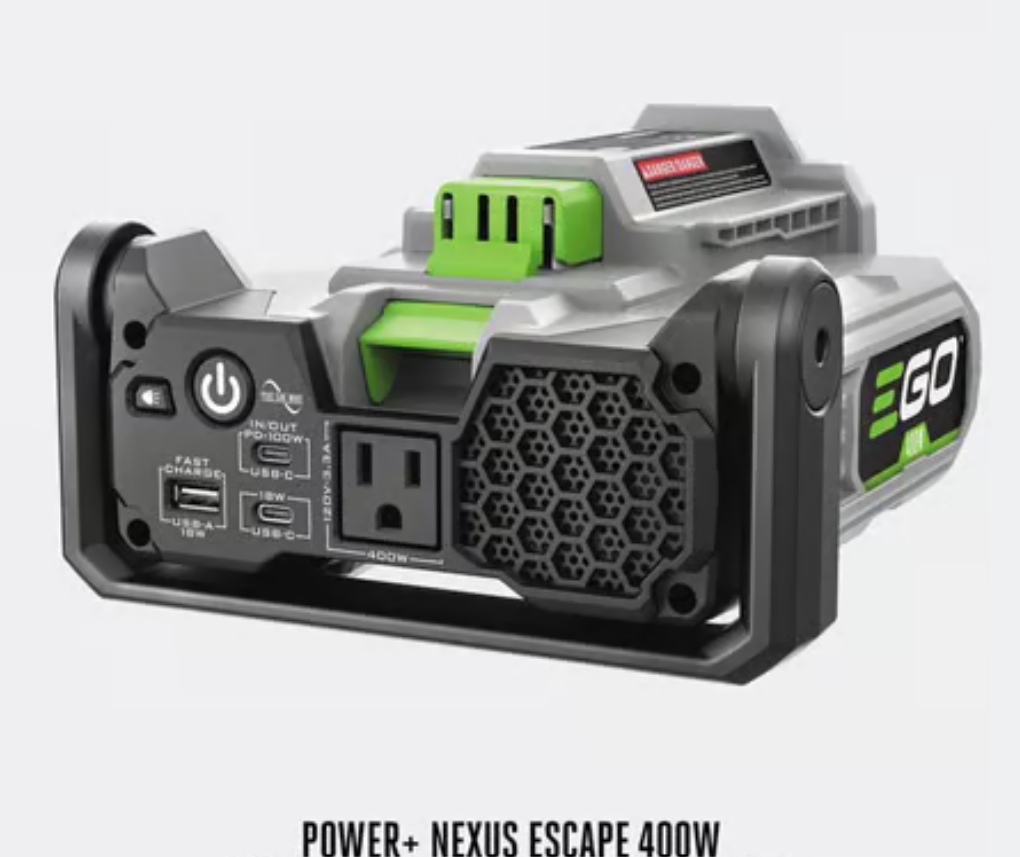

I use EGO for my outdoor power use. Since I do my driveway and my neighbors and they are both long, I have two 12ah and two 10ah batteries for my snow blower, all at 56V.
I also have dual batteris (odyessey AGM) in my 200, but not in the Taco
For my EGO Batteries I have a PAD5000 Inverter 400W sine wave inverter. Unfortunately it doesn't have the right 12V out puts for a fridge, It has USBs and a 110V AC output.

How long would my 400W PAD5000 Inverter power the fridge with 1 12ah battery?

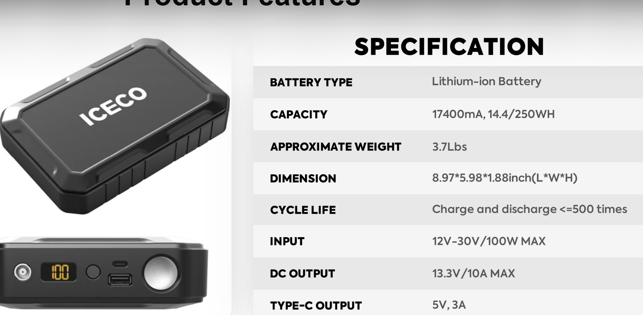

ICECO sells a 240wh battery they claim will keep your fridge running 11 hours, The Jackery 600D supposadly will run a fridge for well over 24 hours. Both of these are at 12V
How long will the 56V 12ah Battery last supplying the 12V fridge power at 110V. This is the question I am starting with.
Since I have the EGO Hardware, I will test it when I get the ICECO VL35PROS I am about to order https://icecofreezer.com/products/vl35pros-iceco-freezer
Now if my EGO Inverter had a 12V accessory out put this would be a simple calculation as it holds more capacity then the battery pack ICECO sells and would it be incorrect for me to assume roughly equivelant to a Jackery 600?
What I found from a Google search is a 12V portable compressor fridge typically draws between 40 to 100 watts (about 0.4 to 0.9 amps at 110V AC). Based on testing I saw lets assume 40 watts when compressor is on so 0.4 Ah's. Is that a fair assumption with this fridge?
the 56 V 12aH battery would provide about 6Ah 110volts. So if the compressor was running constantly that would be about 15 hours. I think its about 30% duty cycle depending on the conditions. If to make this conservative using a 50% duty cycle, we ran the Fridge on 110V with 1 12aH 56 V battery through the 400Watt 5000D EGO inverter, it should power the fridge 30 hours. Now I have multiple batteries I can swap in to make that longer if need be
I am sure I messed something up with my math, but this tells me not to waste money on ICECO's magnetic 240wh Battery for the fridge as I already have something much more capable in Romer's Garage

Does your Tacoma have a factory inverter? I run my 250 fridge on a small Ecoflow battery. It will power the fridge for 24 hours. I charge it while driving with the 250’s inverter. Doing similar could extend your times.

Where you'll need more data or testing is conversion loss. Inverters are lossy, even good ones. I would assume the 12V -> 120V to be no better than 80% by the EGO without specs or measurements. It's not specifically a knock on the device, just the nature of them.
For comparison in this size I have a Samlex SA-300-112, similar pure sine, 300W, etc. It's spec'd 89% efficiency and no-load of 0.24A, both of which I've found to be accurate.
I've done a little bit of testing running my Engel with it but nothing too rigorous at this point.
For example, approximate numbers. My MT45 fridge draws 34W running directly on 12V DC. The raw numbers measured by the battery shunt were 13.07V at 2.60A. The Engel compressor is natively 12V so this is a good number to have in our backpocket.
The inverter powered on, fridge unplugged the draw was 3W, that being 13.10V at 0.24A. This is the no-load inverter draw and matches the Samlex specification very well.
Fridge plugged in but dial turned OFF the draw increases to 6W, numbers being 13.10V at 0.46A. This appears to be the consumption of the SMPS inside the fridge that converts 120V to 12V.
The fridge running on 120V (thus battery -> inverter -> Engel 120V input) I measure 50W at the battery shunt. The actual numbers being 13.06V at 3.84A.
We know 34W of this is the fridge compressor and 3W is the Engel power supply. That means 50W - 37W = 13W was consumed in the inverter.
We can then infer that 3W (the no-load consumption) probably runs the inverter control circuit and 10W is the actual conversion loss. It's not unusual that at light load the efficiency will go down. In this case total inverter efficiency being about 74% (37W at 120V delivered for 50W drawn from 12V) at about 12% rated load (37W/300W).
It's unlikely you'll have this level of visibility into the EGO inverter but it gives you some idea how much power delivered 120V will cost from the battery. It's going to be significant losses.
You're right on with duty cycle, I regularly measure 35% duty cycle on my fridge at beer temps.
Regarding estimate of consumption, in my experience sitting closed and stable I get around 0.75 Ah/hr maintaining and when I put in new beer and am opening to take them out I go up to about 1 Ah/hr.
These are 12V numbers around 13.1V so talking 10 to 13 Wh/hr consumed at the ~35% duty cycle.
If you've read this far the take away is going to be that, with an Engel at least, you are better running at 12V by about 9% since there's a 3W penalty using the internal 120V to 12V power supply.
Secondarily from the battery side using an inverter is going to cost about 25% in my testing. Purely analytically the best case is a 11% loss using the Samlex 89% specification.
Now there is one additional possible loss. If you notice the ICECO battery spec is 14.4V at 17.4 Ah to give you 250 Wh. But it also tells you it has a 13.3V @ 10A maximum 12V output. This tells you there's a 4-cell battery inside (3.6V x 4 = 14.4V) that is running a converter or protection. It could just be a thermal fuse or thermistor, which would be low loss or might be an actual DC-DC converter. There could be some loss there, maybe a few percent. ICECO should calculate that into their capacity but might not. Just something to know if you find you're consistently getting 5% or 10% less time than 250 Wh would otherwise suggest.

I was looking at the battery ICECO sells that provides 11 hours of power and wondered with gear I already have, what could I do with it. The Ego inverter forces a 110V solution if I use those. It just seemed to me I should be able get a day or several days if need be with what I have.

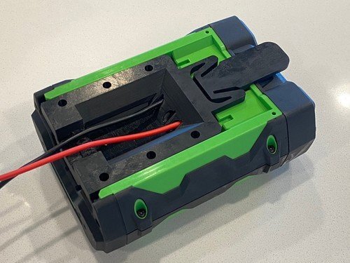

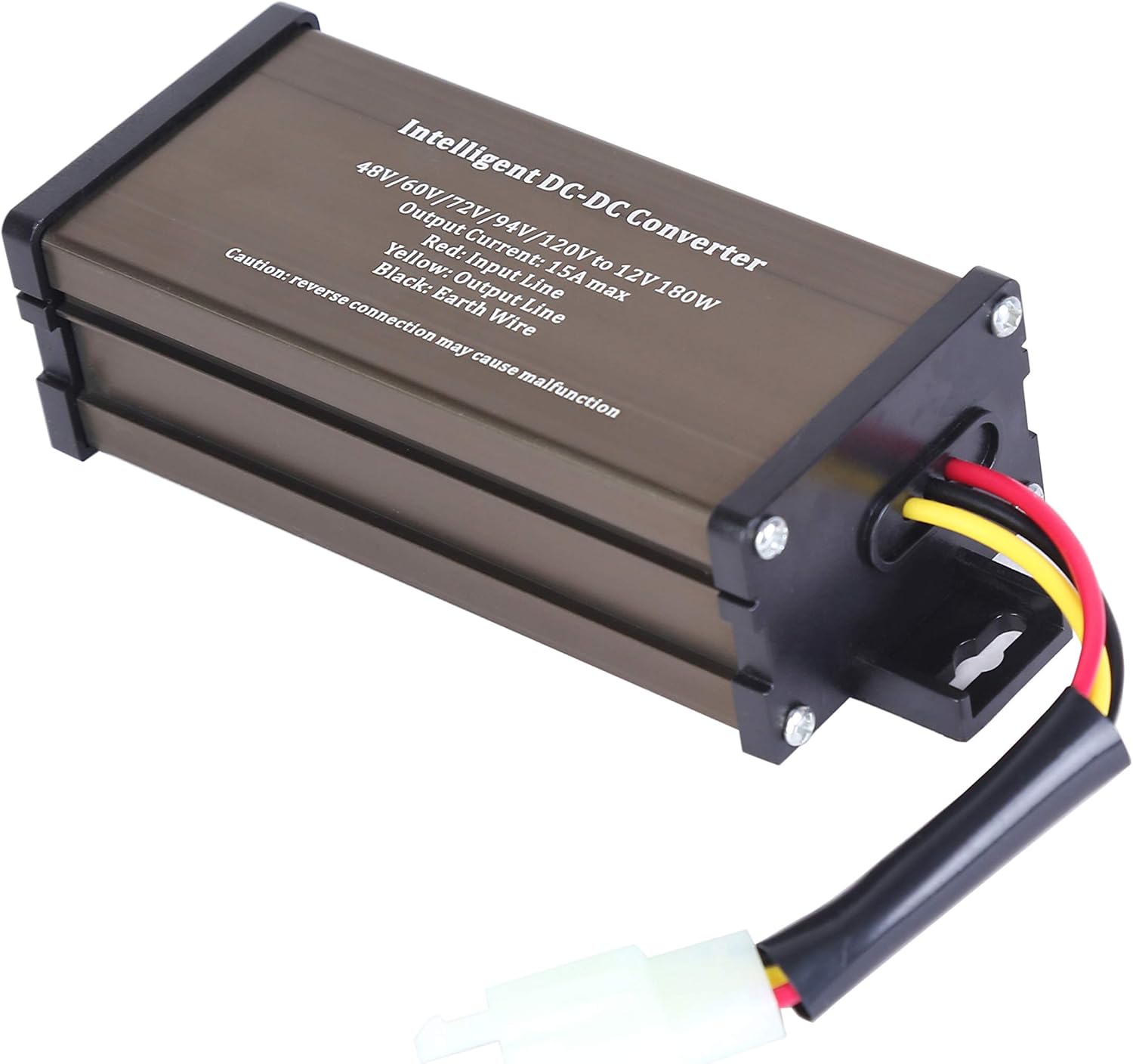

BTW Ken, there's another option.
You could use a 56V to 12V DC-DC to run the fridge.
Wire it to an EGO battery adapter.
Total conversion losses for a buck converter could be fairly low. Less than an inverter for sure. Just depends on how much effort you want to put into it all. Would be smaller than the inverter space-wise, too.

That might be a good option Dave. Thanks
