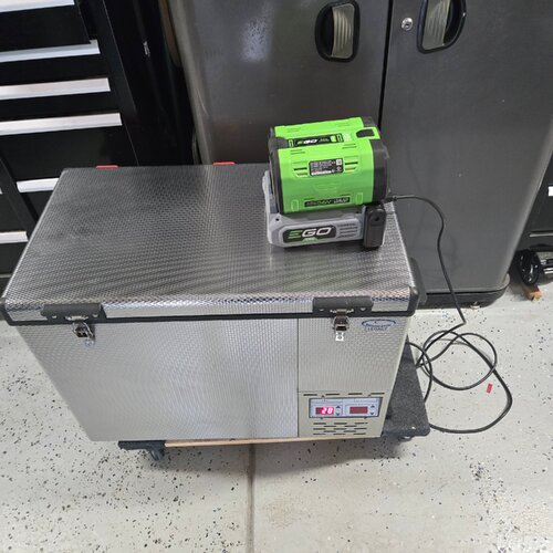

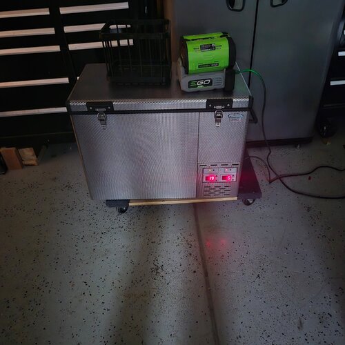

I tested the National Luna. I did two tests;
  • First from ambient to cold and how long it would last
  • Second, I plugged it in and got it to temperature and then swapped it to the Battery to see how long it would last
The second scenario is more applicable to what I am thinking. You get to a campsite after driving with the Fridge powered. You are going to be there several days and don't want to run down your battery. That is true for dual battery systems like I have as well

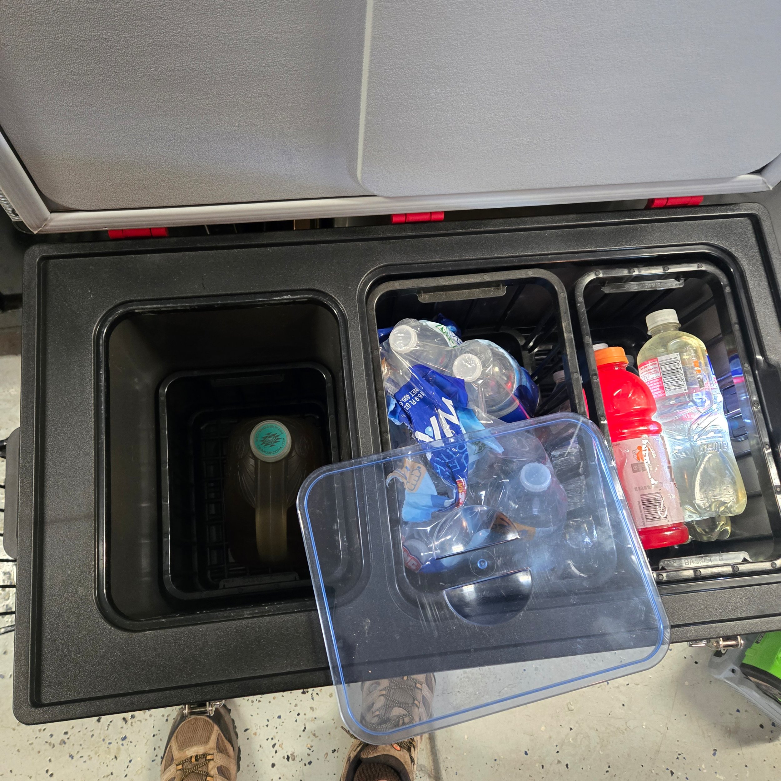

First I loaded the fridge with drinks to simulate a mostly full fridge
My Garage was at 28C or 82 deg F
I then plugged the Ego 12 Ah battery into the Ego PAD5000 Inverter. I plugged the Fridge into the 110 V output
As a disclaimer I am not looking for or trying to say this is a great or the best setup to use a battery to power a Fridge. I was curious what batteries I already had would do.
This test was with a single 56V 12Ah battery. I have two 12Ah and two 10 Ah and even a 7.5Ah and 5Ah battery. the 12's came with my 28" snowblower (which is awesome) and I bought the 10's on ebay as backups if the batteries run out before I finish my neighboors and my driveways (which are long). What this means is I can sawp out batteries to extend this if I want to.
These batteries are all 3 years old and have been charged/recharged many times
I did not open the fridge while running the test
Ok, Test scenario 1 with the Freezer side (left) set to 20 deg and the right side set to 6 deg C or 43 deg F. Note: either side can be a freezer. The battery lasted 15 hours. This is a guess +/- 1 hour based on the last time I saw it running and when it stopped which was a 2 hr window
Test scenario 2, with the fridge already at temp, the battery kept the fridge powered for 20.5 hours. I was right there when it shut off so no guessing.
This fridge is bigger than the one I just bought. It will be interesting to see if there is a difference when it gets here

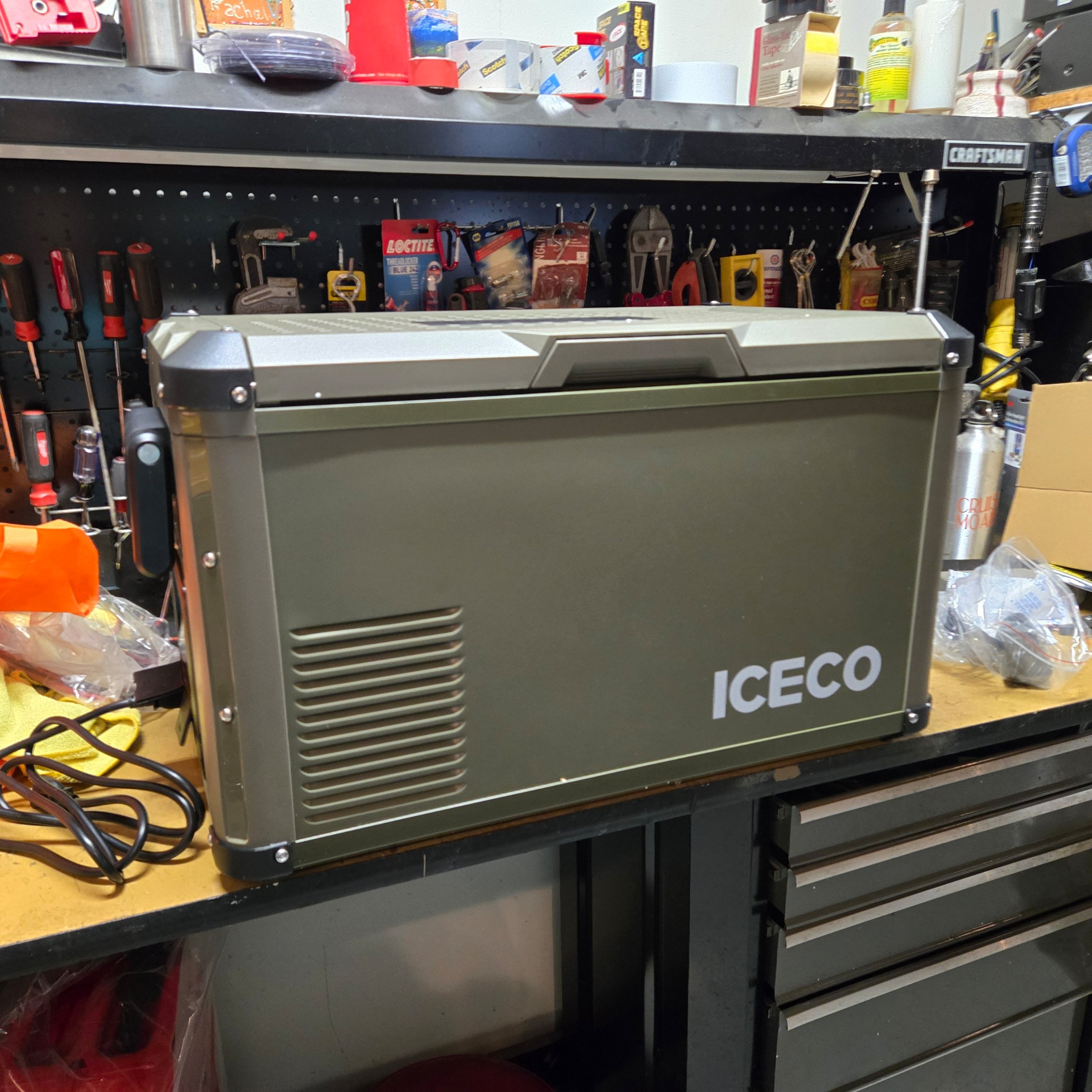

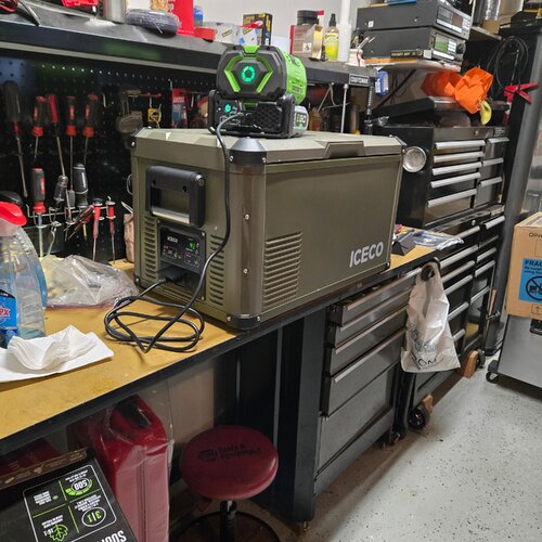

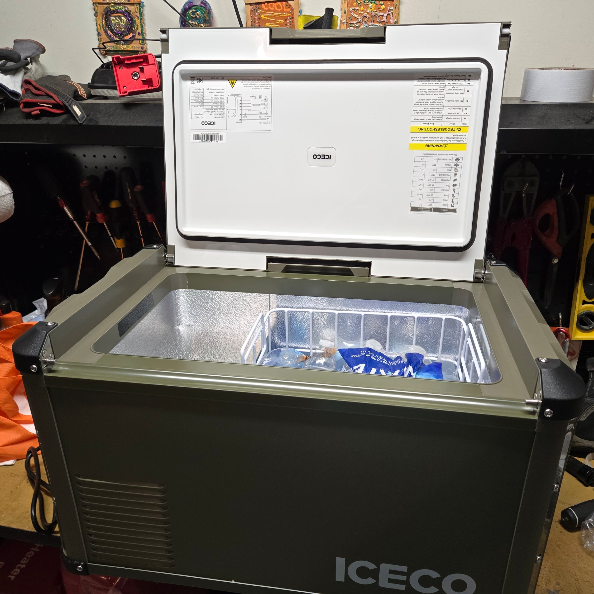

I got the new ICECO Fridge and ran the same test
83 deg F to 43 deg F was 15.5 hours
Maintaining at 43 deg was 25 hours
Both one the 56V 12Ah EGO Battery
Although the weather was a bit cooler during the maintain test

Great data Ken. Thanks for adding so much to the discussion.
Maybe there's something useful in all this, not sure yet just what though to do with it. Your results had me curious.

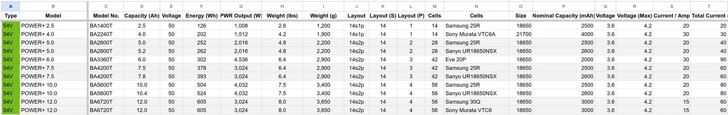

That EGO 12 A-hr is listed as 8 lbs. As you've said 672 W-hr. If we're going with 25 W-hr consumption (50W at 50% duty) you're taking 625 W-hr from it (25 W-hr/hr x 25 hr = 625 W-hr) and the inverter is 93% efficient. I think some of this is maybe leveraging quite a bit on the "wild" part of SWAG but it's ballpark close. I suspect the inverter is lower efficiency than that and the actual consumption is lower, so there's probably just a couple to a few hours penalty for convenience of using 120V.
Maybe say for round numbers you get 600 W-hr useful and then means 75 W-hr per lb.
My battery box, the plywood box, is 44 lbs. The box is of course quite a lot more volume and weight, there's handles and padding inside, so physically just more to it than the sleek commercial molded plastic and there's a fuse block, DC-DC & solar chargers inside so it's self contained.
Boiled down though, the closest like-for-like is the cells in it, which alone are 8.7 kg (4 x LEV60F at 2.17 kg each) so about 20 lbs. For this 20 lbs I get 962 W-hr (74 A-hr x 13V) by specification, so 48 W-hr per lb. My testing shows I reliably get 780 W-hr, which then is 39 W-hr per lb.
In my case that's ~60 A-hr consumed and is the point my cells begin to go wildly out of balance. They track at within about 5 to 8 mV from 100% through the discharge. I stop when the spread hits 25 mV, which is around 20% SOC. So I'm leaving around 14 A-hr on the table in the interest of lifespan on the cells.
Maybe this is a distinction of useful information. I selected these cells for a couple of reasons. One is they are LiFePO4 prismatic cells while EGO is using lithium-ion cells, which in the 12 A-hr pack is 56 ganged 18650 cylinder cells. EGO builds banks of 14 series cells to get 56V and I stole this image from a Reddit post to show how they assemble the packs to parallel them for larger capacity packs. In the case of the 12 A-hr it's Nickel Manganese Cobalt Oxide (NMC) in the Sony VTC6 type.
My reasoning was primarily temperature concerns and general safety but for this I did knowingly accept lower energy density, e.g. watts per weight. We all have lithium cells all over the place, phones, powerbanks, laptops so the question of handling should always be at least in the back of the mind. But in this case it's kind of interesting to see a real life comparison of what LFP vs NMC. Lithium-ion to me is a bigger concern with unknown brands and quality cells or using poor BMS protection, neither of which is really a serious concern about a premium brand such as EGO.
Using LFP without a BMS or abuse can still be dangerous but they are generally better in an accident where they might be physically compromised, for example. Still, LFP is inherently safer by it's nature but for using it is that I have to carry around almost twice as much weight to get the same run time, which turns out to be a significant penalty for that choice. Truth told, until just now I never did the analysis to find out how much it actually was..

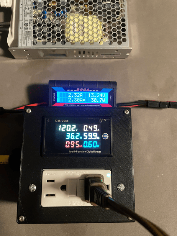

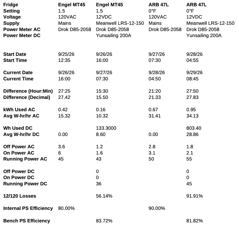

Doing some testing, this time to get some idea on whether running on 12 VDC or 120 VAC matters and if so how much.
120 VAC power measured using a homebrew watt meter, it's a Drok D85-2058 in a 3D printed box with a GFCI outlet. Seems accurate enough. The resolution is 0.01 kWhr (10 Whr) so not really lab quality, especially only using one day per run. But it's good enough for a first pass I think, so figure a +/- 10% SWAG.
12 VDC power measured using the Amazon special 200A (not actually safe for 200 A) watt meter. It's very convenient. I've checked it against known good voltage and current meters and it's good enough. This resolves to 0.01 Whr but I doubt accuracy is better than 2%, probably more like 5%.
I used a 12V power supply to run them on DC just because I was curious about it's efficiency and power factor, not really important to the actual energy consumption. The datasheet efficiency for this Meanwell LRS-150-12 is 87.5% and I found at these loads it's slightly lower than this. I might mention to anyone looking closely that this switched mode power supply is running about 0.6 power factor. Just a for what it's worth and I do not yet know if the Drok correctly shows watts or if it's actually volt-amps. It's showing ~120V so it's right on the voltage RMS so it might be right on watts.
The results.
Don't read too much into the very large difference in energy used. The Engel is set to beer temp (about 1.5 on the dial, so ~40°F) while the ARB I have full of frozen food (set to 0°F). So using more energy isn't surprising. That it's quite this much is curious. I've not seen in practice that either of them is this much better or worse so I may do more looking into this once we eat the frozen food in the ARB and I can load them the same. Might really just be a duty cycle at temp difference since both have similar running power demand.
What is interesting is the apparent internal power supply efficiencies, how much is lost converting from 120 VAC to 12 VDC.
Both fridge compressors run on low voltage AC (about 27 to 45 VAC) so they both take the input voltage and modify it. The 12 VDC is run into a DC-DC boost and the 120 VAC in both is run through a small converter to make DC that is then run into the same boost as the battery voltage. I haven't tried to access the guts of the fridges so I don't know their internal efficiencies.
I can only imply the first stage AC to DC converter efficiency by looking at how much change there is between them.
Conclusion I'm drawing is running an Engel/Sawafuji on DC is very important. Seems to use almost 1/2 the power. While the ARB it's not as important, 120V seems to be only about a 10% penalty.
The calculation I used is (DC avg Whr/hr) / (AC avg Whr/hr)
Also need to mention that the Engel settles quickly to a running power on both 12V and 120V while the ARB jumps around between 40W and 55W on 120V so I used 50W as an observed approximation and not a mathematical average. It seems more stable on 12V. So I'm thinking the AC-DC converter they're using is more complex chasing efficiency, perhaps a resonant converter or something fancy. I need to go back on my notes and see if I notice a different in ripple or noise that would indicate anything. Use a battery on 12V might settle things, too.
The internal PS efficiency is (running DC power on 12V side) / (running AC power on 120V side)
The bench PS efficiency is (running DC power on 12V side) / (running AC power on 12V side)
BTW, don't use the ARB numbers as gospel on all Danfoss/Secop. The compressor and controller could be the same but the 120V to 12V internal voltage converter is designed by the fridge manufacturer and likely will vary, as might the 12V side temperature controller itself and the construction of the box/insulation/lid, too. The Danfoss/Secop parts can only do what they're told to do.
