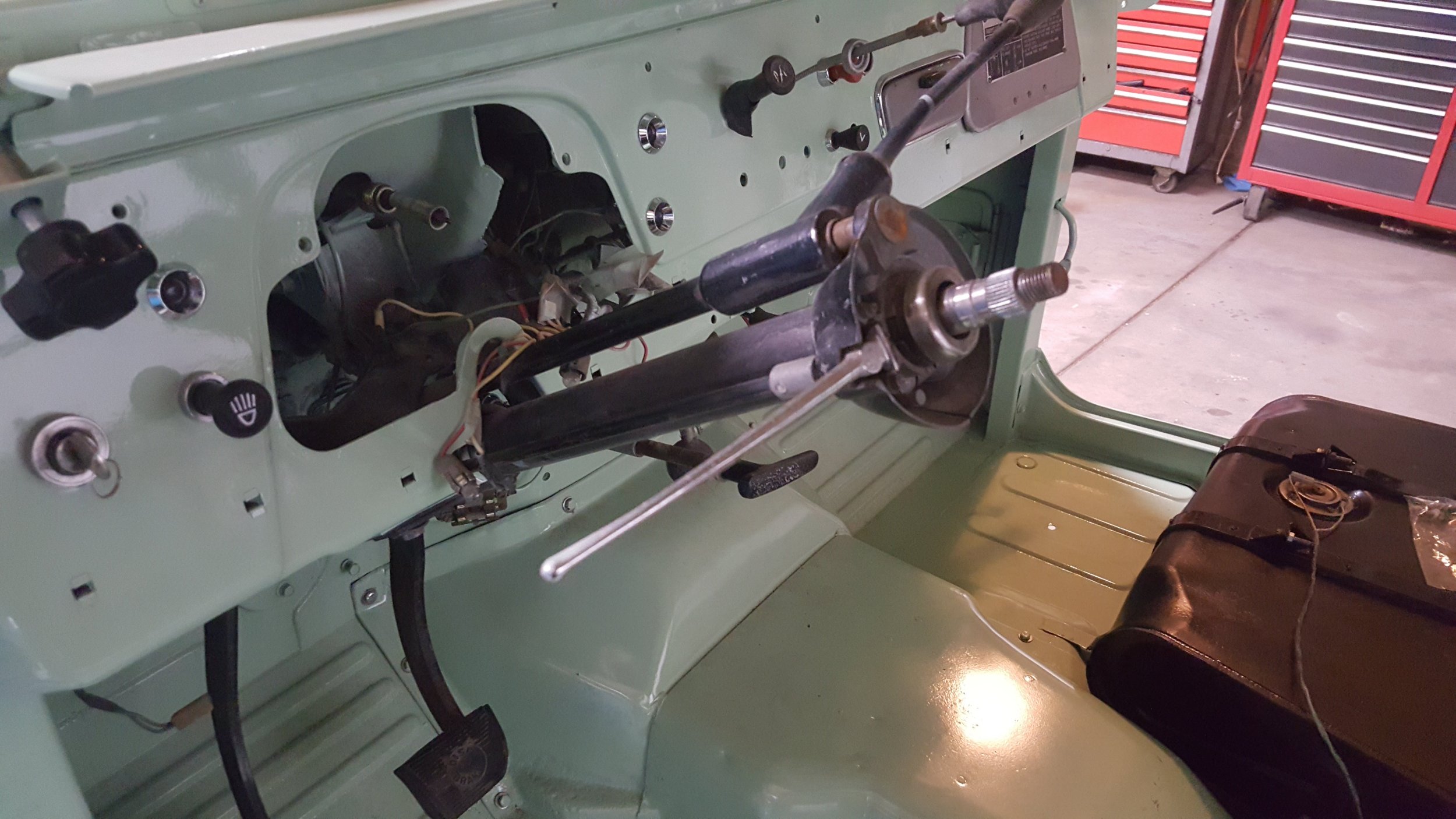

So frustrated that I decided to work on something else and tore into the steering column. I was having issues with the turn signals. I would have to hold the lever in position to keep them blinking turning right, and they don't self cancel. Common problem with early 40's so I had ordered a new turn signal assembly and a new dust boot for the column.
Borrowed a steering wheel puller from O'Reilly and got it taken apart. The turn signal assembly was broken and missing parts and the steering wheel roll pin for canceling the signals was all chewed up.
The original turn signal assembly holds a threaded rod that the column shifter pivots in. I was surprised to see that the new oem replacement part wasn't threaded. Wrong part? Luckily I was able to tap it out and make it work.
New and old turn indicators. Old one has cool chrome lever. New one just painted black.
This is the end of the column shifter that pivots in that threaded shaft. Anyone know if that rubber sleeve is still available?
My shifter 2as bent, so I hammered that straight again.
Epoxied in a new roll pin on the steering wheel to cancel signals.
