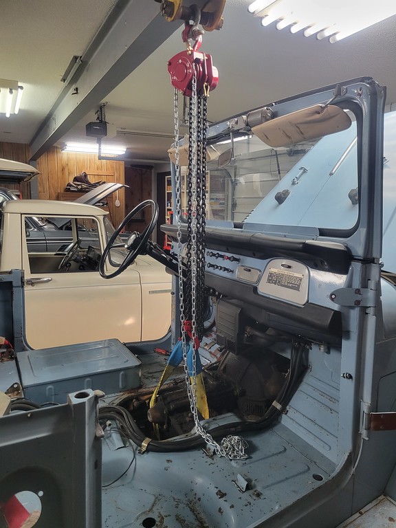

Decided to pull the top so i can use the gantry crane in my new shop to lower the trans/transfer.🙂 had a couple of my co workers over to help lift top off. Should make dropping the trans and transfer case easier. Clutch, transfer case, pto and parking brake all need service.
I don't think the top has ever been off this 40! All the hardware looked untouched and came out nicely and the weatherstripping was stuck tight and hard as a rock. I had to use a hilift and a 2x4 to break it free.

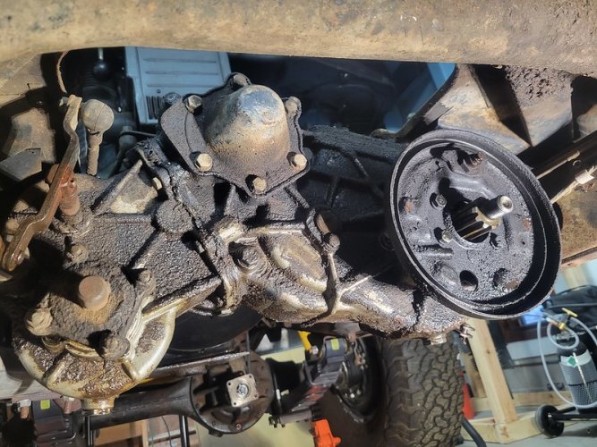

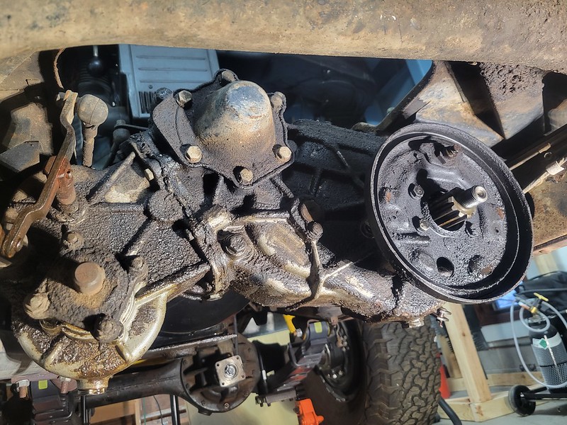

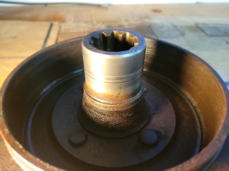

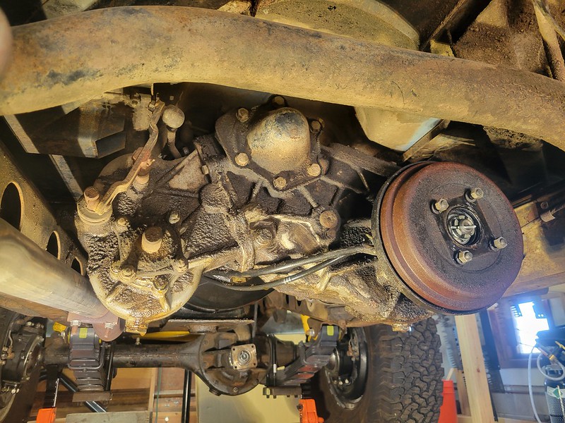

A little more progress today. She's super leaky and greasy.
I struggled a bit getting the parking brake drum off. The nut was cranked on super tight. Air tools to the rescue! The seal surface isn't scored bad, but enough that I might speedi sleeve it like Paul @LARGEONE did on his 40.
Sleeve it?

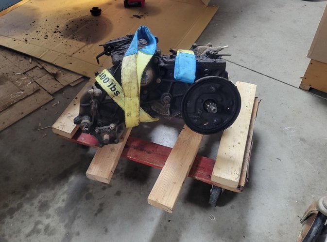

Once I got all the linkages and lines disconnected I was able to unbolt it from the bell housing and drop it down with no issues. Hopefully it goes back in as easily. ;)
Time to clean it up and tear into it.

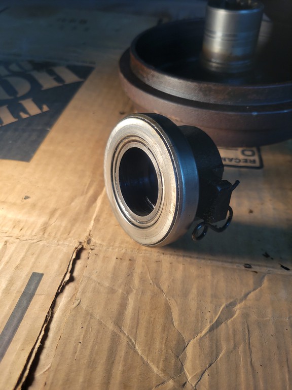

The throw out bearing actually looks and feels fine. Scratching my head now about what possibly could have been causing the horrible noise?
I'll repost the video when I find it. I guess I have all new bearings though, so whatever it is will probably get replaced.

Georg makes an output seal housing that holds two output seals for the drum, supposed to be the end all be all solution!
10,801
I Speedi sleeved mine and it still leaks. I don’t know what I would try next time I tear into it.

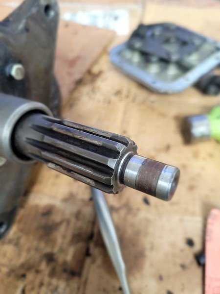

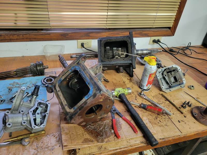

Tearing down the 3 speed box I noticed the input shaft tip is worn where the pilot rides. Thinking this might be where the noise was coming from?
8,081

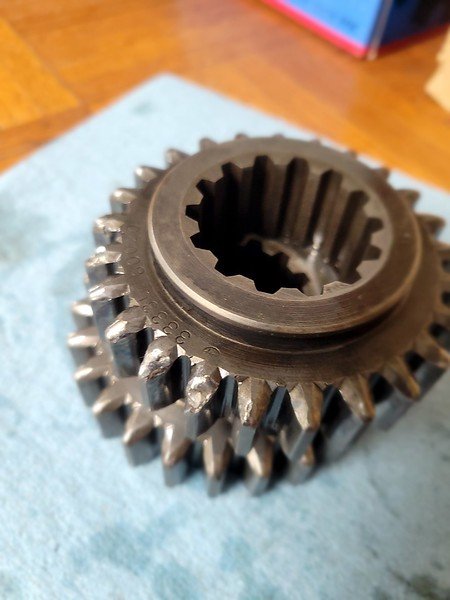

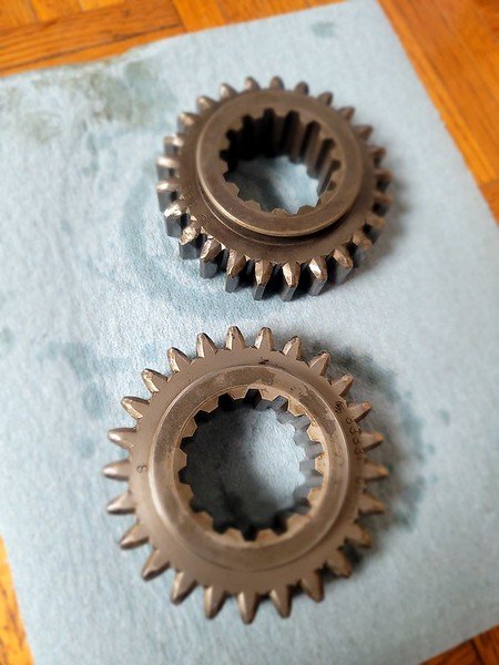

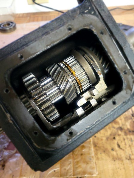

I have a spare 3 speed for parts and am going to use the 1st gear out of as the original has some damage to the teeth probably from past drivers not being used to non synchro 1st. The input shaft on the spare trans is in better shape but the splines are a bit crusty from being out in the weather. Think it would be worthwhile to swap the shafts too? Was hoping to not because I don't have new bearing for the trans and the originals seem fine.
Damaged 1st on top and spare on bottom I'll use.

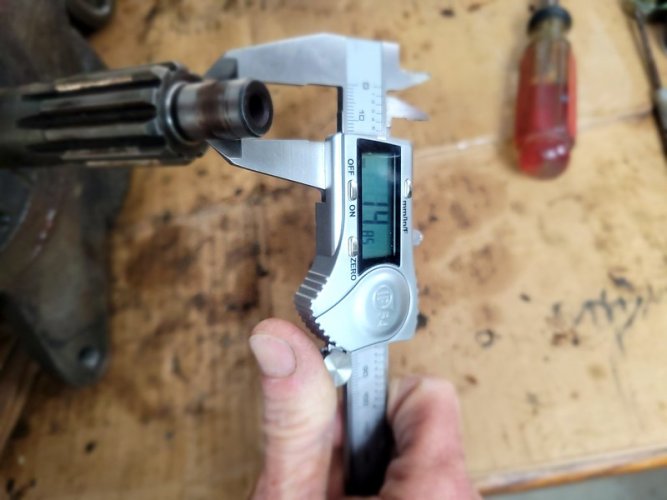

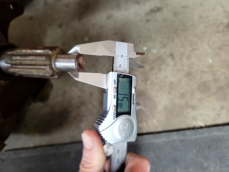

Looks like about .15mm wear on the original input pilot bearing surface.
Think it's worth swapping?
15,688
is the smaller one still really smooth? Or is it bumpy where the brown stuff is?
also do you have a 0-1" micrometer? would be a more accurate way to measure that, or even use the fatter parts of the caliper jaws. I get that it's tough when taking a pic.
No question from your video. That's either pilot or throwout bearing (those only spin with the clutch pedal depressed). And you said the throwout was good, and that wear sure says it's a pilot bearing.
