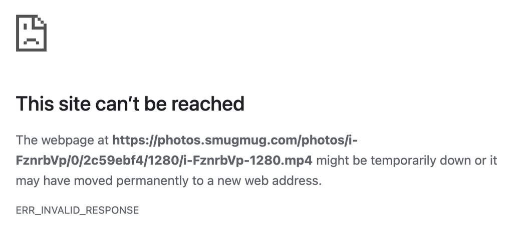

Tried inserting a video, but doesn't seem to be working...
