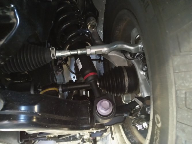

New truck looks awesome but couldn't help noticing the IFS has a lot more 4Runner than LC.
That looks improved compared to the 120/150 platform IFS (e.g 05+ Tacoma, 03+ 4Runner).
The lower arm is definitely more substantial. I'd bet +50% thicker The mount for the shock is moved from on top to the front, which I imagine improves clearance to the CV axle and helps with the it trying to punch in the top half of the assembly.
On my Tacoma I had to offset the lower mount on my FOX to prevent it rubbing the axle when going lock-to-lock. I can barely get a finger between the shock and axle. It's a game of millimeters to put the puzzle of a 2.5" body shock in the stock location. On this it looks like you could fit a closed fist in there.
The spindle and tie rod end are beefier.
If I'm not mistaken the way all of this is configured is pretty much exactly like a 200 series is built. It might be scaled down, not sure on dimensions. But IMO this looks to be a significantly improved IFS, at least from the smaller-than-a-200 truck perspective.

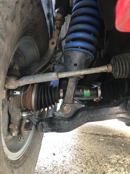

The 120/150 for comparison.

The tie rod looks puny compared to my 100 series, which is all I really can go off. Also the cast aluminum knuckle and tie rod end are worrysome. Cast aluminum suspension parts are all the rage these days but are prone to cracking without warning. Throw in offroad use where they may be smacked by rocks and it's going to be a game of chance.

The spindles on my gen truck are cast iron but they crack and get reinforced, too. And ask anyone's had to cut apart iron TREs that have rusted into one-ness with their steel shafts if aluminum is better or worse.
I'm of the opinion that iron, steel or aluminum, Toyota has the best FMEA tools and isn't making anything worse on purpose. They're up against weight reduction just to be allowed to make cars anywhere like what we actually want. So the aftermarket has to fill the gap of any real world deficiencies.
Plus insert your favorite materials science professor's obvious point that if you don't trust aluminum then you probably shouldn't step on an airplane and definitely do not look out a window at the wings if you don't think it can flex.
