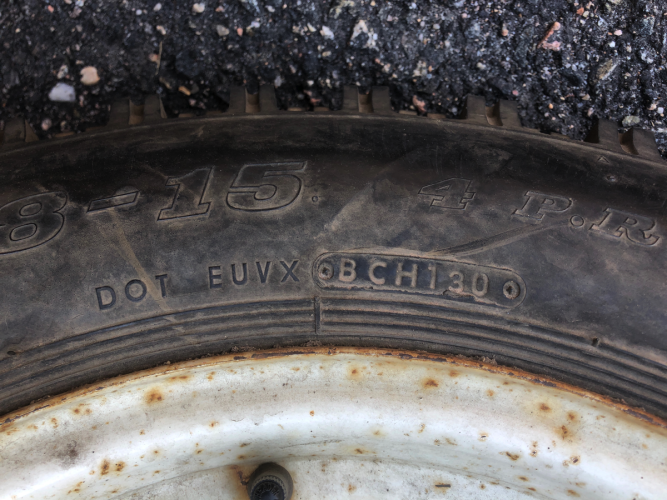

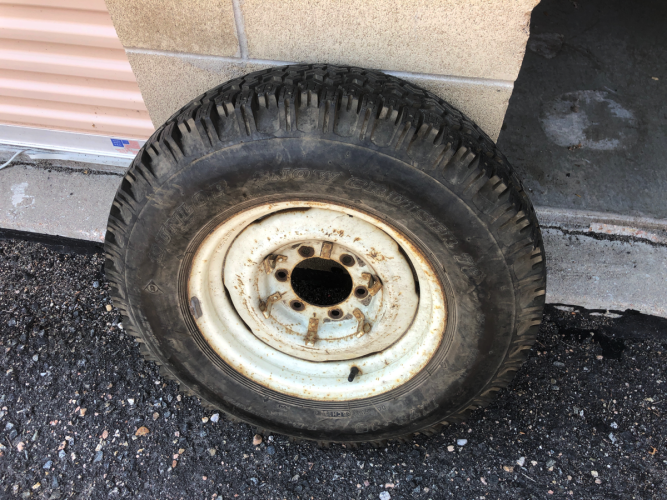

14,192
Just to circle back and close the loop on this tyre thing. Found the original spare Dunlop Snow Cruiser (or perhaps actually one of the original wheels since it's got hub cap clips?) from Dean's 1980 pickup. Size is H78-15 tubeless.
Wheel made March 1980.
Tyre was made 13th week in 1980.
