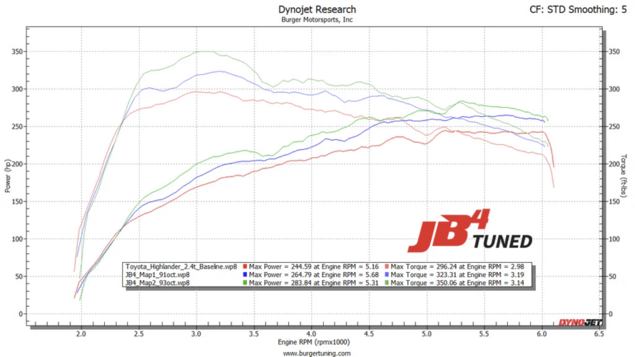

Even at elevation with just the 4 cyl, you will have torque for days. I am guessing that the turbo is fully spooled by 1500 RPMs, and that should mean you have full torque. Now MPGs in that situation will be a whole different matter.
One of the other oddities with these smaller turbos is peak tq will be quite a bit below redline. You can see that on the dyno below. So it isn't like you will have to redline the T24A-FTS to get over the passes.

Just a heads-up, I have used this company's tuners before. They work pretty well. The only mild down side is that while the throttle response is smooth, it isn't as good as a full re-flash of the ECU. Good news is that they don't void the warranty so long as you detach it before taking the vehicle in for service or repairs. It looks like the 2.4 turbo is good for about an extra 40 whp with just 93 octane. You can usually get even more hp with E30. E30 is just a mixture of 91 and e85 to obtain 30% ethanol. That would probably take the engine out to somewhere closer to 60-70 extra whp. This isn't approved for the 250 yet, but they will release the 250 soon.
