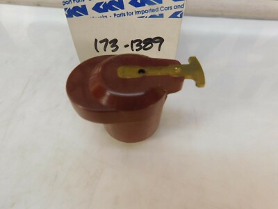

I got a new cap and rotor but the rotor is incorrect for this distributor. Waited 2 weeks for it too...

Would this rotor work?
Those look correct. Mike at Cabe sent me 19102-24121 which has the same shape on top, but the inside is completely different. I think it might be from a corolla.
Here's a pic. The correct version is on top, the one that Mike sent is below, doesn't fit distributor at all.
Distributor appears original to truck and part number is in the range it should be.
