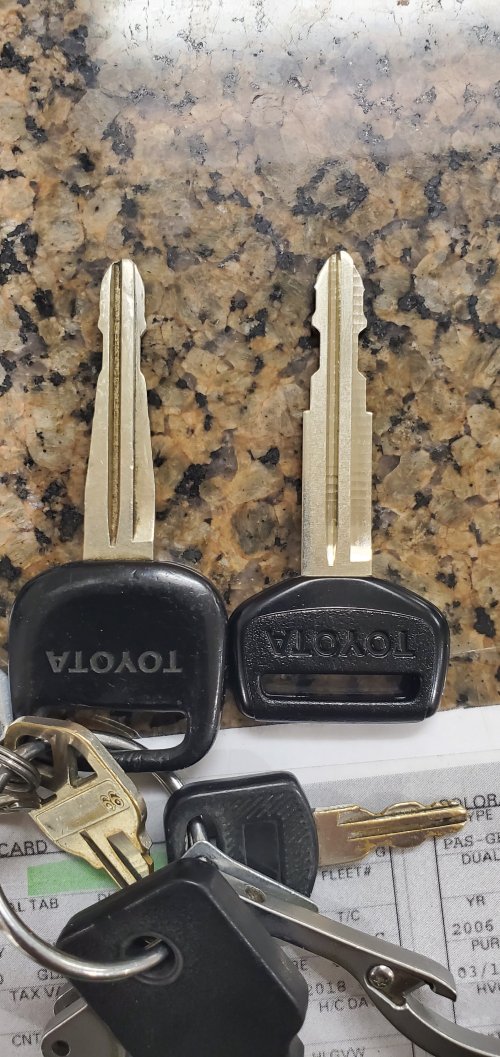

On the land cruiser I got a YotaMD key housing and transferred my keyfob and key to it. So satisfying and a super nice product.
