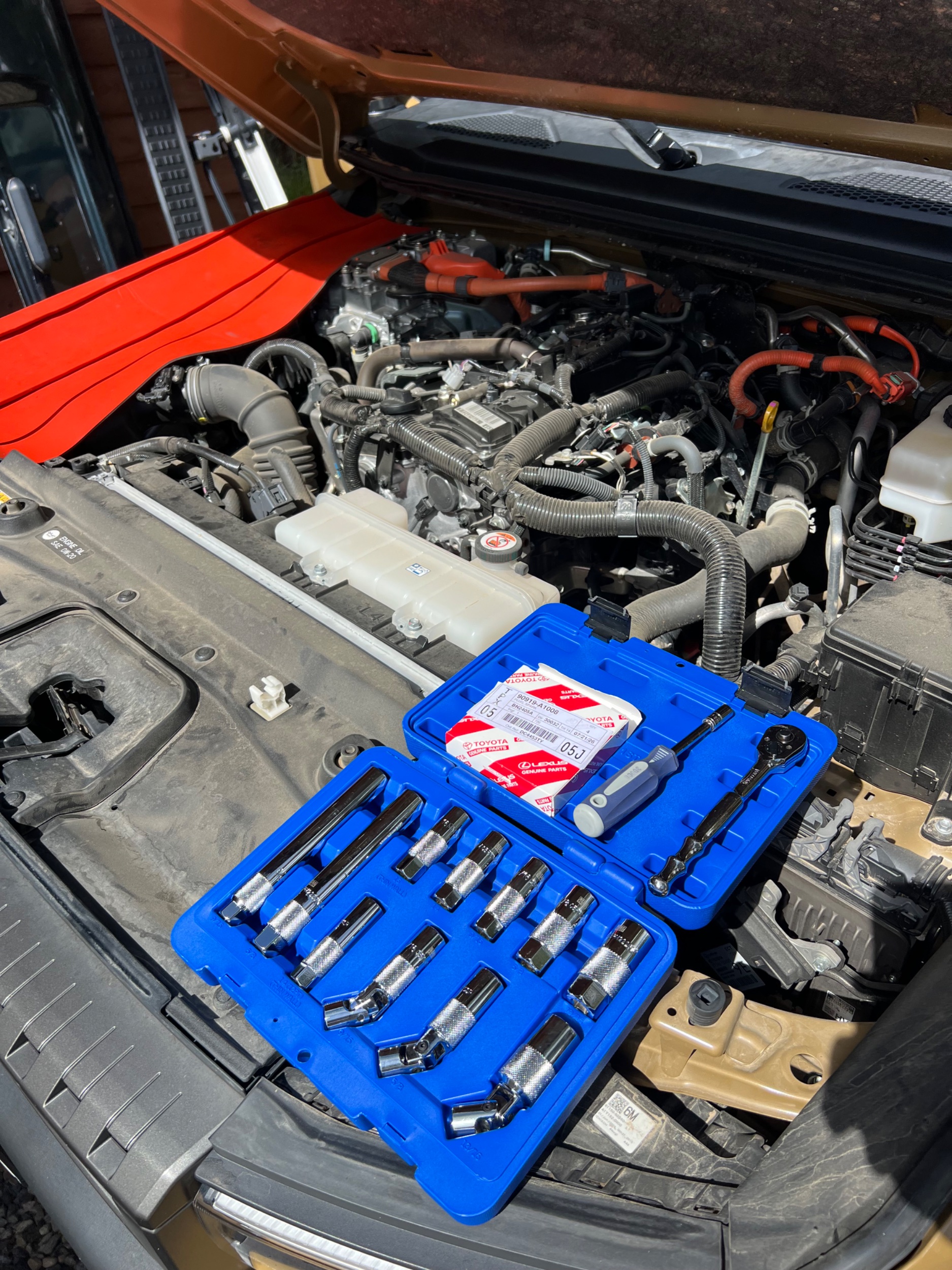

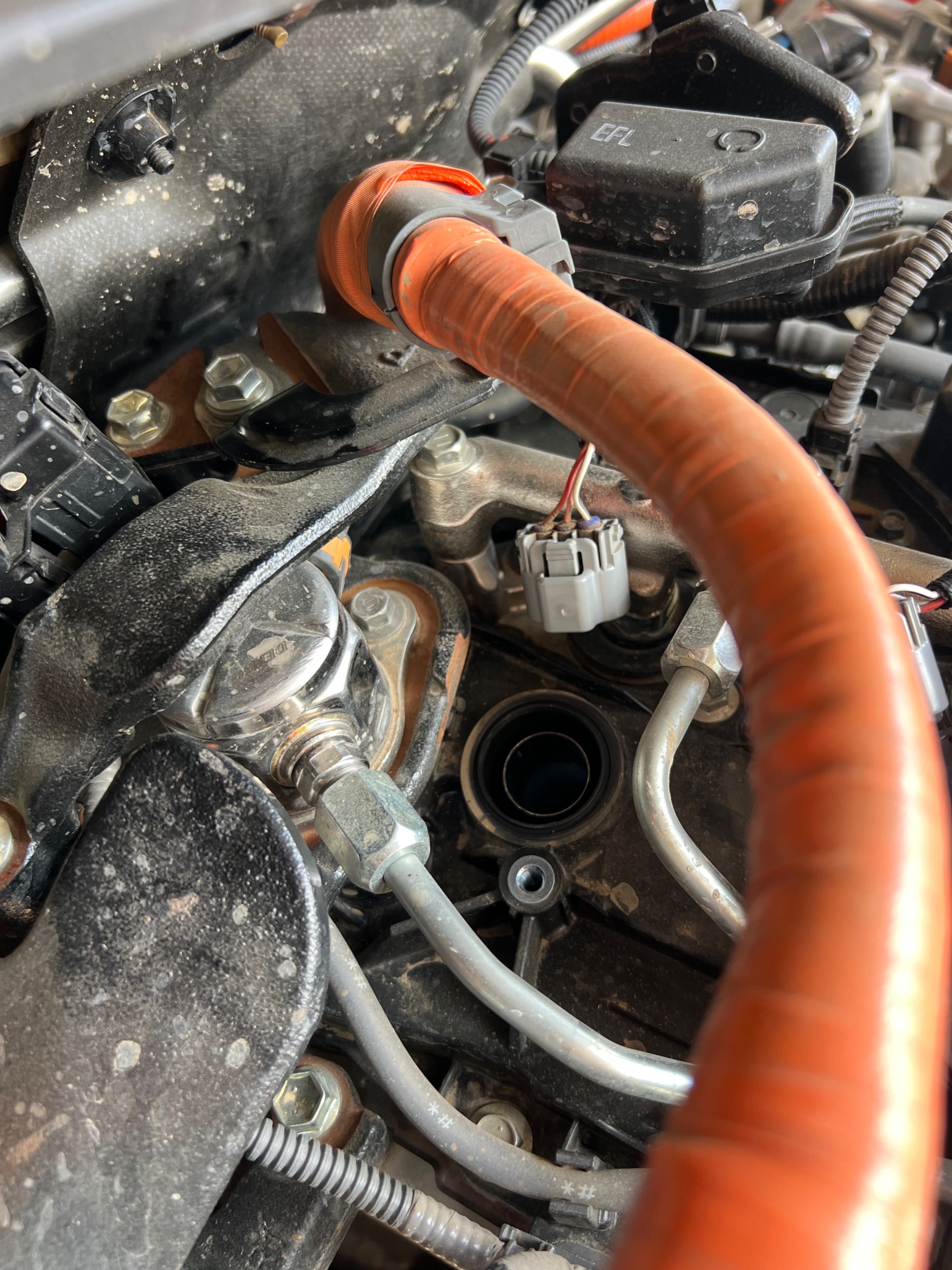

Just did the spark plugs for the first time on the LC250. Easiest vehicle I’ve done plugs on. #1-3 you can even leave the coil packs connected. #4 you need to disconnect so you can rotate the coil 180° to clear the hybrid harness.
#2 seemed to have oil on the threads. Took a little more effort to remove. An extra long plug socket is handy. I still used a 6” extension. Picked up a full set of plug sockets from the Cornwell truck. On sale and I’ll need the Subaru one soon.
#4 clearance. Still easy.

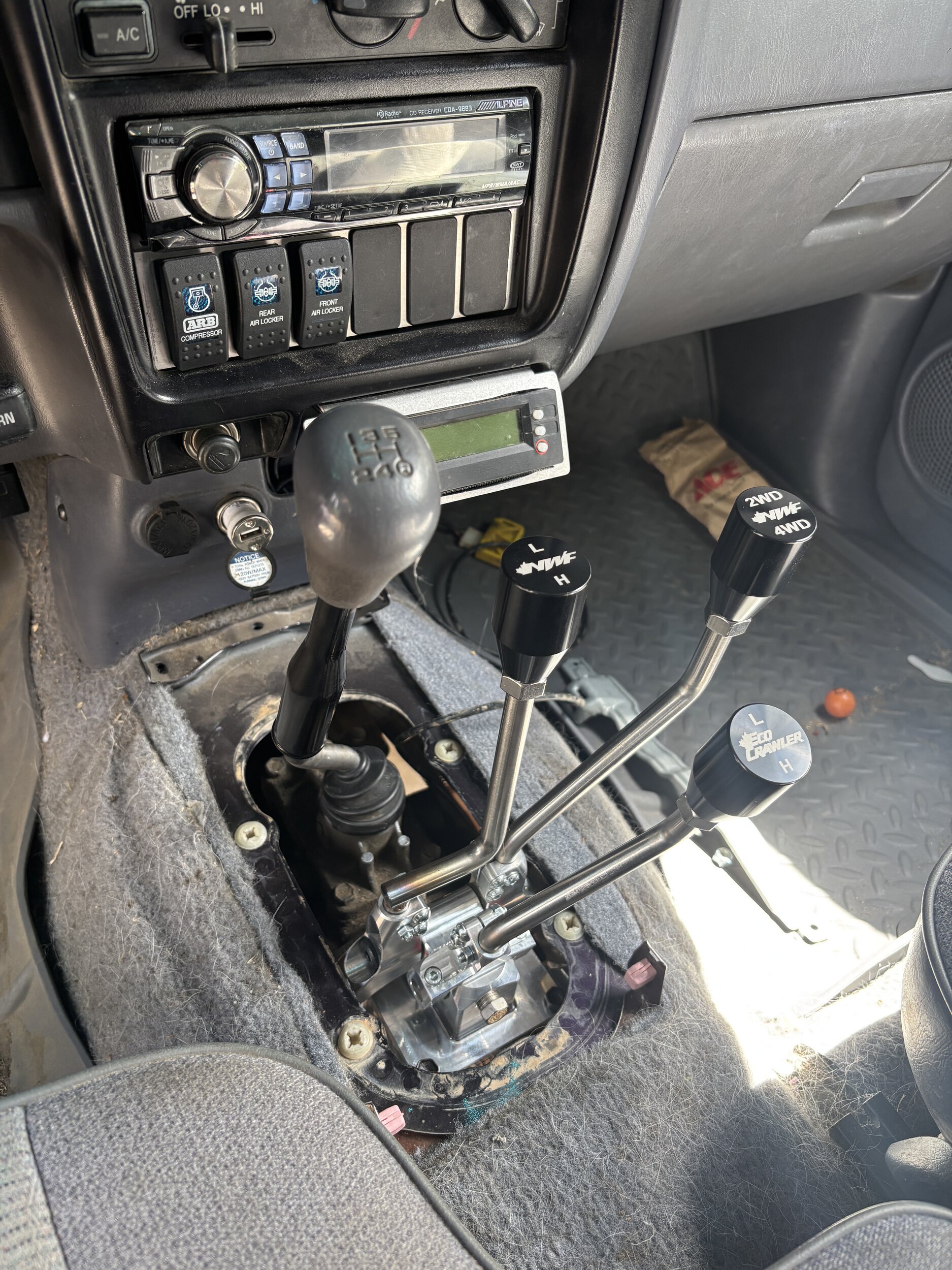

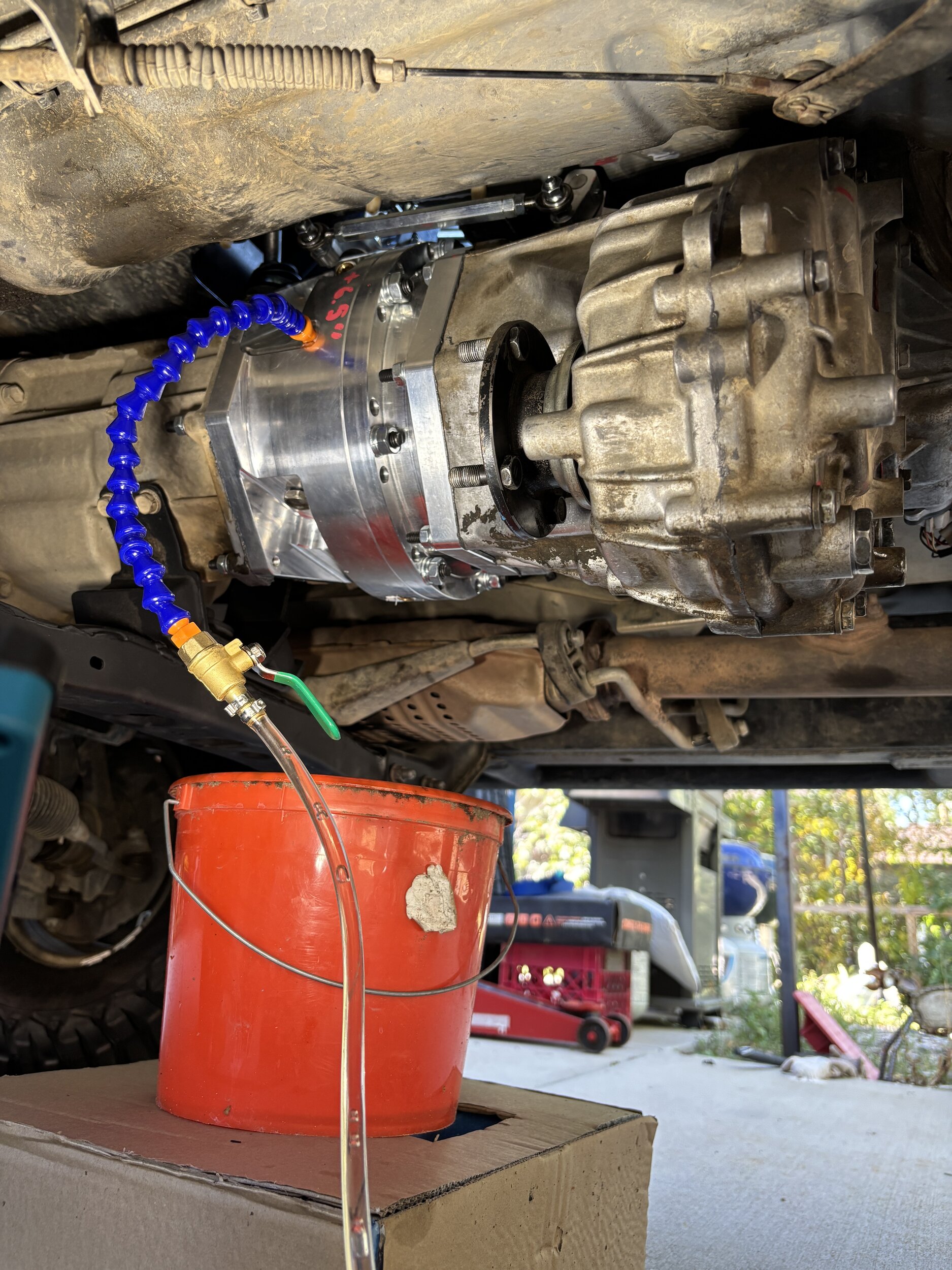

Working on an NWF EcoCrawler install on a 1st gen tacoma. The build and install has taken me 2x longer than I expected, but getting there!
So many shifters! Triple shift seems like a great idea until you have to make sure everything clears everything else!
I've got the same setup sitting in my office.
Planning on getting started with it once winter sets in and there's nothing better to do.
Any major pitfalls I should avoid?

@HoneyBadger - NWF makes a pretty nice machined case unit and input shaft! The instructions are decent and I think they try really hard to be thorough, but I'm a dummy and could have used more information on torque specs. I feel like there is a lot of "feel" with the fasteners.
Seeing what you've built, I think you'll get through easier than me. But some things I noticed along the way:
There are a lot of videos out there with "how to" information, but many jump right in without realizing they should be working on the rear case first. There was one decent one I'll see if I can find it. It helped my confidence on the project having a video in addition to NWF's instructions. I can't believe NWF doesn't have a video that they've produced to give a 1000 foot view - I think it would help a lot of prospective customers.
If you have your OE e-brake setup, you will have to be careful how much you clock the rear case, and you'll need to bend the brake pivot bracket slightly for clearance. If you don't have clearance issues there, you could clock much more, but I don't really believe you could max out clocking and still get the trident shifter to work, but I didn't experiment because I wanted to retain OE e-brake. I clocked a modest amount.
The one big mistake I made is that I overtightened the bolt behind the detent pin that locks the big ring gear in place. This forced the ring gear out of round ever so slightly. It wasn't evident untilI had both cases together and the shaft rotation was sticky. I had to tear the front case apart multiple times and use an additional donor case parts set to isolate my issue among the planetary, the ring gear, etc. So don't be a hamfist on that one. Doh.
Otherwise, I'm still waiting on driveshafts to come back, so we'll see how it goes! I hope any of that helps.

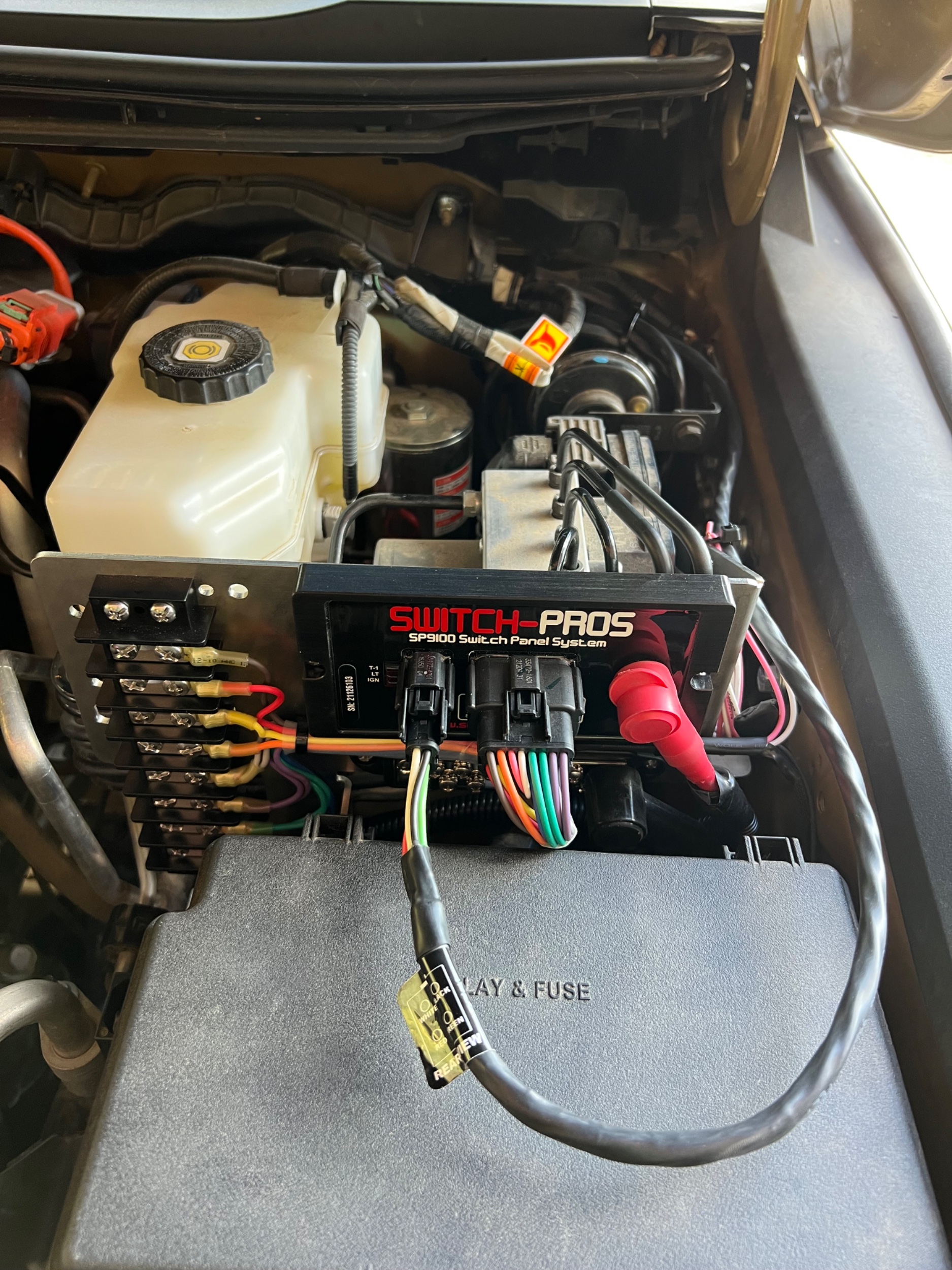

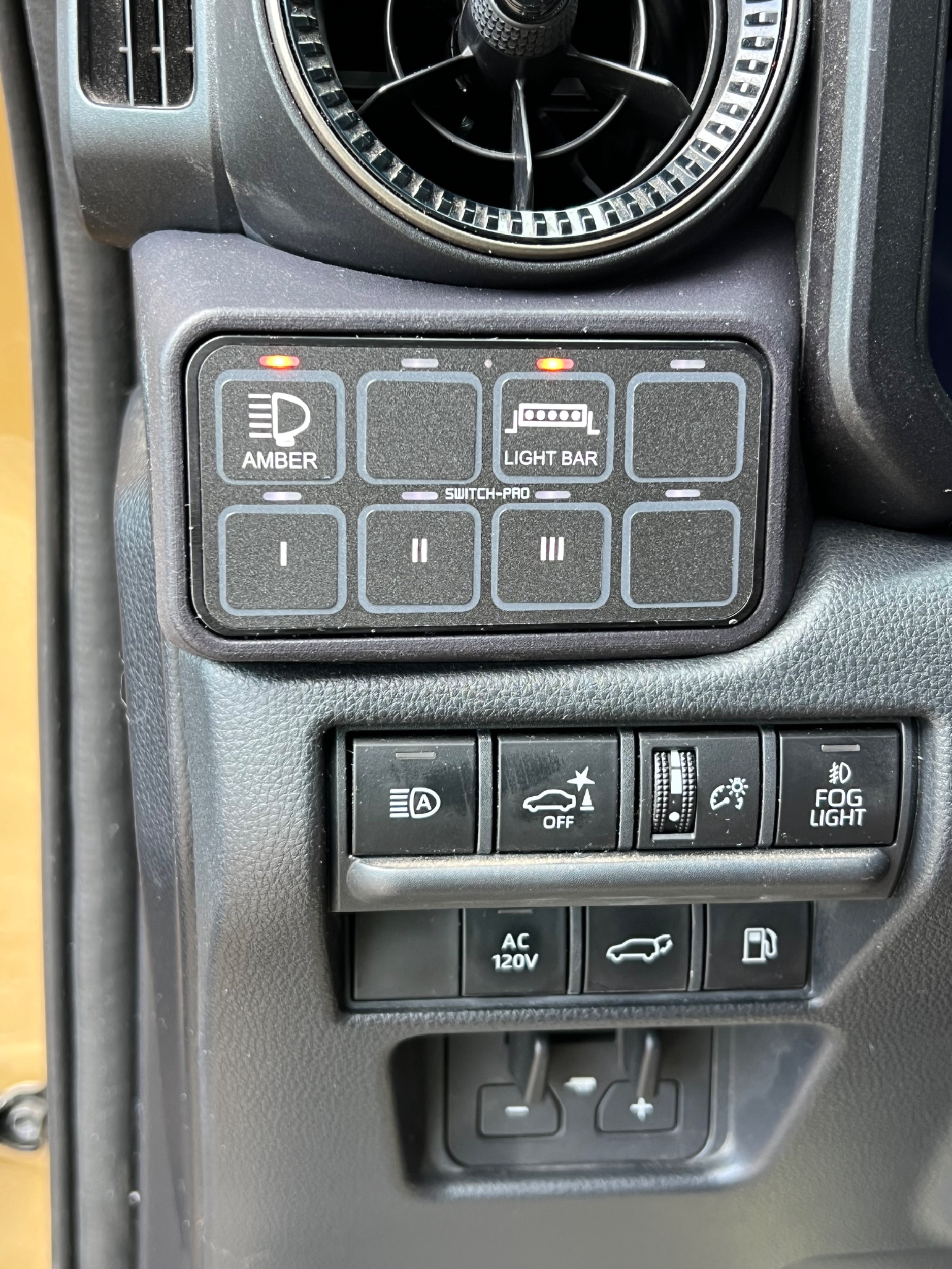

Switch-Pros into the 250. I’ll do a more detailed write in my build thread later. What ever Slee charges is probably worth it with the extra hybrid challenges.
