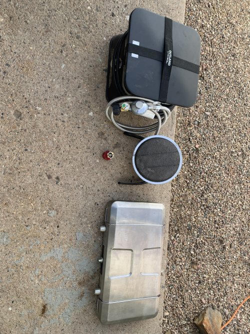

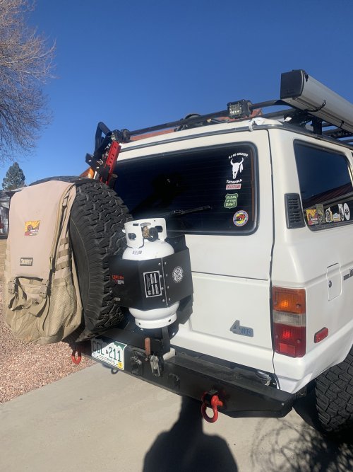

Adding a little Gas to the Rig in preparation for this year’s planned events. Should help with Cooking, Ambiance and Heat inside tent. Refilling one or two propane bottles as needed. Much thanks goes to my friend fabricator and welder. Brian aka PhatFJ on the forum.

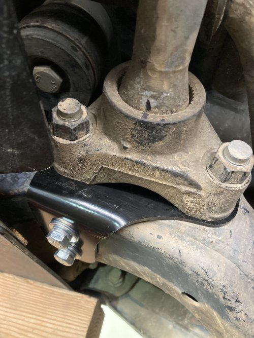

Finally got around to installing the lower control arm/torsion bar support bracket. Overall a fairly simple job. I just spent some time on MUD making sure I was prepared for removal of the torsion bars. Glad it’s done so I can hit some sweet jumps!

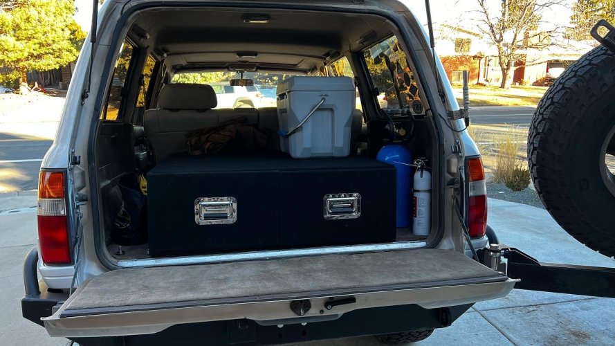

Working on getting my drawer project finished up

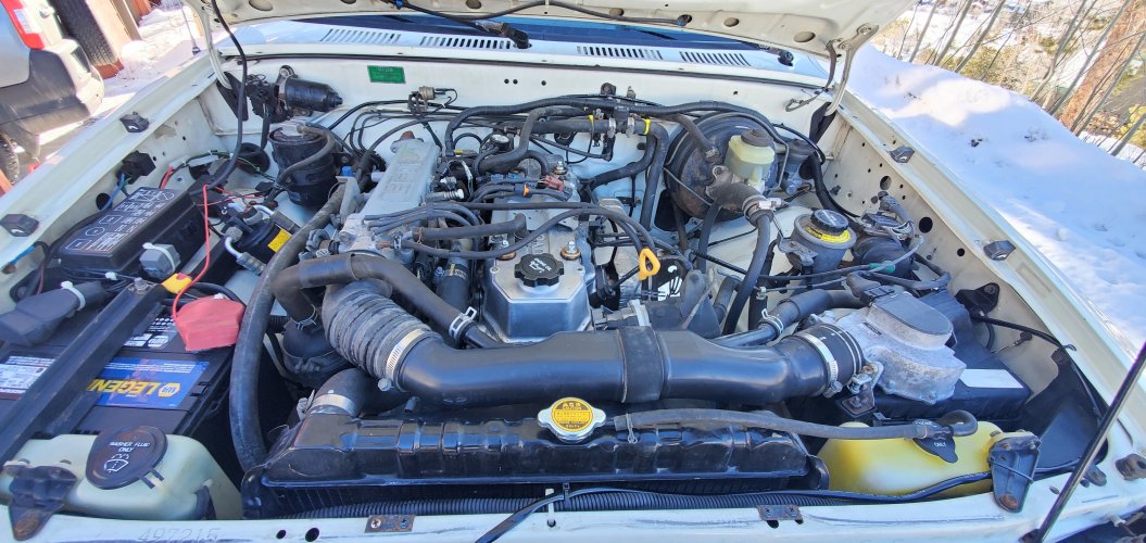

Cleaned the pickup engine bay in preparation for a tune up here soon.
I did find 3 spots of rust that will need addressing this summer.

All done, except for the wings, and bolting her down so she doesn’t fly all around the hatch area.
