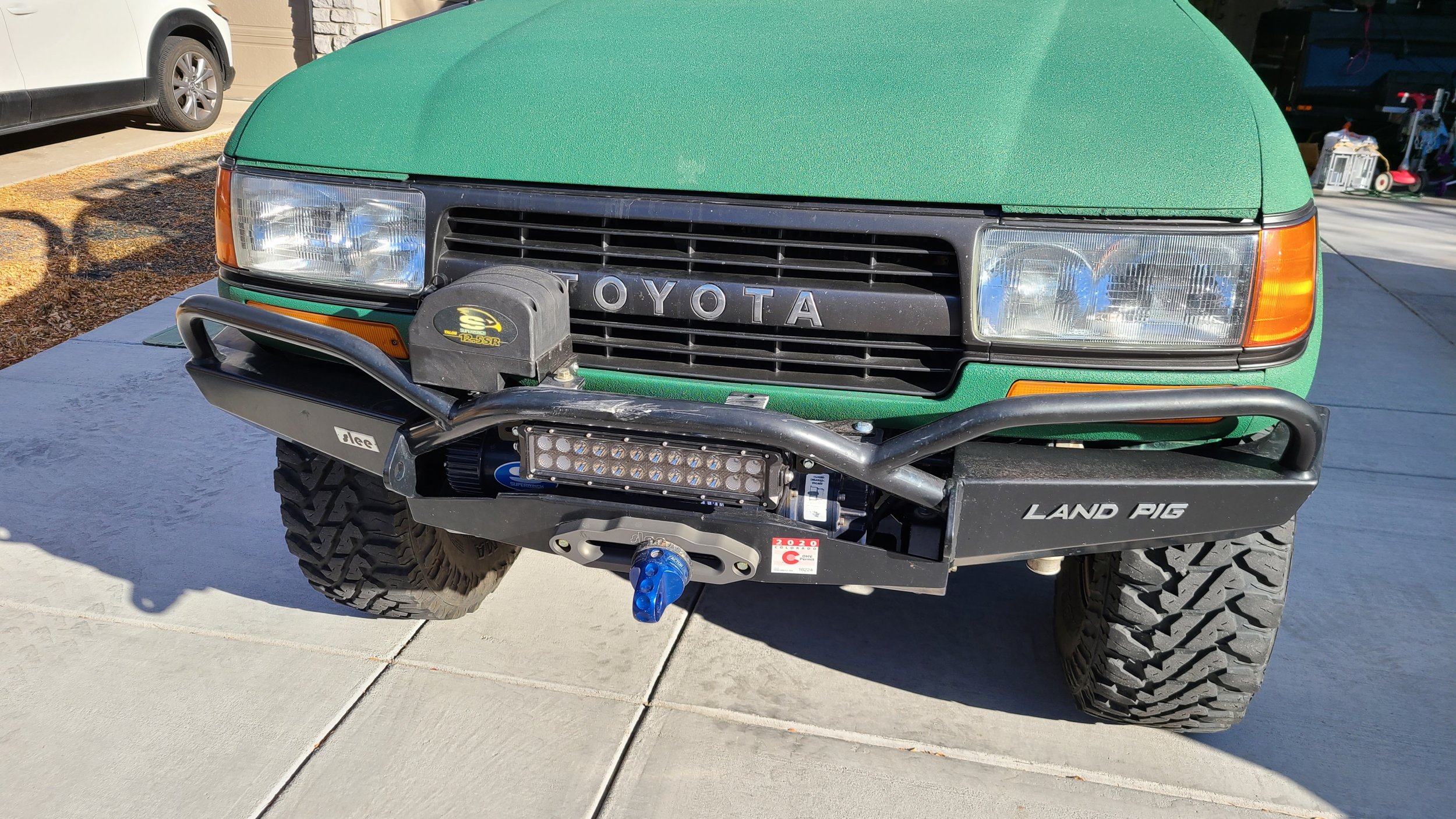

Put in a 14" 3000 lumens spot/flood combo light bar from harbor freight on the front shortbus. Used the Slee mounting bracket too.

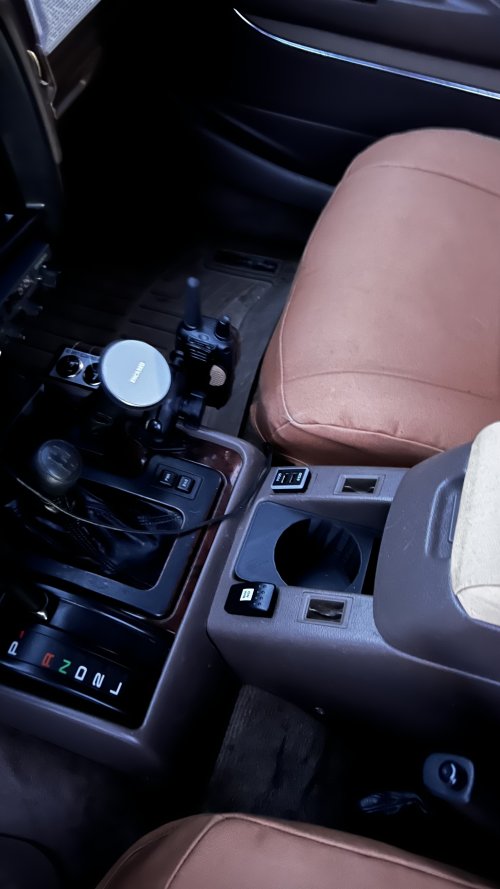

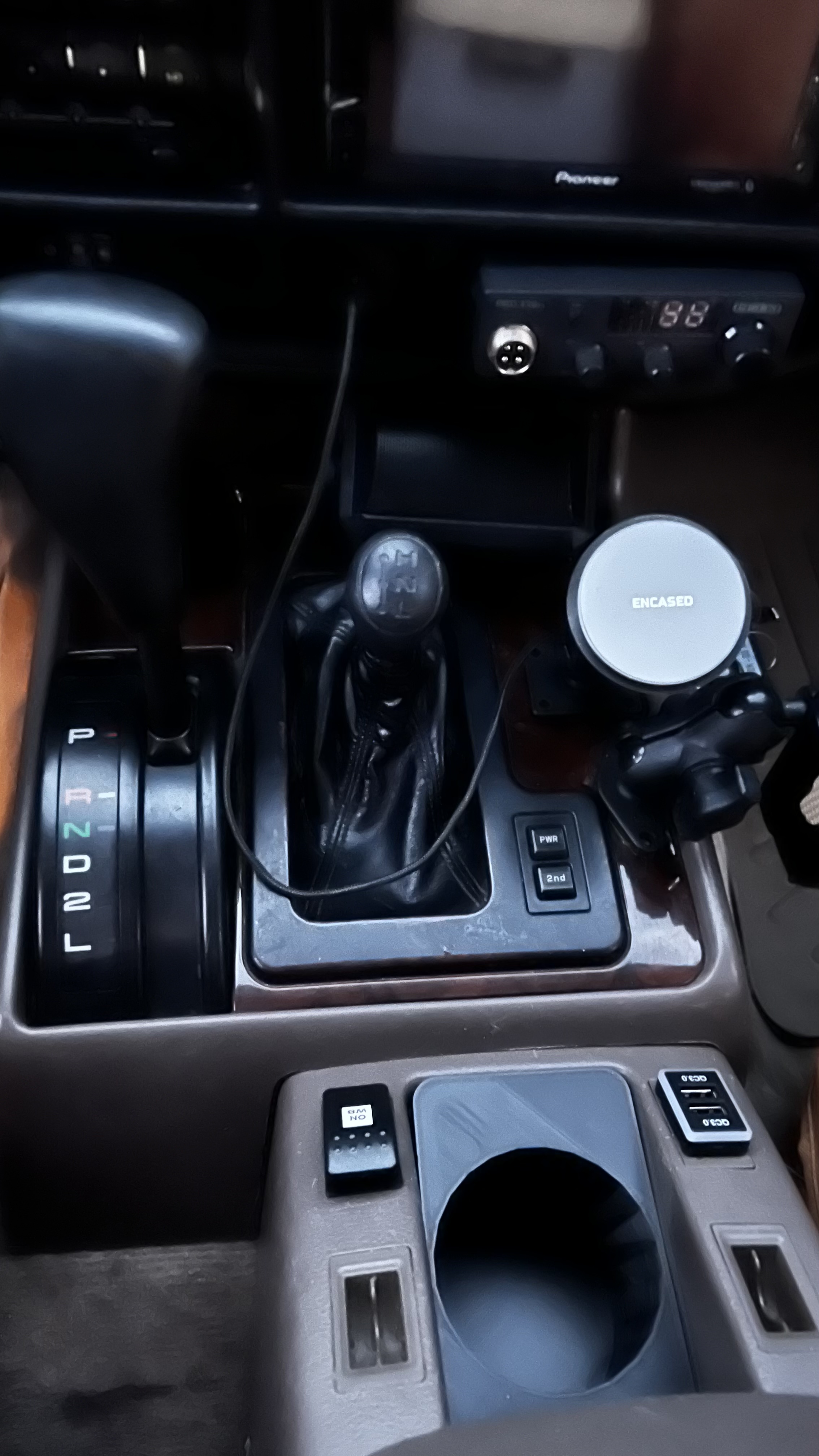

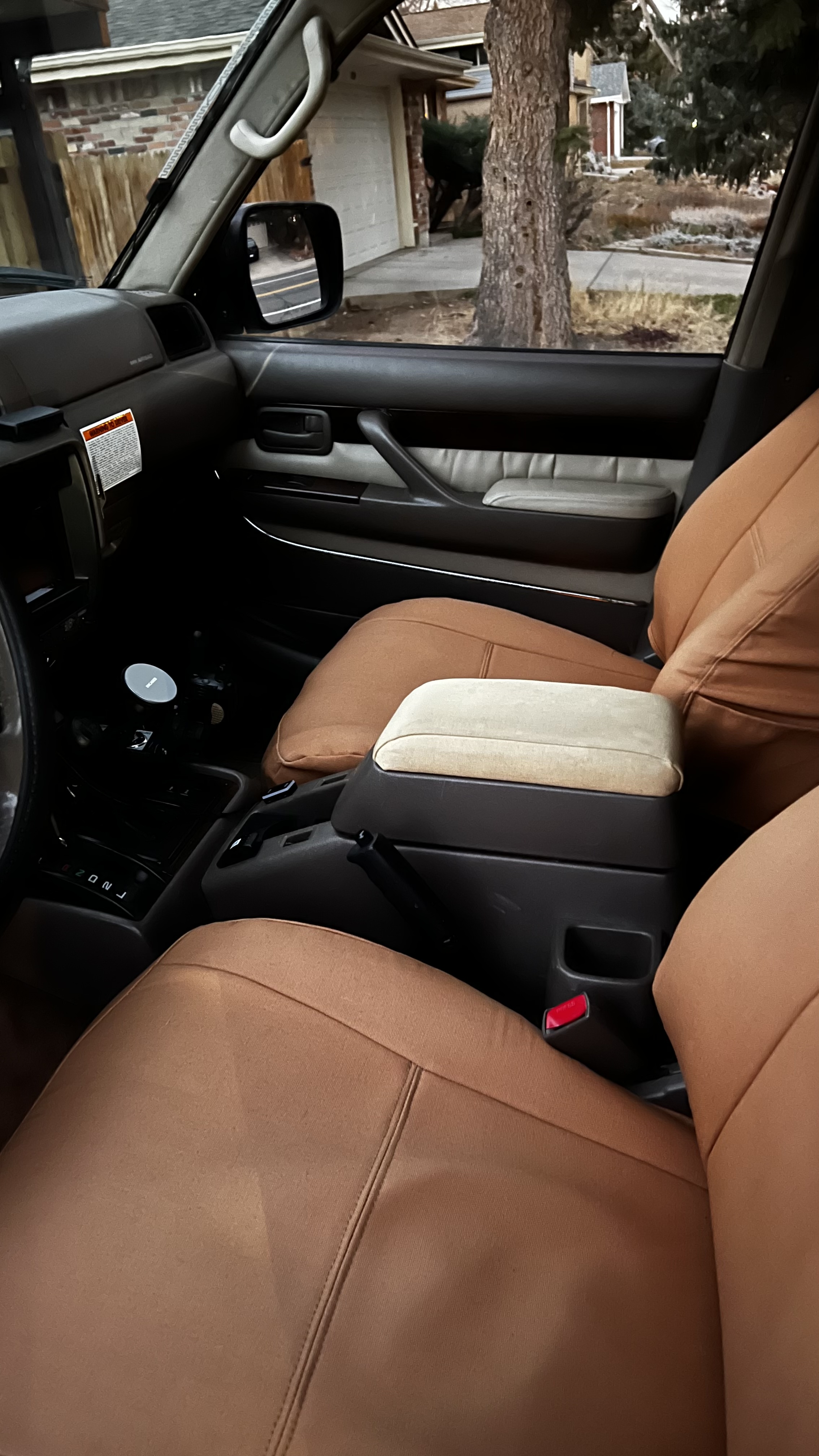

Got rid of the dumb subwoofer/cd changer/center console from the LX450 and added a LC center console, USB charger, power switch for Weboost and 3D printed cup holder.

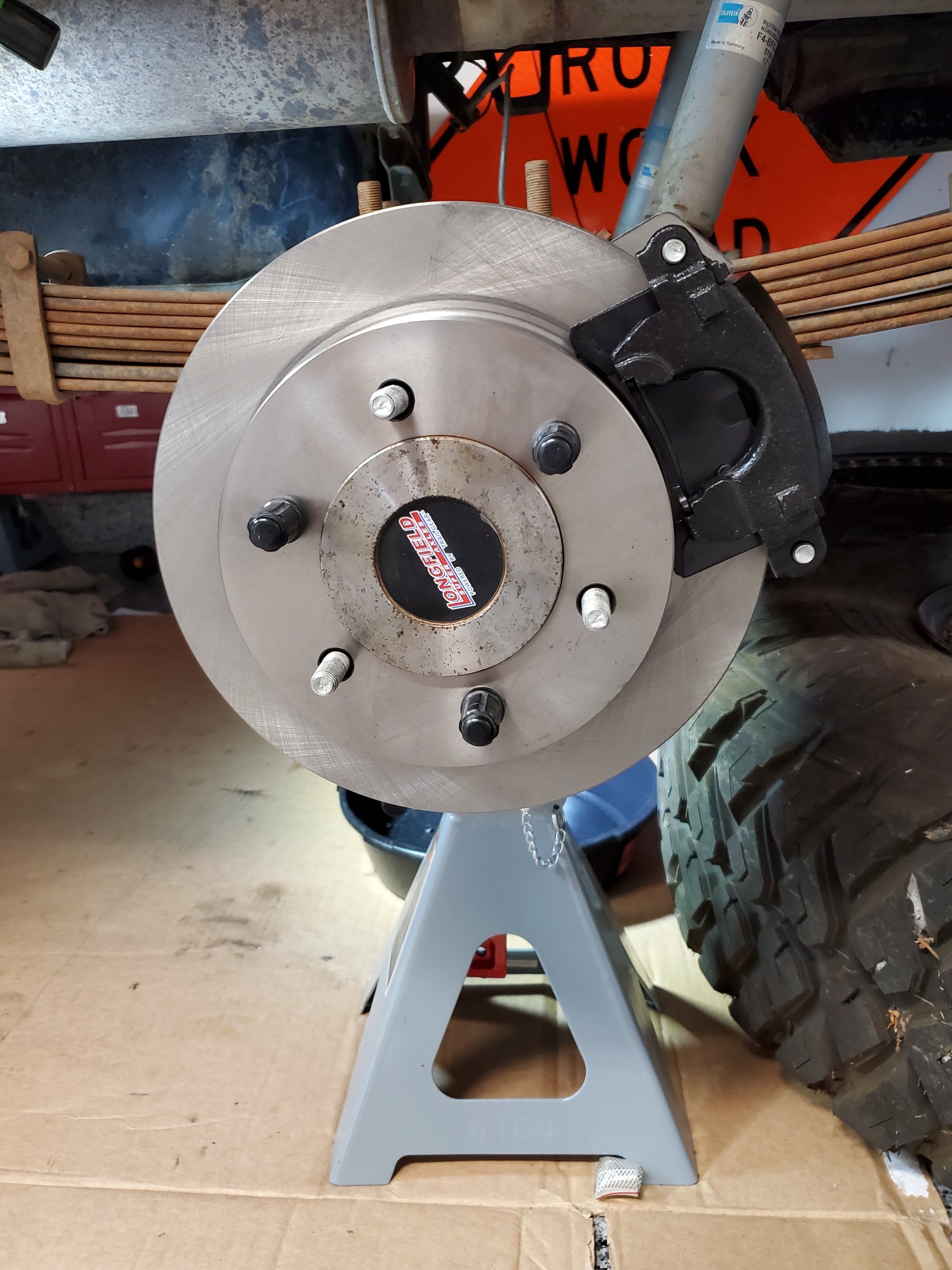

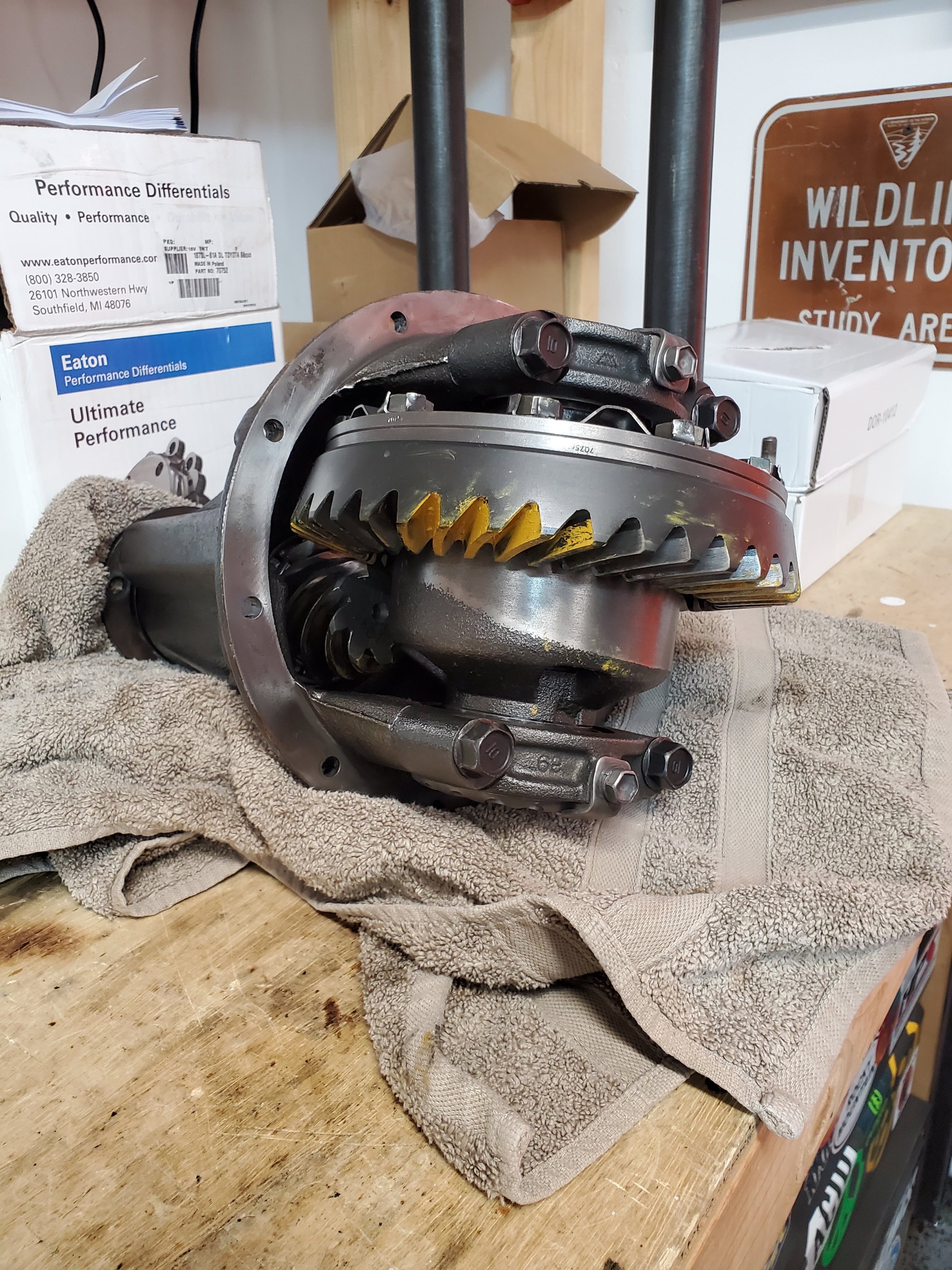

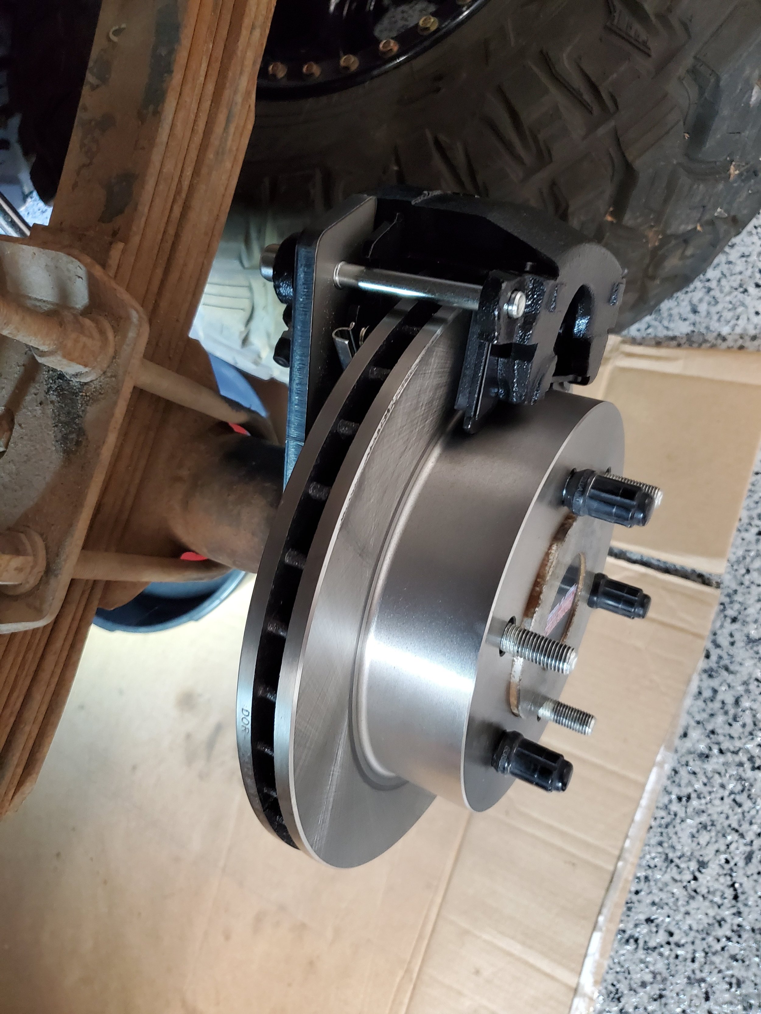

Installed the rebuilt rear third member this weekend in the first gen. Went up to 37's and smoked the main shaft in the spartan locker. The spartan was only rated to 35's so I went with a new Detroit locker instead of repairing the spartan (spartan is repairable and up for grabs if anyone wants it). I kept the same Nitro Gear 4.88's but did all new seals and bearings.
Also did the Trail Gear rear disk brake conversion kit since I had the axel torn apart. The kit was pretty straight forward. Had to have a shop press off the old backing plate from the drum brake set up though. The stopping performance is night and day to say the least!!! Will make a huge difference on the trails.

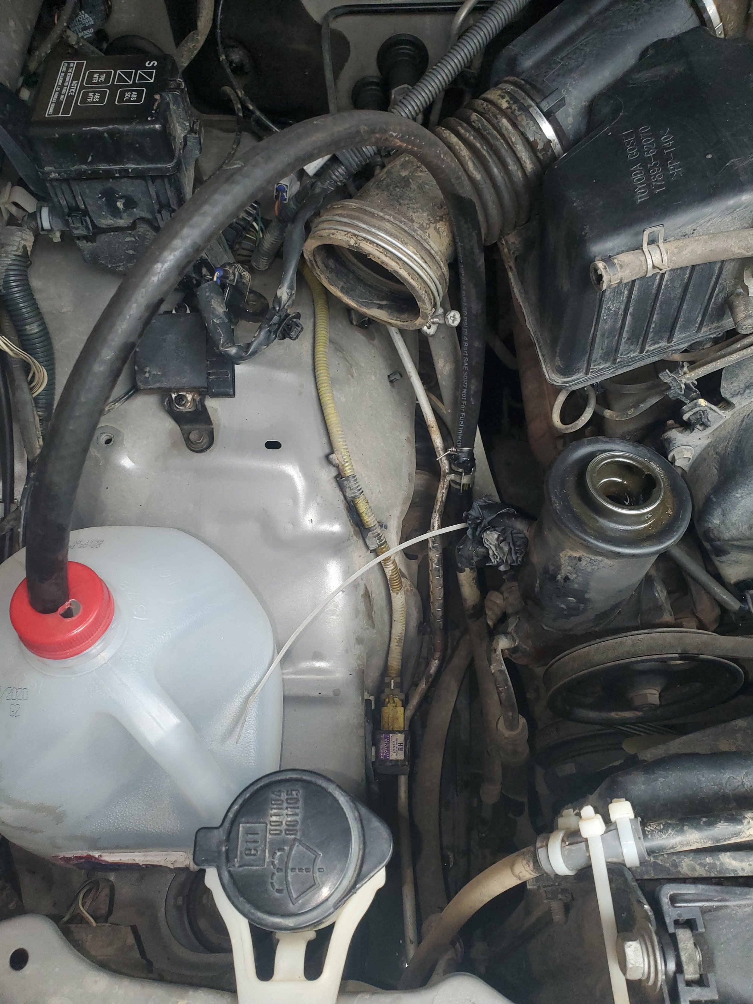

The start of something potentially messy! Power steering flush then clean the internal screen.
