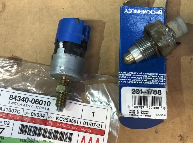

For the 80:
1) Installed new stop lamp switch (brake light and cruise control circuits). Why this matters: the 1993 with cruise control has a two circuit switch. One is for the brake lights. The other is for cruise control. The brake light part is robust. The cruise control part is a bent metal contact - lasted a mere 300,000+ miles :sneaky: (337,000 today but it started going out more than a year ago). What happens is when the metal is worn out, the cruise-control-canceling circuit is "always-on." $63 at Stevinson. Aftermarket is available but its a critical safety item so I went OEM. (84340-06010) If your 80 cruise lights up but then blinks and shuts off, this is probably why. Easy to replace once you contort under the dash.

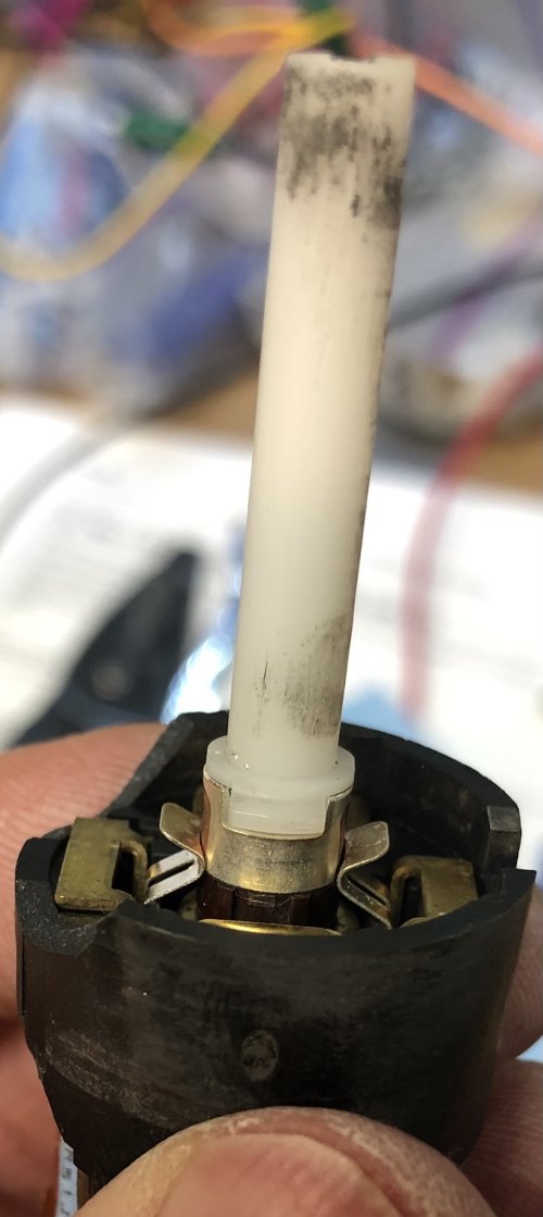

2) Center Diff Lock indicator light switch. Trouble with your CDL coming on? Does your CDL indicator light flicker or not glow bright. This is why. Beck-Arnley PN 201-1788 is a direct replacement. $15.00 at Amazon. Now its bright and crisp!
To get to it you either need a 27mm angled ratcheting box end wrench or disconnect the transmission cross-member (I loosened the driver's side and removed bolts entirely on the passenger side - use a jack stand and floor jack) to lower it about 2 inches and then I got a 27MM socket on the 1/2 breaker bar in there.

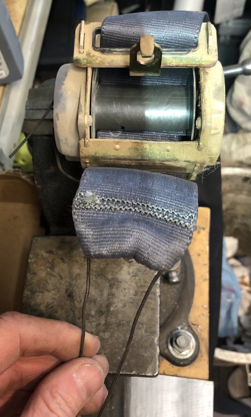

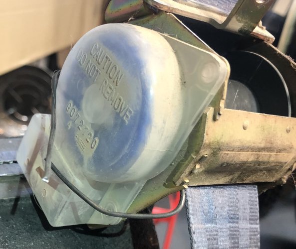

5) replaced the failing driver's seatbelt webbing. Oddly, both are for a 1993 but the good used one I had would not bolt up so I swapped the webbing. Anyone want a free drivers side seat-belt mechanism with no webbing? Will apparently fit some 80's. I used wire to keep the mechanism from spinning and another wire to help pull the loop back through. The loop is locked in place with a small plastic bar.
How is your CDL indicator switch working now? Is it engaging every time you push the dash button?
no. Still sometimes hesitates. Now more when cold than hot.

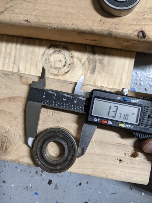

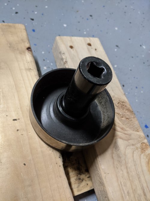

Was replacing idler and tensioner pulleys, couldn't find a tensioner from Toyota for under $50 for the pulley itself and no luck on finding an OEM bearing. Figure I'll replace the tensioner assembly (comes with pulley for like $75) when I do my timing belt in a year or two so a Dorman part will work until then. Wrong. Despite providing VIN, etc. Pulley won't fit over the tensioner due to not being the same diameter and having a different shaped hub.
Good news is the bearing calipered the same so hammered out the OEM and cheap Dorman bearing and pressed it into the OEM pulley.
Thanks to whoever decided this was compatible.
Some bearing measurements and pics if anyone is looking to find a bearing. This bearings seal on what is likely a Chinese bearing looks cheap but it's an easy replacement and will work for now.
A 22m socket worked to knock the old bearing out of the OEM pulley. A 24mm worked to knock in the new bearing.
I have narrowed my issues down to a hot/cold situation. When the truck is cold the CDL locks no problem but once I drive the truck around for 15-20 minutes and warm it up it will not lock. I am going to change out my indicator here in the next week or so. More to come. Do you change your T-case fluid regularly or use a synthetic fluid? I am just trying to narrow down all of the potential causes.

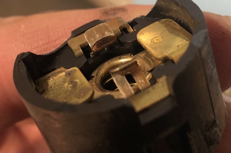

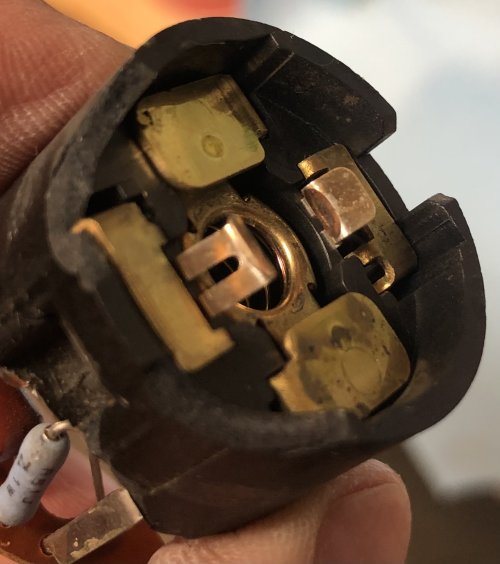

Yanked out the alternator, belts and A/C idler pulley to replace. Unfortunately due to the old age of the connectors on the alternator and wire harness above it the little retention clips broke off.
Does anyone know if those will stay plugged in or do I need to replace them?
Half the clips on mine have broken off years ago with no ill effects

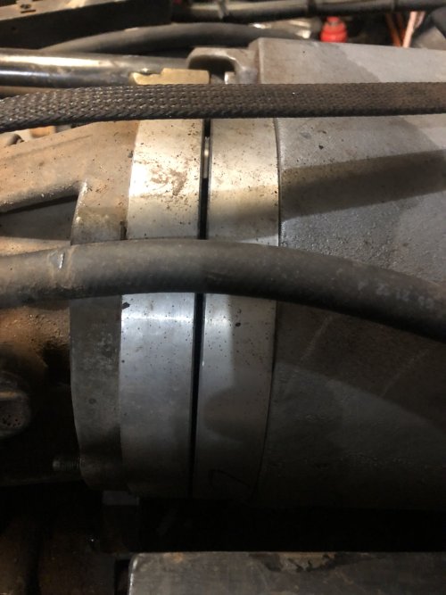

Pulled my entire interior because my transfer case decided to back off a bit and create a huge transmission leak. I’ll pull it a re-locktite it tomorrow when I have help
