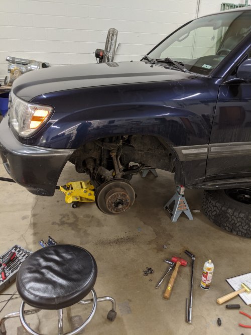

Did Rotors and Pads all around+ repack wheel bearings. Learned a lot doing this service my self and it was nice to see axle components with my own eyes and get my own hands on Em'.
I like this fish scale for wheel bearings cause the rubber piece stays at the maximum load so you don't have to guess where you measurement was on a gauge: https://www.amazon.com/dp/B0777GX5BG?ref=ppx_pop_mob_ap_share

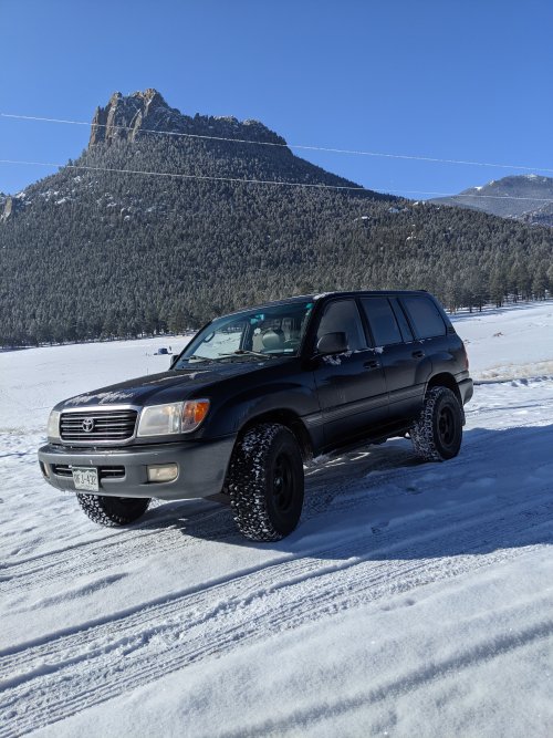

This weekend I drove it!

Looks like a nice size shop and setup!
Did you use new C-clips on the CV's, check gap was super tight on them, and grease the spindle bearings?

The shop is Jimmy and Chase🤘
I was able to do the things you mentioned. I don't remember what size the rings were but almost anything that states non reusable in FSM was replaced.
The part that was most impressive was the tolerance on hub flange to the CV splines. Literally no play! so I didn't replace the flange this go.

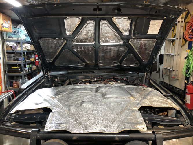

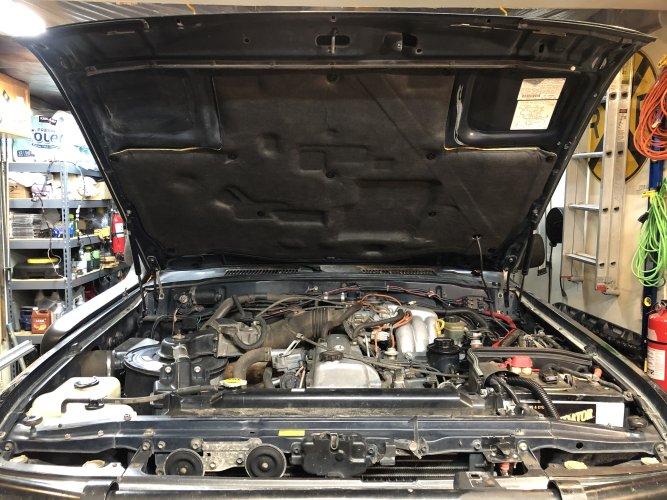

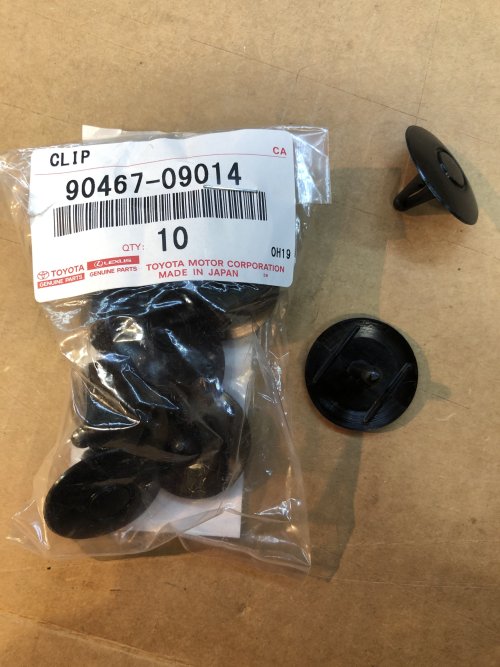

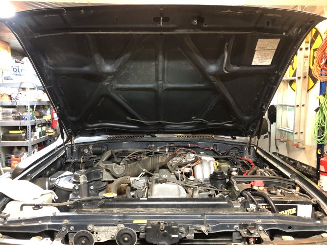

Applied adhesive heat and sound deadening material to the underside of the hood followed by the OEM hood insulator (53341-60100 - get it locally shipping is prohibitive). I'm hoping this will be better for the new hood paint and make the ride quieter. 12 clips required (90467-09014).

What heat and sound deadening material did you use @Inukshuk?
Its what Dave Schenker of Delta Vehicle Systems posted on FB that the used. I think it will work fine for me since its under an OEM liner and more than I ever had before. Its very light which is good for the hood staying up on the gas struts. My understanding is that products like dynamat are somewhat heavy. I'll bring some to show you this weekend. I have plenty extra.

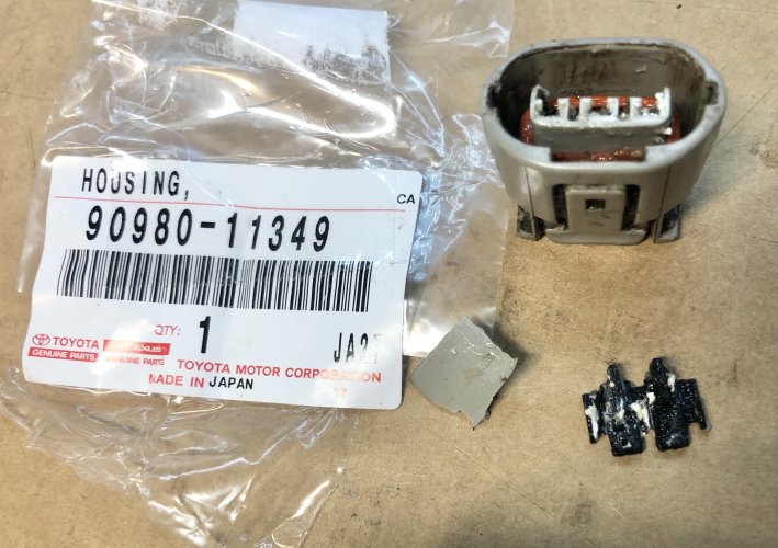

The alternator connector would not "click" back in place. de-pinned the old one (it crumbled ) and put in a new one.
