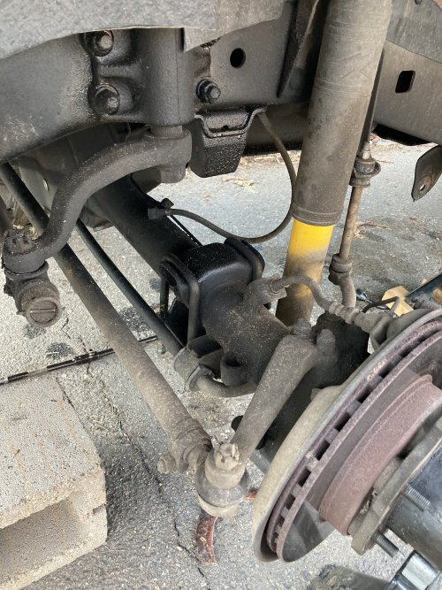

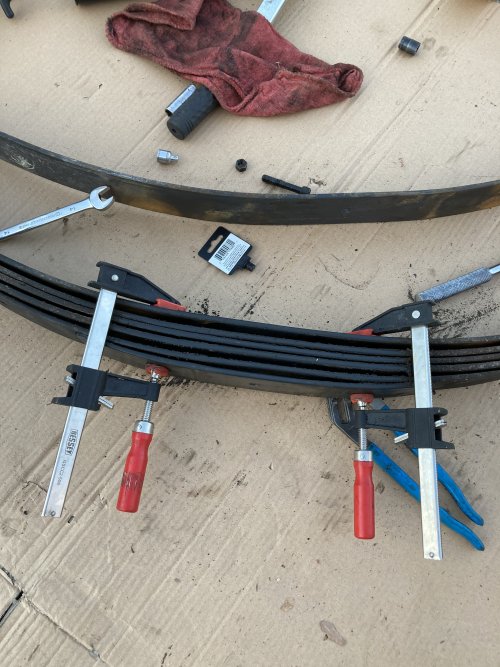

Well my front bumper and winch ended up not being heavy enough to preload the front Old Man Emu heavy springs enough. The ride in my 60 has been super stiff in the 6 months since install .... so I popped a leaf out each pack in the front yesterday. Doing the rears today (X-heavy -> heavy, pull one leaf each side). Nothing like doing a suspension install twice. Maybe I should go into business doing it 🤣
And yeah - everything is coated in oil and grease. I know. It’s my way of rust-proofing the frame!
Amazing how much quicker it is the second time though!
2,999
Oh yeah! Fucking warp speed now. It’s amazing how long it takes to cut/grind/drill/melt original suspension and bushings off, too. Took me 4 days for removal and two full days for install when I did it. I could probably do it in 1/4 the time now. It’s all those little tricks you pick up on the first time around - creative uses of a bottle Jack, ratchet straps, etc.

Did you measure any before/after for ride height? I'm curious how much lower it sits..
2,999
I didn’t..... I have a tendency to just attack projects. Probably should have measured first. The front appears down maybe 1/2” to my eyes. About to get this last corner before it gets dark and then we’ll see how the whole thing sits.
To me though even 1” extra lift with OME AAL doesn’t justify how harsh the ride is or how little the springs flex on the trails. They were STIFF before.

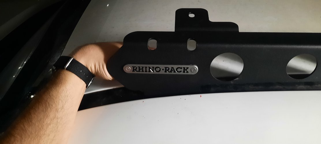

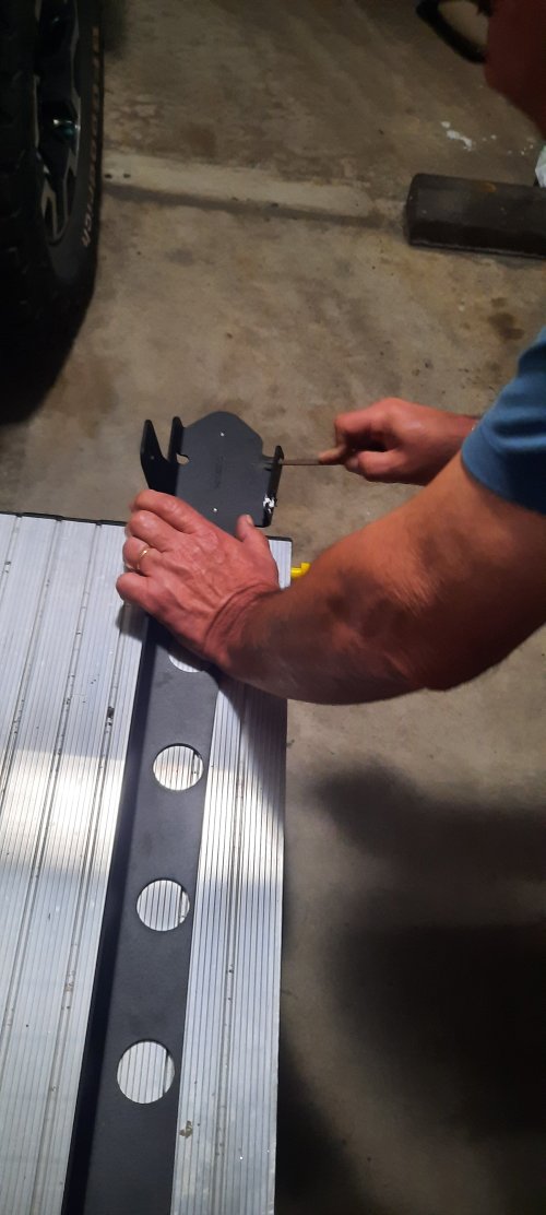

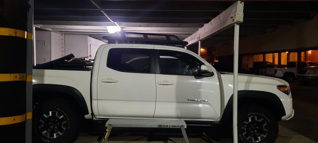

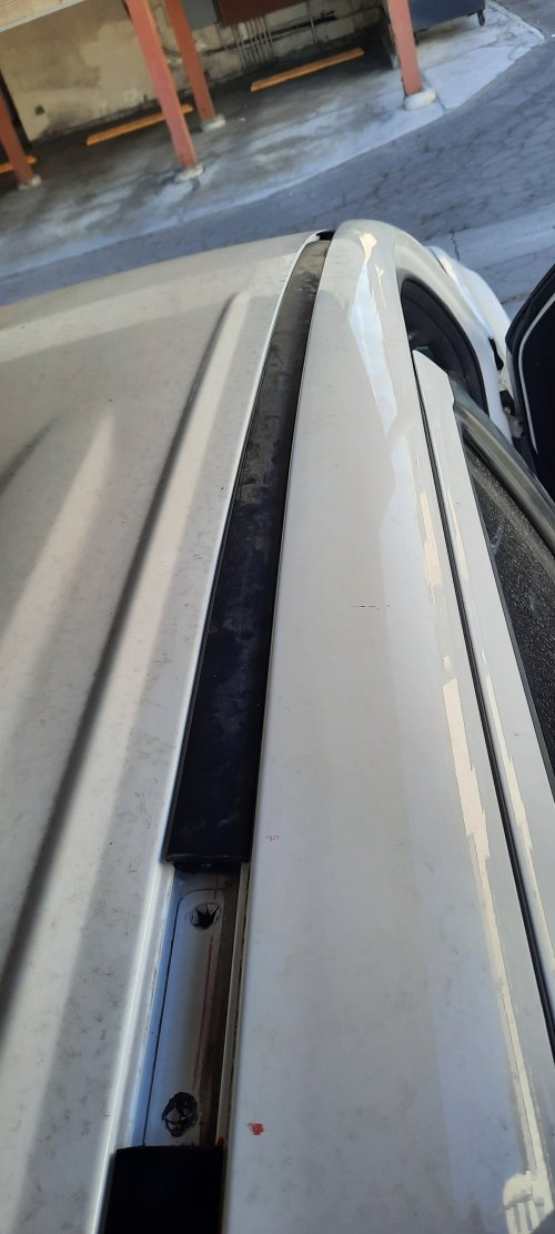

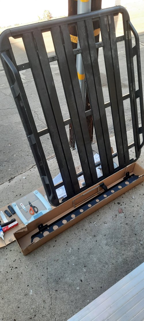

Seeing my family is the best part of the holidays! Hands down!! And got my dad's helping hands with installing a new (to me) rhino rack I bought from a friend's friend for a couple hundred bucks. Haha no pun intended.

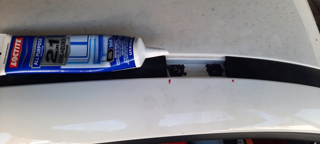

We figured out a good process to the installation. Instructions were decent. The black "sealing" washers got some silicone improvement. And only needed to file/clearance one hole on each of the two attachment brackets. Overall it'll hold together, should keep out the dihydrogen monoxide, and work for it's purpose :D I'm still deciding if I just like it or if I love it, lol.
How do you guys think it looks?? Any ideas for next year's Xmas lights or decor???
Side note if anyone would like a rhino rack, the guy from whom I bought mine has a number of other Toyota Rhino Racks on hand he'd like to sell for cheap. From the sound of it, the racks are new but the dealer where he works was tossing them because they're "old" to make room for newer versions. He saved them from the dumpster and wants to sell them. I understood he has 13 racks for 200 series land cruisers along with others. So if anyone is interested please let me know. I'll put you in contact.
Anyway hope everyone is enjoying the holiday season with friends and family :) at least it seems like folks are getting projects done! So it's gotta be pretty good.

Looks great!
Cool. Thanks Daniel!
Hmm I didn't know that about silicone. If a silicone is not meant for metal contact does it harm the metal (like it causes corrosion) or does the metal harm the silicone (like it prevents full curing)?
But yeah I think you're right, it's not silicone. It's latex based caulking. A while ago I tested this stuff on a couple nuts/bolts to confirm it seals thread and could be taken apart afterwards. Plus I've also used it in the bathroom to seal gaps on an older bathtub with aluminum guide rails for shower doors. It works decently well in my experience so far, if anyone is interested in a recommendation. It also seems to last a long time in the tube without curing. I've had this tube since about 2016 and it's still good.
Allen
8,490
Only some silicone formulations. some types are fines. Google it.

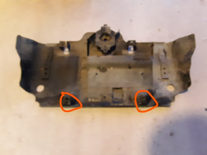

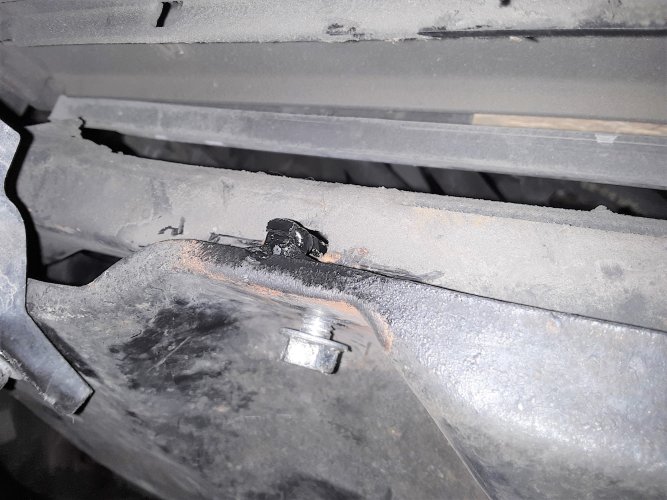

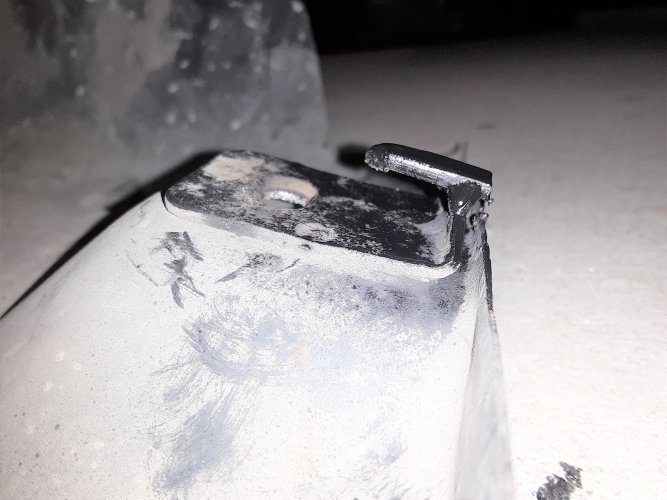

'06 GX 470. What should have been a 30 minute oil change took 2 hours, to fix the POs (Lexus servicing dealer's) idiocy.
The front metal skid plate that covers the oil filter was tweaked and one bolt was missing. I egged out the two rear bolt holes with a die grinder so that all 4 bolts could be installed - and then found that one of the rear skid plate bolt hole is stripped. 3 bolts are enough, so I let that slide.
I also noticed that someone sheared off both of the 'pins' that allow you to hang the front of the skid plate on the cross member while you install the bolts - a real arm-saver. These pins project into the front cross member. I created two new 'pins' from sheet metal, and then welded them in place. After some testing and debugging, they work well and make it much easier to install the skid plate - just like the OEM design.
The first photo shows one of the two pins I created (welded to the front lip of the skid plate), and the second photo shows the pin projecting into the cross member (as it should with the skid plate installed). I want to know why someone sheared off both pins? On a lift, it wouldn't matter, but in your driveway, they are critical. The last photo (blurry) shows the location of the pins on the skid plate.
