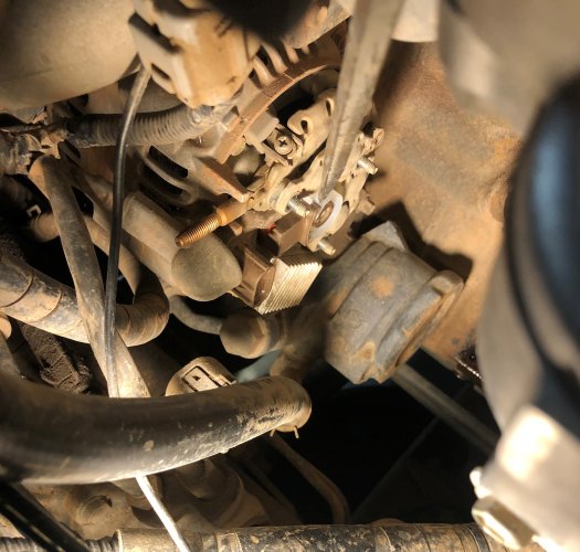

Yanked out the alternator, belts and A/C idler pulley to replace. Unfortunately due to the old age of the connectors on the alternator and wire harness above it the little retention clips broke off.
Does anyone know if those will stay plugged in or do I need to replace them?

Plug it in and give a wrap of electrical tape. Will be good for a while.
Many people (including me) have old wire harnesses to take apart for this purpose. Post up a wanted thread. Connectors are easy to "de-pin" once you get the hang of it (until that point they are frustrating as hell!
One trick with old connectors is to not "press" the lever to separate but insert a small screwdriver to lift.

Right on thanks! Yeah I'm a little worried about de-pinning the old connector. I ordered two new female ends from Stevinson today should get them next week sometime.

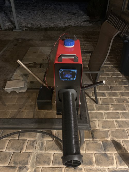

Bought one of these fan dangled Chinese Diesel Heaters. So far one of the best $130 I’ve ever spent. I hate supporting Chinese garbage, but this is an experiment to get megan in the tent with me in the winter.
Got 14hrs of on time through the cold (approx. 20deg F avg). In that 14hrs, I had 6 starts (on purpose turning on and off). I had it on 3/4 power, and burned 3/4 gallon of k1.... about 10.5hrs of burn time. All of that on a fully charged 16ah Lithium phosphate battery.
Final batt pack will be 2 16ah in parallel, so 32ah. Should be totally fine running through the night while charging any accessories.low voltage cutoff appears to be 11.2 vilts

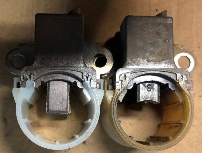

80: Replaced alternator brushes on the 80. Did not pull the alternator. This is a 1 🍌 job. These brushes have 104,000 miles on them. Still good for a while but nice peace of mind for $15 and an hour. Tip of screwdriver shows location. Pull the oil filer and remove PS reservoir bracket bolts so you can move it a little and there is plenty of access. 8MM socket is needed for the cover nuts. My connector did not break but I could not get it to click back on so it will be getting replaced.

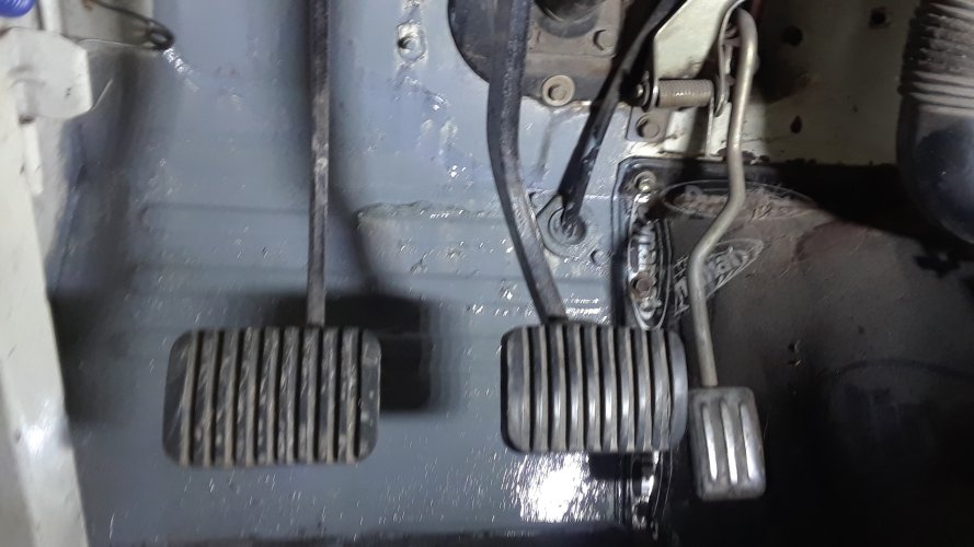

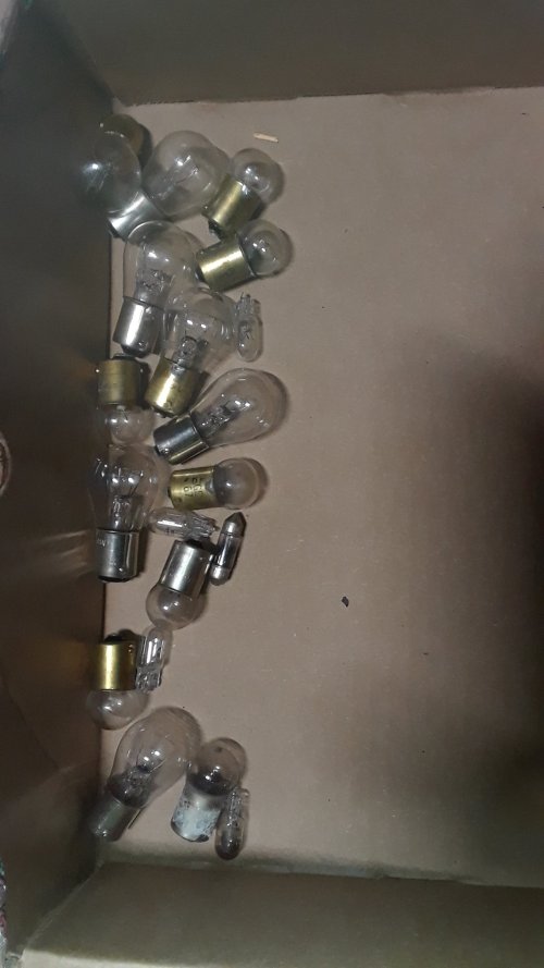

Took the day off of house construction to give the 40 some love. Replaced running and interior lights with LEDs and did the 1st coat of POR 15 on the driver side floorboard.
