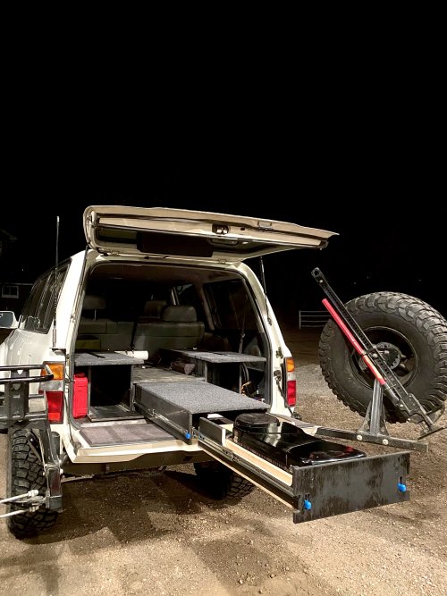

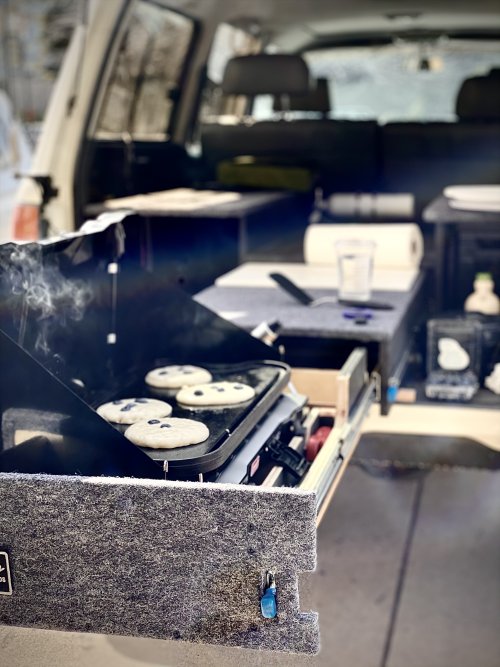

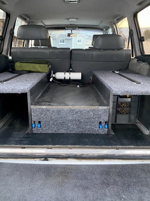

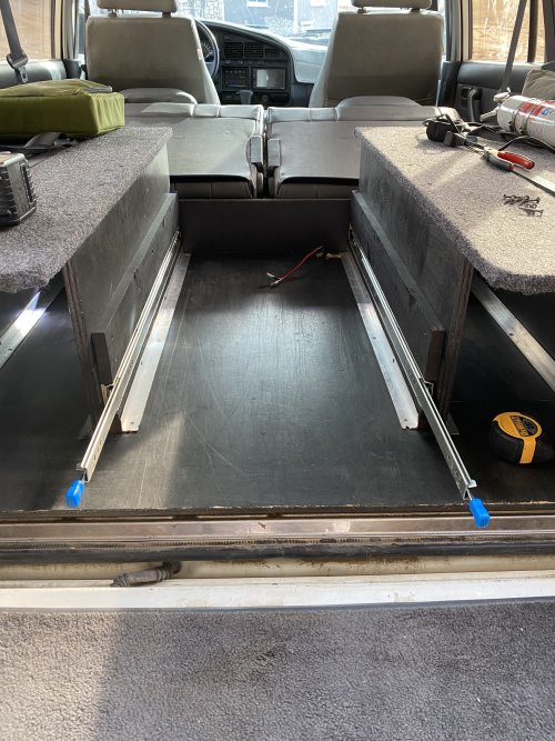

I built a pull-out kitchen in the cubby under my fridge this weekend.
It’s a double pull out with 34” 250lbs slides which is pretty strong, but at some point I might need to bump the first stage up to 500lbs slides. Once it’s all out it’s a tad wobbly (but not bad).
The first stage is a carpeted work surface and the second stage is a drawer that fits a stove, fuel, griddle, cutting board, pots, pans and utensils.
This morning I made 4 beautiful flapjacks on it. But then it got too hot and all the rest were black and crunchy with melted spatula mixed in. I almost felt bad giving them to the fellas at work.
The drawer worked great though! We’re excited to finally have a quick tear-down cooking set-up!
Very nice and creative. I have never seen a center setup like that. Addresses a lot of issues, My backsetas are usually out and my fridge in the backseat area. I have been wanting to re-do my drawers and include a kitchen and most everyone does two drawers. I see many ways this three compartment system can suit what we do. Thanks!

Thanks man. The center fridge system is working really well. The original idea is that the two side cubbies hold two 10" bins on each side that carry recovery, tools and fluids can be quickly swapped to a different truck without unloading drawers. The the shelves above hold a "camp" bin and a "kitchen" bin.

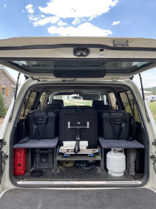

After using it that way all summer we decided we could probably scale the kitchen back a little if it meant we could make a pull-out chuck wagon drawer. Something that could set-up or tear-down a lot faster than packing a bin. Attached is a picture of what the setup looked like before the drawer.
If we didn't need the second row seats then I def think your set-up would be ideal with the fridge lower down in front of the shelves. Then the center drawer could grow up to make a single level platform and hold more kitchen stuff. Either way I recommend this configuration 100% 🙌
