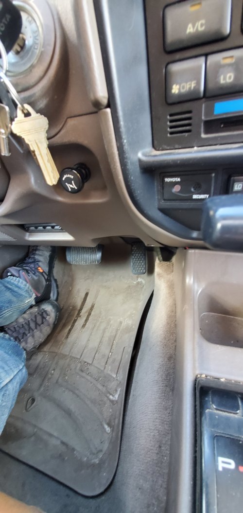

Replaced my throttle cable and added a hand throttle as long as I was in there.
Pleasantly surprised how much better the throttle response is.
sweet! what are the PN's for the hand throttle? I guess I can look it up.
KC Masterpiece
May 4, 2019
2,060
I got mine from delta a while back when ordering other parts. Complete OEM kit.
Unfortunately already tossed the bags out so I don't have the PN.
I think some years need to add a bracket to the cable for the pedal. It was already there for my 97.

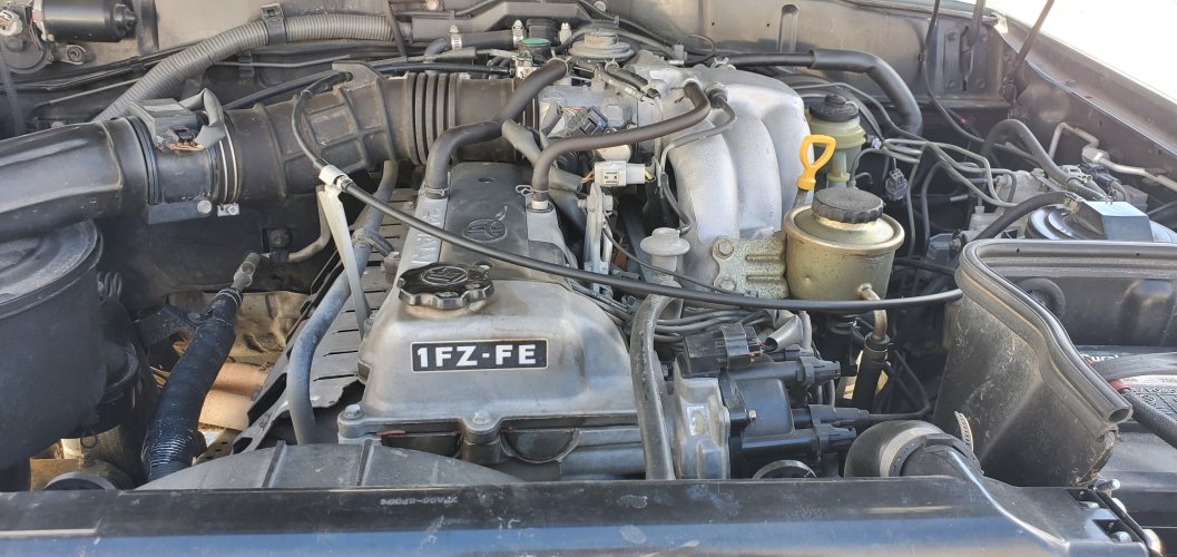

Low idle / vibration at idle /mild surging...gone gone gone!
Cleaned throttle body - that brought idle up from 650 to around 700. Still a tiny bit rough but no current or pending codes.
Thought it was an injector but decided to take a spare Denso Coil Pack that I know is genuine/new and started pulling the older coils and trying the new one in place. Idle smoothed even more when I dropped it into #5. I have three original coils left, so I ordered replacements for them. I put new rubber on them about 20k ago, but am noticing that the last three originals are starting to show very mild cracking and felt much hotter than the other coils when I removed them.
It's early but I put new spark plugs in. The old ones were at around 55k. I compared them against the new plugs and everything looked good, but to be honest counterfeit products have gotten so good that my old plugs are in question (the new ones came straight from Denso and I noticed some differences in the old plugs).
Those plugs smoothed out the rest of the stumble, idle buzz is gone, idle is up to 750ish and stable.
Pulling the thread further though I now have isolated a very mild whine noise to the original alternator, and will probably want to replace my tensioner assembly at the same time.
