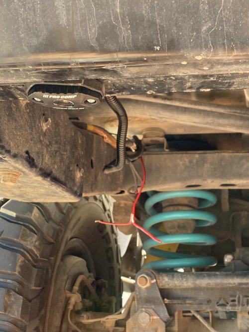

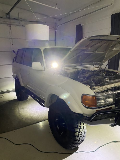

Up late tonight getting the final touches on before we head out to Kokopelli!
Rock lights & ditch lights done!
... I’m gonna go lay down...

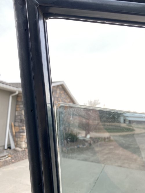

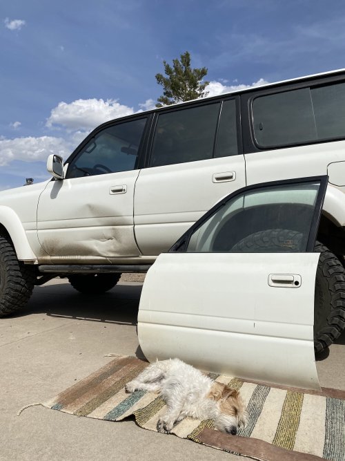

Swapped the driver door today. I liked the dent but I like not-dent better.
Along with the Mirror, Lock Core, Speaker, Latch, Interior Panel and Glass I also had to swap over the Wire Harness (door is a '97 and the harness plugs didn't match my '93).
It all looks good but one thing I cant quite get right is that the that the glass doesn't ride snug in the tracks. On the back edge of the window frame the edge of the glass comes out of the channel just a little bit when I roll it up. I can also wiggle it back and forth when it's mid-way up. The '97 glass that was in it did the same thing and now it does that with the original '93 glass after I moved it over. My best thought is that the rollers on the regulator have wear/play (I'm using the '97 regulator that came with the door). Any other thoughts on how to snug that up? Is there a bumper or clip inside the track that I might have knocked loose and don't know about?
