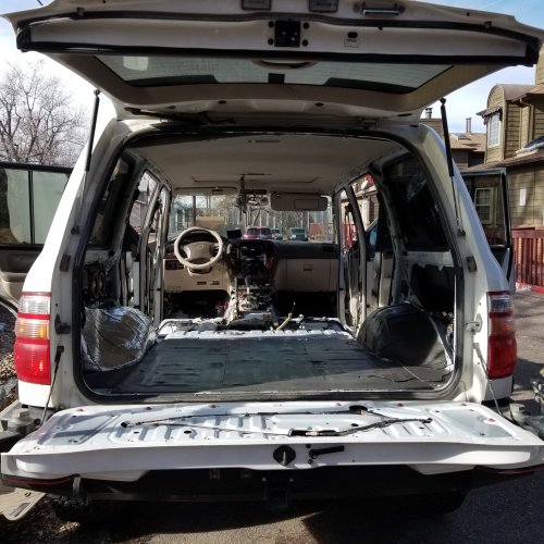

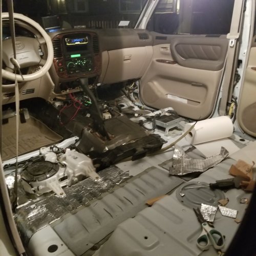

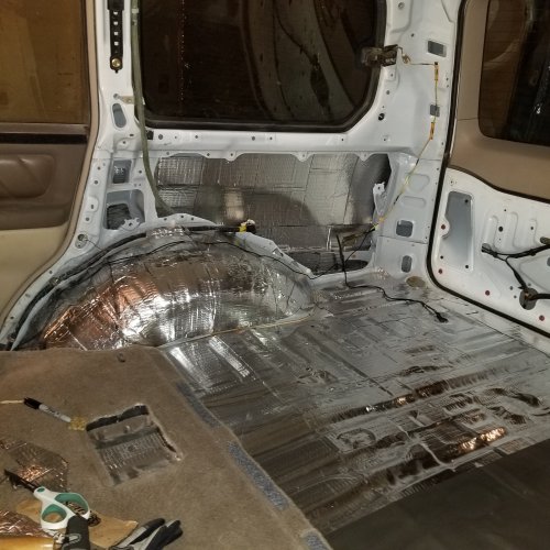

Pulled out everything down to the metal for some cleaning and sound deaded (butyl) + insulated (ccf) the bottom. Still got the doors + ceiling to hit

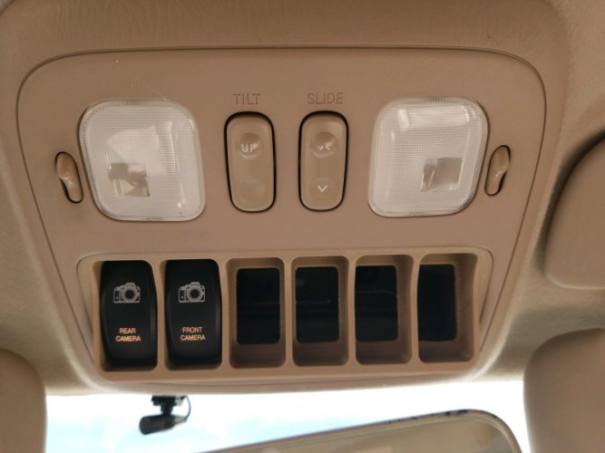

Installed a rocker switch panel from a guy on MUD and fuse block as well. I originally grounded the fuse block to the factory amp ground under the passenger seat and it immediately killed the battery when I tried starting the car, so I rewired to the battery ground in the engine bay and all is good. Now I just need some more accessories for the switch panel. And to drill a bigger hole in the firewall since the two 10G wires don't fit

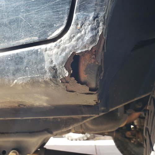

Finally getting my patch fit and holding on for more clear weather!
Lots of trimming before I can weld but it's getting there.

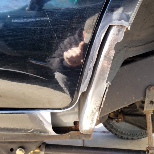

Progress... I think this may come out alright.
Plenty more grinding then a little bondo at the door jam, sealant at the wheel well, and some quick paint should do it.
