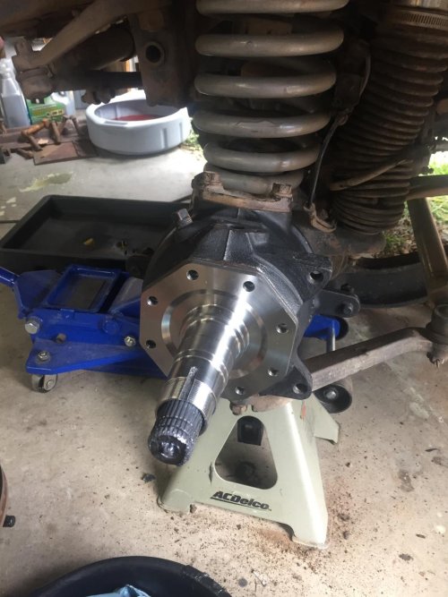

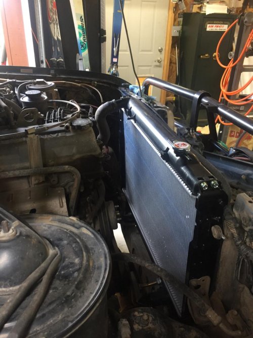

Lately I feel like all I do is work on the old gal. So far this week a new radiator went in and a left steering knuckle rebuild with all new bearings/seals/spindle

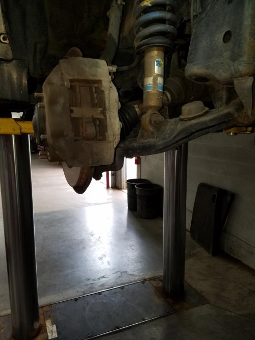

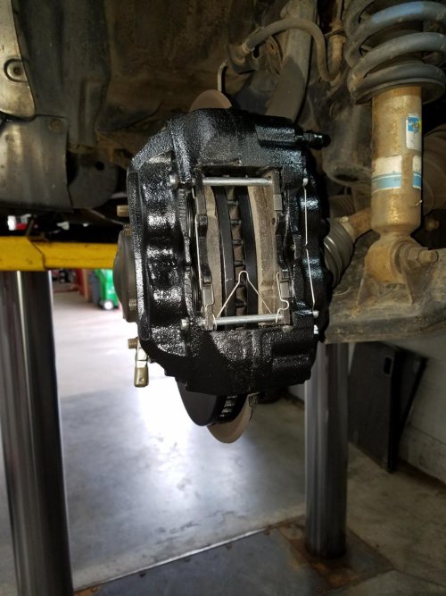

Installed tundra 199 brakes on my 4runner. Rotors are like twice as thick. Hopefully no more rotor warping.

Nice! One of my favorite all time mods... how is the stopping? When I did this on my Taco years ago I almost went over the handle bars.

Love my 231's. Night and day difference.

It feels like it stops the same but without brake pulsation. I think the 199s are the same as the stock calipers but just wider to allow for the wider tundra rotors. If I had big bumpers and roof top tent and stuff I would have gotten the 231s which have significantly larger pads which Im guessing you got for your taco.

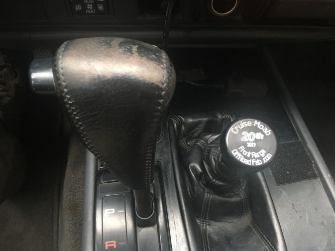

New shift knob
Replaced the shift knob, and put a super fresh lx450 seat cover and foam on my 80 seat.
