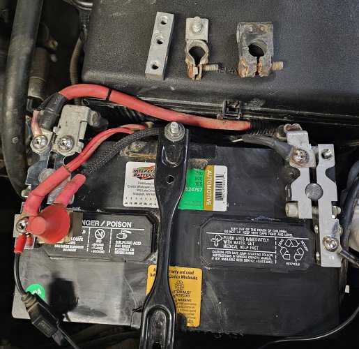

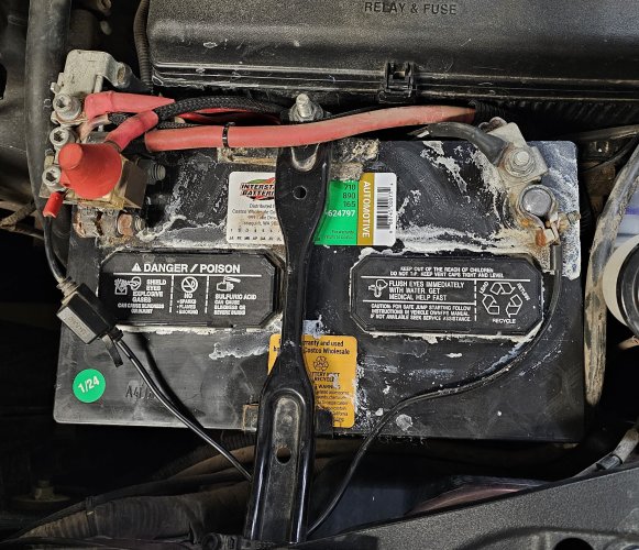

Replaced my nasty, old and problematic start battery terminals with new ones. First item completed on the CM prep list!

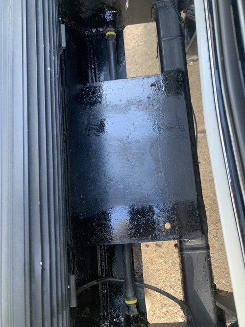

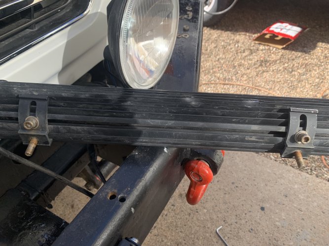

Well, new WARN winch installed, them floating square nuts drove me bonkers for a bit and it took me a bit longer than anticipated as result.
