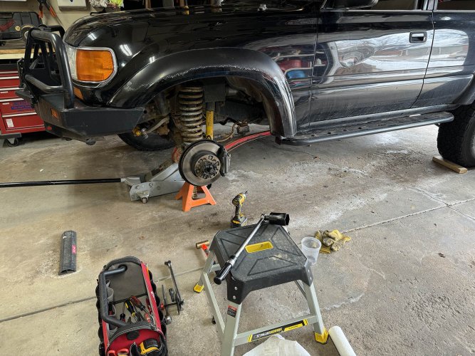

Retorqued the front wheel bearings today in advance of Cruise Moab. You might say I had my own private Wheel Bearing Packing Party, which used to be an annual RS event back when most members had FJ40s and 60s.
Pro tip 1: you don't need to remove the brake calipers to retorque wheel bearings.
Pro tip 2: make sure you have the C-clip on the axle shaft before putting the cone washers, flat washers, and nuts on the drive flange and tightening it all up. Otherwise you will have to take everything apart a second time to get the axle shaft pulled out enough to get the C-clip on there.
Side note: my very first event with the Rising Sun was in 2000 at the Wheel Bearing Packing Party at The Toy Doctor in Littleton. I remember meeting @Cheeseman and @arthog. I think it was @arthog's first RS event too, but he was a far more experienced wheeler than me. I was in awe of his FJ55 (and still am).
I'm hoping the wheel bearing re-torquing will solve my downhill braking shudder. I have already replaced most of the front end parts.

Wait, what?
Pro tip 1: true, but if you plan to use any kind scale to measure preload, you gotta get the brake out of the equation. But if you're just bumping it 1/4 turn turn then slapping it back on the ground, yes.
Pro top 2: Did you try inserting an M8 bolt into the end of the shaft, then pulling it out? And actually I'm trying to vision just how you'd put the C-clip on any time but last... unless you're slipping the drive flange over it prior to even sliding the axle back in. But if you're just tightening the bearing then you didn't even take the spindle off. :confused:

Call me crazy, but I always set preload by feel.
Its like when Amber asks me how I know when a steak is done. "You just know".
100% on pro tip 2. Even then I still swear a bit every time I deal with those damn c clips.
