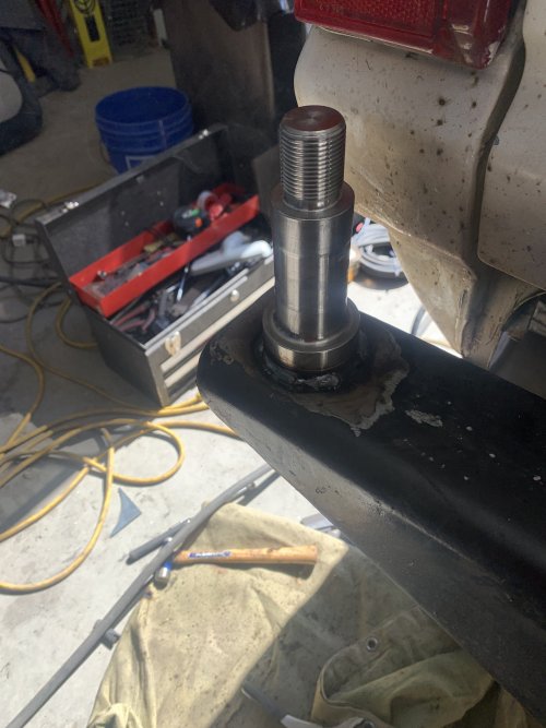

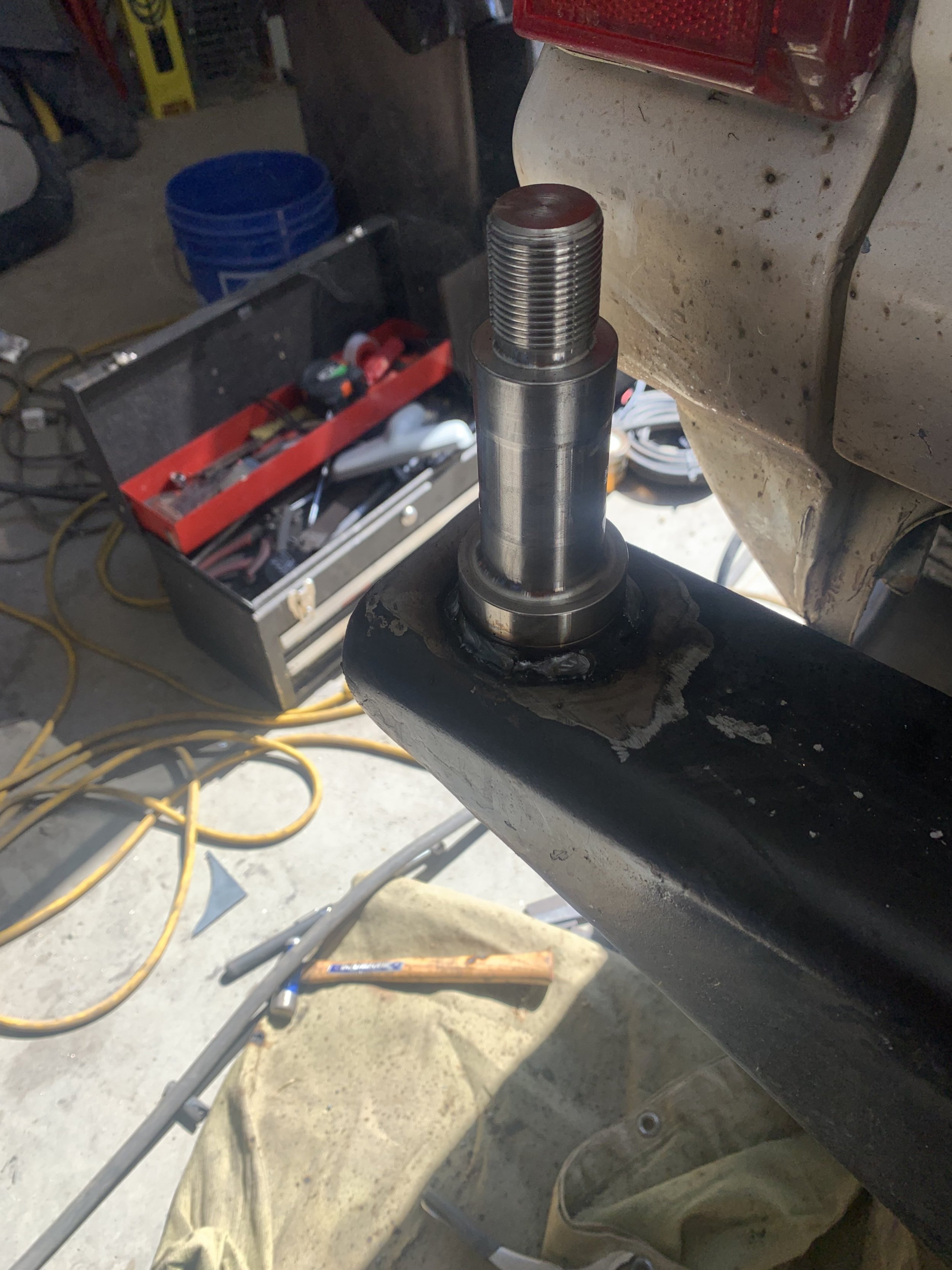

Tire carrier folded over while doing Poughkeepsie wall (well shirt). Got the remnants back home and fixed. Thanks to many helpful and kind people. A TMR spindle should last me a while I suppose!
Many thanks to all and especially @PhatFJ
