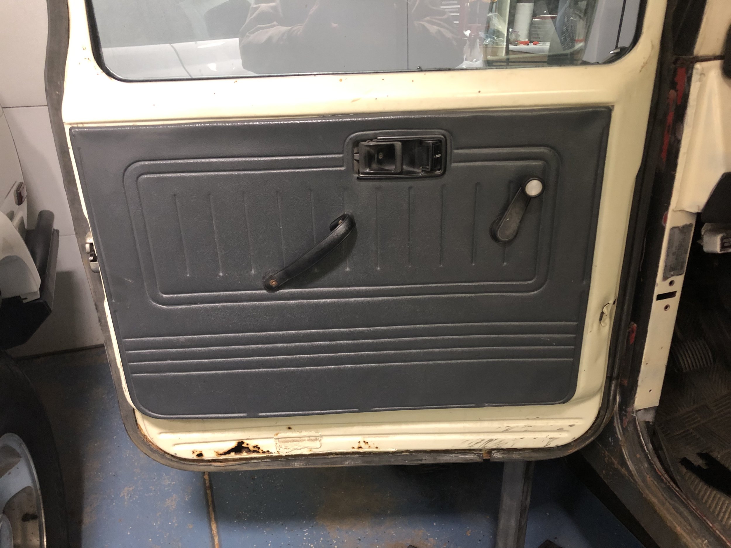

Sometimes it’s the small things. Since I had the doors apart I decided to add back the plastic barrier. My FJ40 has never had it. My driver door has a pretty good draft coming in as I drive especially since the bottom half of the door is starting to rust away. Got some 4 mil plastic from Home Depot and some butyl tape off of Amazon and here we go. Will see how it works. Probably won’t notice any difference.

On that plastic behind the door card, my recollection is that is what the factory uses. I boogered mine up when I put 6x9 speakers in the doors, then when I got rid of them I put wood paneling where the cards were. I can't remember off the top of my head what my plan was going to be for my 76 when I got to that point, I think somebody (CCoT maybe?) makes repro cards.

Got the driver door done tonight. I had forgotten that someone had done a repair on this door before which also included a lot of spray foam. Got a bunch of it out but more will need to come. Some day. Yeah my door is starting to need some work. I think this will be about it for now. I still have some leaks and stuff to fix - maybe later. I want to drive it right now.

Kims dads welded in new metal on the door in the mid 90s. Didn't remember the spray foam though

Hey Ige! It looked like a nice job. Honestly I never even knew until just now because now it’s starting to rust and the seam is starting to show. I think I’m going to get back in there and clean it out more, cut out the rot, protect the metal, and give it some paint to keep it from getting worse. Not sure yet what my long term solution should be. A welder is on the list for the garage shop.
