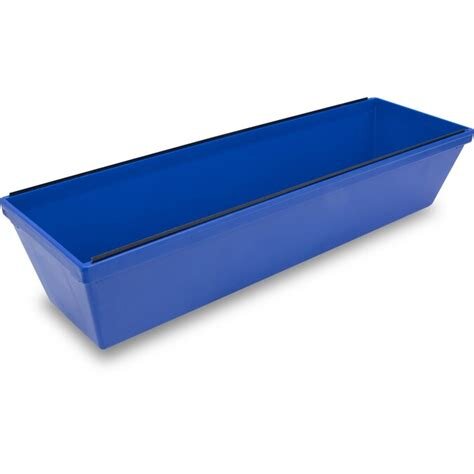

I dunno what the dimension of your box are but I wonder if a drywall mud pan might drop in the slot to contain the tire chain slush.
That cubby is about 7”x8”x19.5”…
