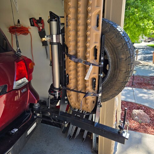

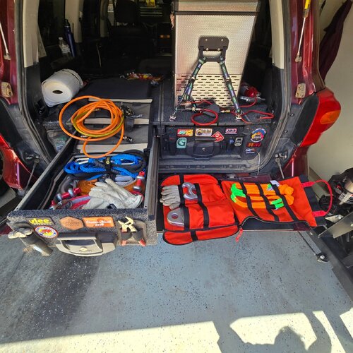

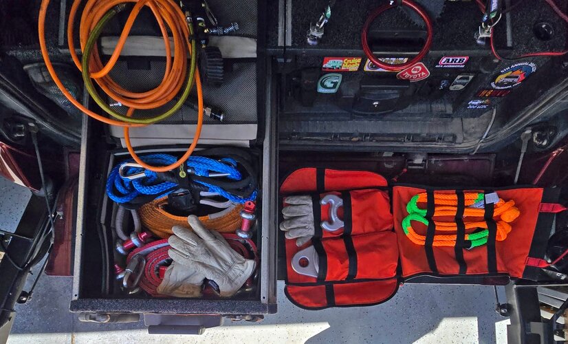

Better pictures of my gear setup. The winch extension fits nicely on top of the ARB Snatch Strap
ARB Snatch Strap (Orange) and ASR Tree Saver (Red). The air hose and Inflater fit on top nicely. Shovel and axe to left of straps(can't see)
Maxx Tracks and Off Road Jack on back

Paul,
I wasn't complaining. I can zip it with the extension inside. It just fits better out of the bag next to my recovery strap in my storage drawer. I wasn't really planning on having the winch extension in the bag since it is large.
The bag is perfect. I was just calrifying the picture and showing all the toys I got yesterday
It is very well made and very happy with the purchase
Hey Ken,
I didn't take it that way, I just wanted you to be satisfied with your gear.
Please lmk if you have any questions, comments or suggests!
I appreciate it.

Curious what you have in those small side pockets in the picture
8,697
Can we play: Guess What's In Paul's Pockets"? LOL
Hitch pin right? Unmentionable on right? LOL (or a Safe-Xtract Winch Line Lock, which may be NLA?)
10,792
Centennial, Colorado
8,697
In what situation would you use that vs the X Lock?
If I have an x-lock and there is nothing in the rigging that would prevent its use, I'd use the x-lock.
Daisy chain shortening is s time-proven technique. Bill Burke is famous for doing it with a rolled up magazine, specifically Overland Journal. IYKYK
The earlier nylon lock was actually stressed till failure in testing. Hence the aluminum model.
It's another tool. Another skill and option.

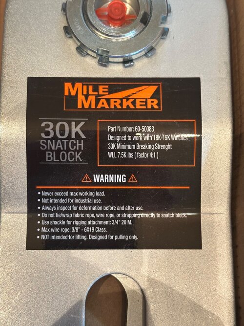

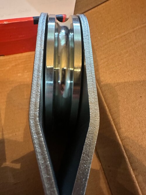

Sheave size (the wheel) is an important factor. I grabbed a nice 30,000 lb Master Pull for $50 at KOH only to later discover the sheave will only work with 3/8 wire. Synthetic needs a groove at least as deep as the entire diameter. Wire is ok with a radius deep groove.
Daniel, can you expand a little on this. Masterpull says not to use wire rope but only synthetic rope with their snatch blocks. So are you saying they have a design flaw with their product or did you pick up an older/outdated version?
8,697
Masterpull makes a ton of products. This happens to be a pulley block for wire rope.
10,453
So the one you bought was not the same as this? https://www.masterpull.com/snatch-block-sbo30000-12/
Just want to confirm as I do plan to buy the Masterpull unit when I feel flush with new recovery gear funds. I did not know the diameter/radius thing with respect to wire verse synthetic. My existing snatch block is technically not the correct spec for my 3/8” synthetic rope. Obviously it’s worked without failure to date but more motivated to replace it now.
8,697
Sheave size (the wheel) is an important factor. I grabbed a nice 30,000 lb Master Pull MileMarker for $50 at KOH only to later discover the sheave will only work with 3/8 wire. Synthetic needs a groove at least as deep as the entire diameter. Wire is ok with a radius deep groove.
1) Turns out mine is MileMarker. Also a decent company. I'll edit my post.
2) Mine is the PN 60-50083, WLL 7.5k lbs, 30K Minimum Breaking Strenght (typo in original) (Some other websites use that same part number advertised as a 20k lb pulley block)

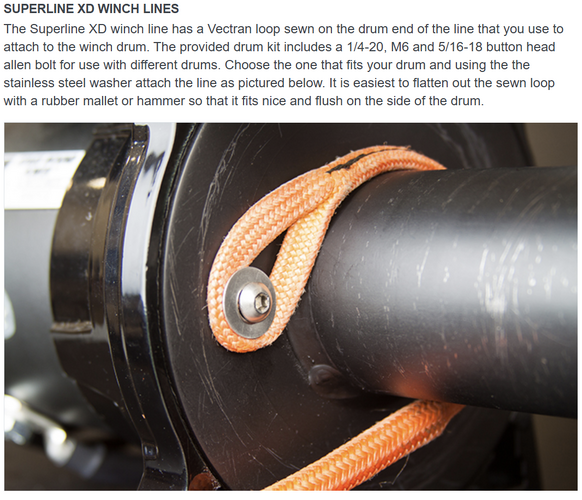

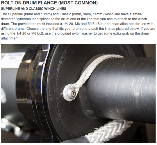

My winch looks like this:
It's looking like I just need to make a tiny loop in one end? With no metal part... not sure how I'm over thinking this. Here's another example:
both from https://www.masterpull.com/how-to-install-a-synthetic-winch-line/

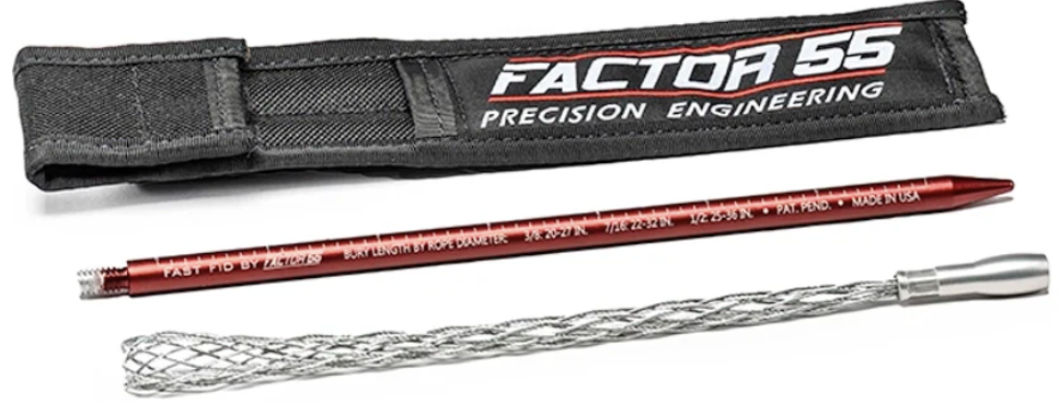

so is it as simple as making a little loop using the pokey thing? this is the one I have:
