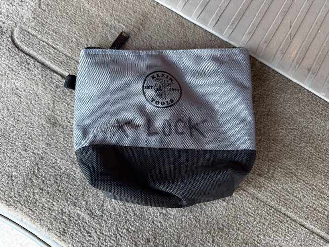

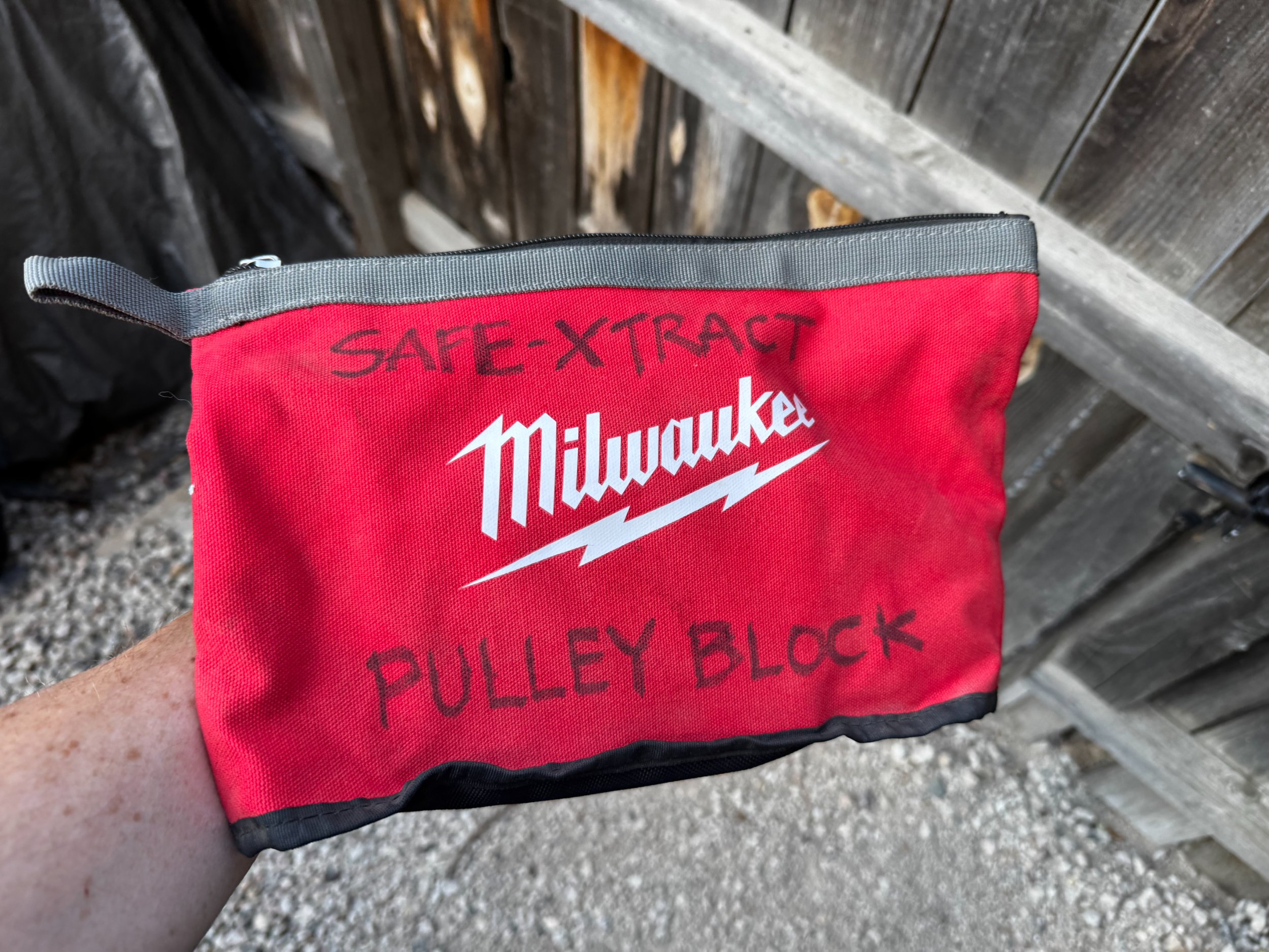

Did you get the case? If so, would you recommend it or is it to bulky?
I did not buy the case. I have something that is less bulky. I'll snap a photo.

no worries. I ordered the ATC bag that will hold it
