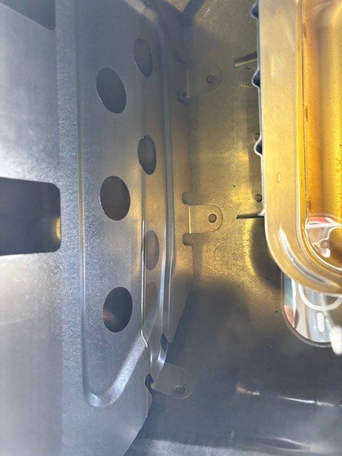

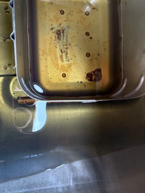

Dom I used a hand transfer pump like this to empty out the tank before I dropped it. 8 Bucks at harbor freight.

Does an 80 not have a drain plug in the bottom of the tank like a 60?

I used the drain plug when I cleaned out my 60 tank but didn't want to risk damaging a very clean tank for Dom and Brandi.

Damn that IS clean. And yeah, sometimes if the plug hasn’t moved since it left the factory, there’s a risk of damaging the threads. I think I came close to that when draining mine … but I was eligible for a new tank under the recall so it only had to last a month!
my tank was clean like this when i did the fuel pump on my 80 after it failed coming home from Argentine a few years ago, I was horrified when I opened this tank and found this rusty mess (insert Nietzsche abyss quote here)
I have a cheap drill powered transfer pump that I have been using that takes some of the forearm work out of the equation but I will use the tank drain plug as I did not know about its existence. Once again, too many years of working on GM products has me expecting the worst for maintenance based design 😅 :cry:
