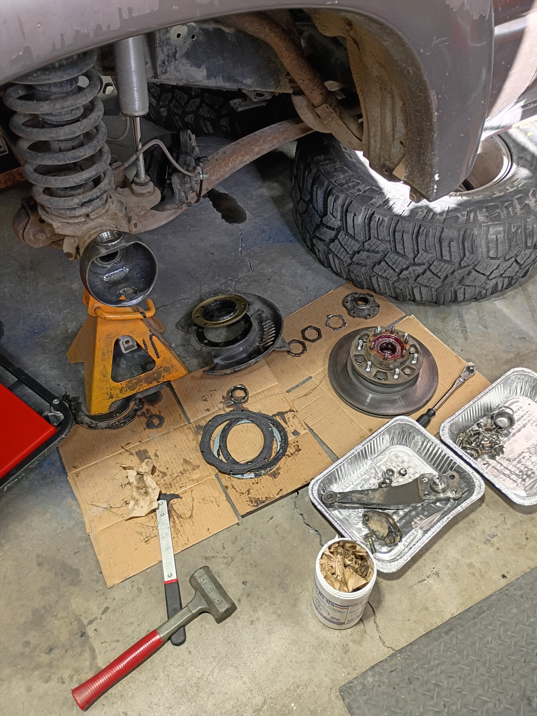

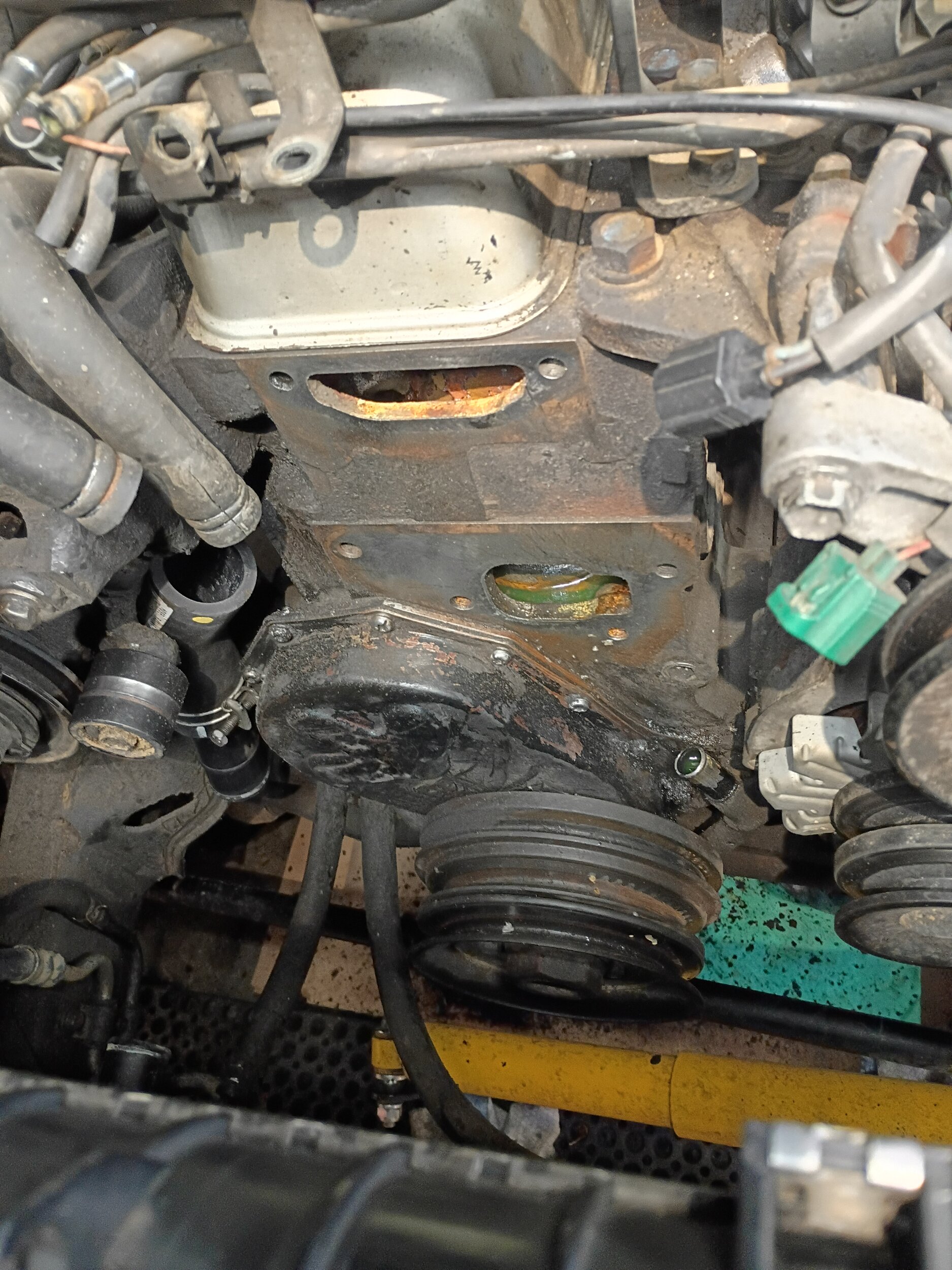

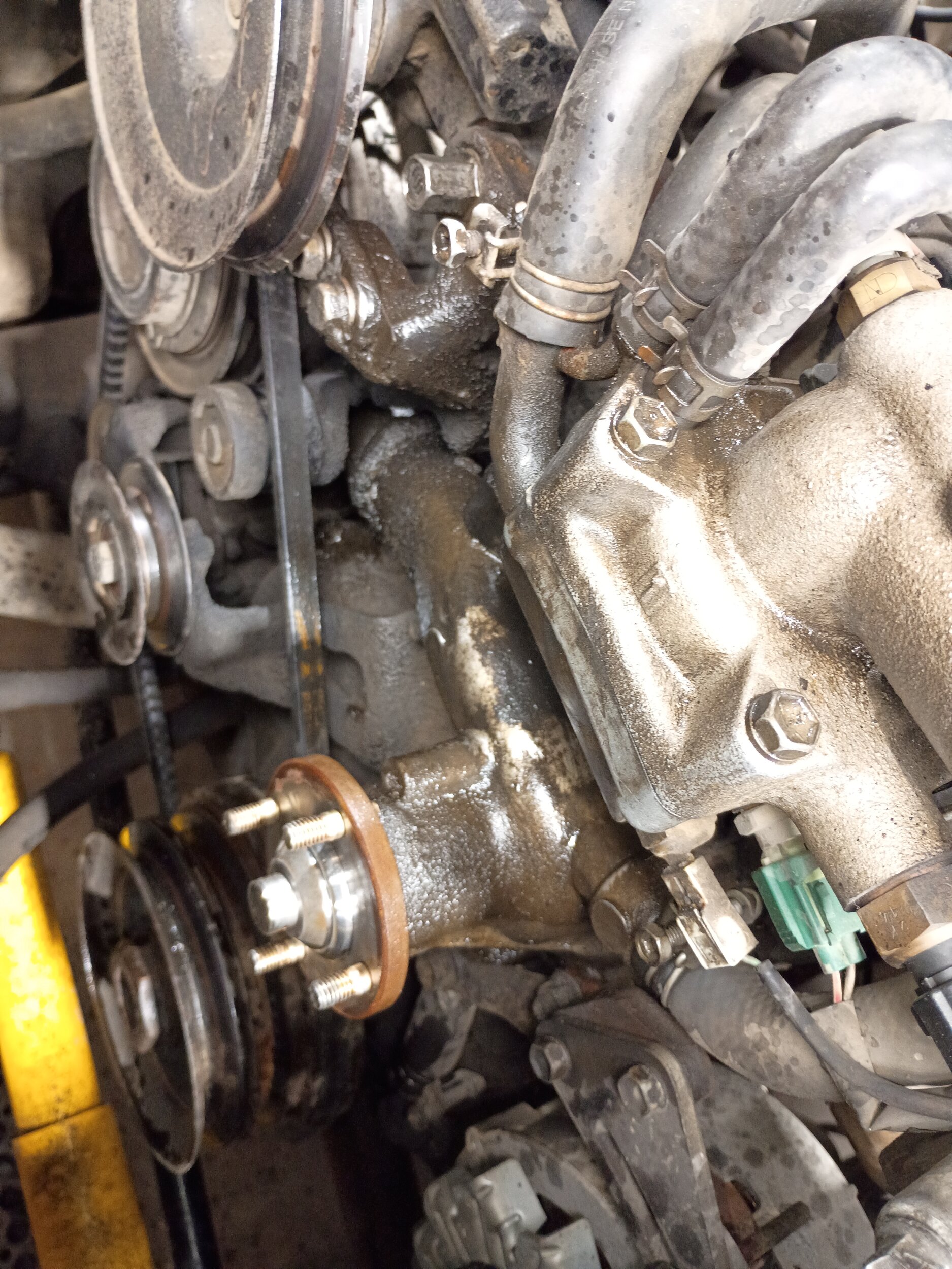

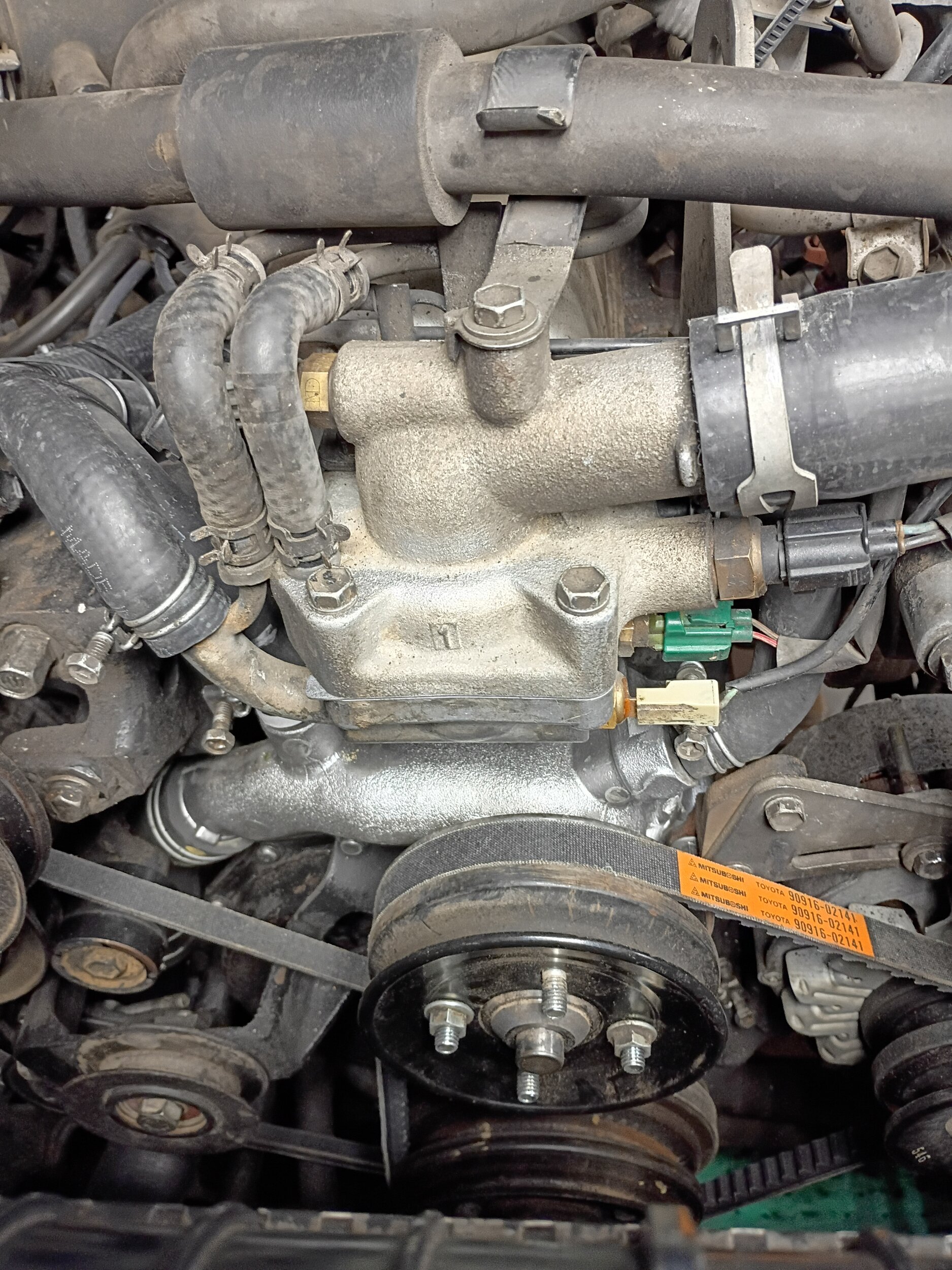

The water pump had given us 2 instances where it started leaking and given that we hadn't touched the cooling system since we got the truck, it was time for some love. New water pump, tstat and 8 different coolant hoses were replaced and flushed the system a few times.
it took a while to clean up all of the built up gunk from the leaking power steering pump I had previously addressed.

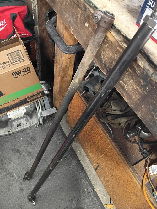

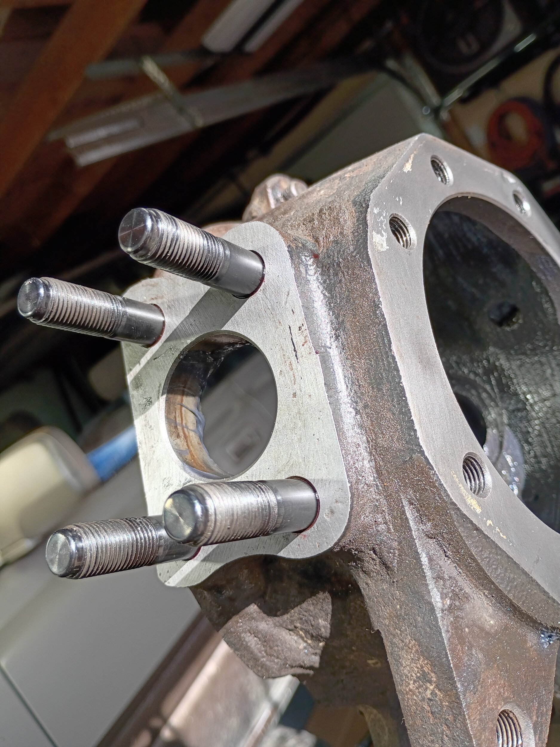

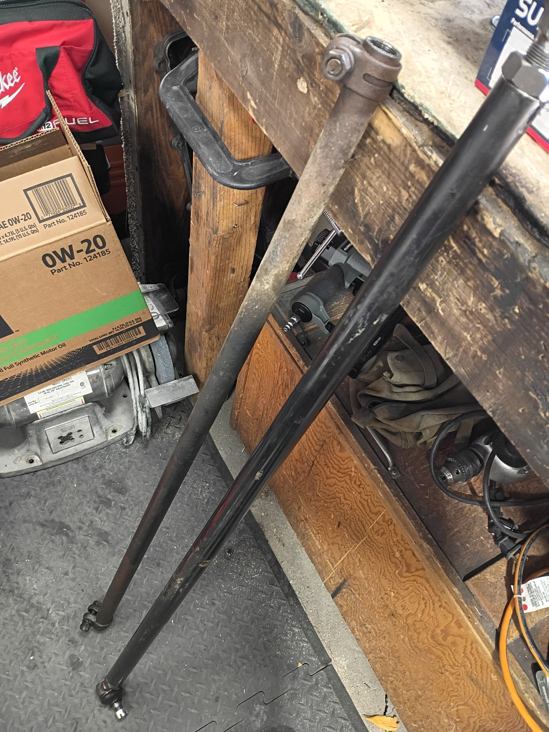

new belts and leak check from the 16 connections I touched. Next, the inner axle seal failed due to an install issue and started leaking so a new wiper and seal kit went in, with ARP steering studs in the knuckles. And finally installed a Slee drag link thanks to @Eyepain

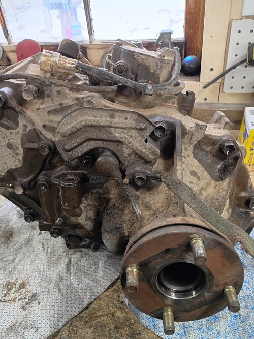

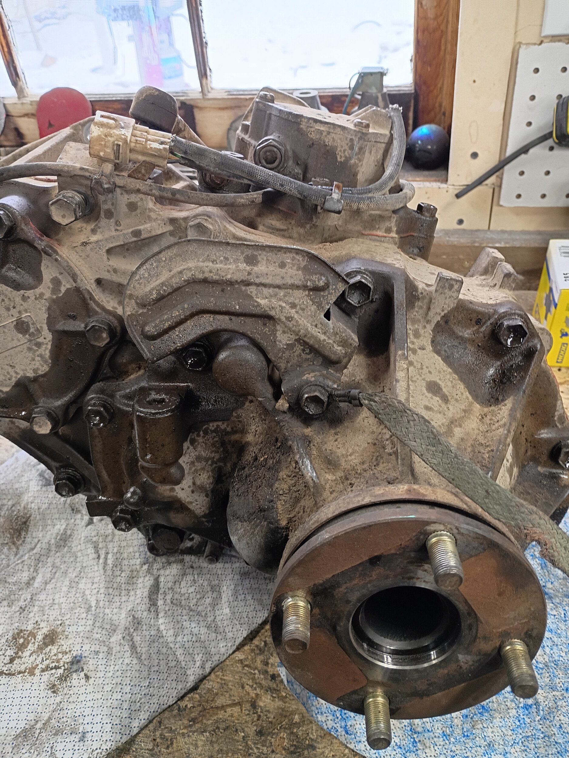

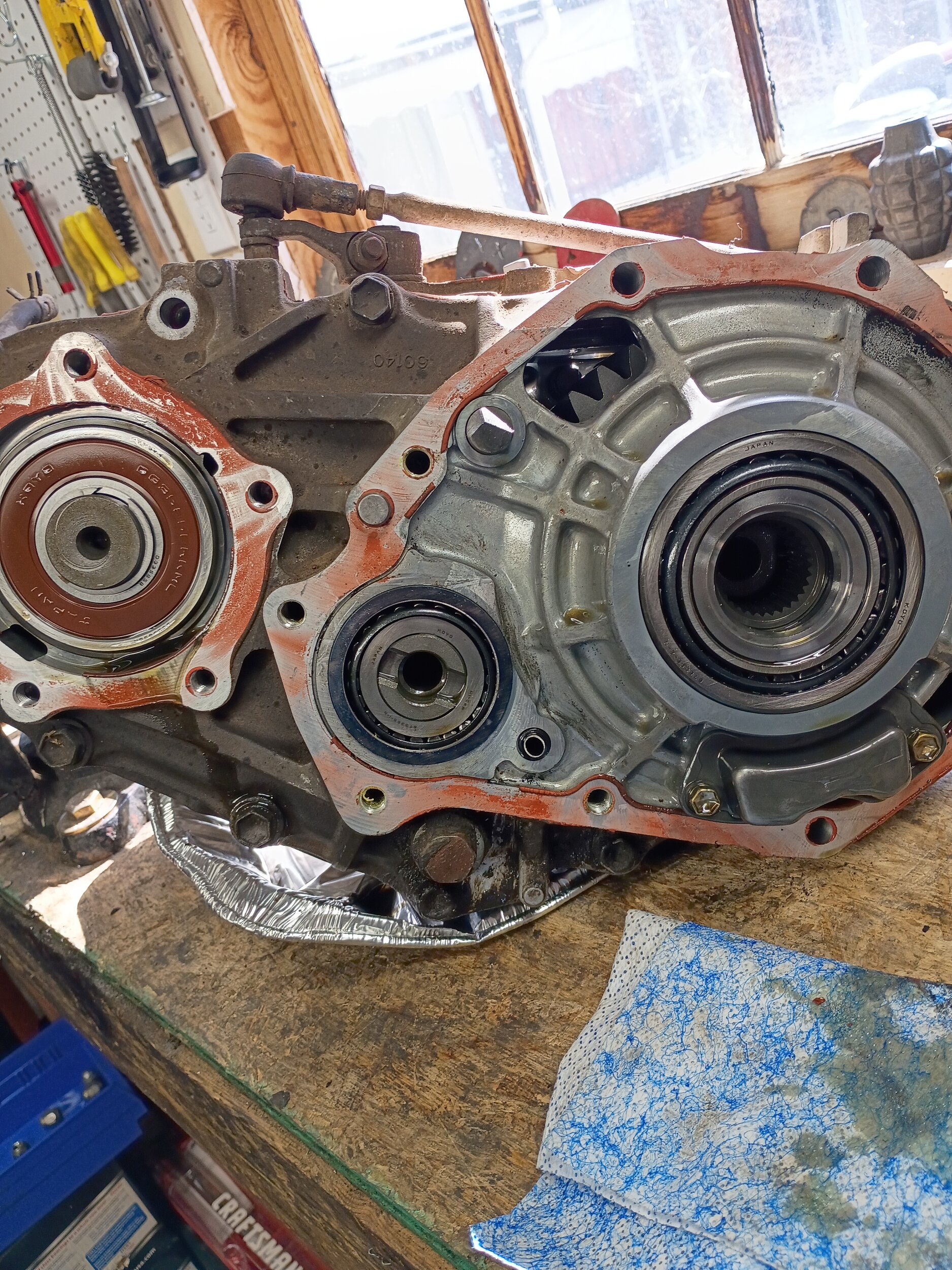

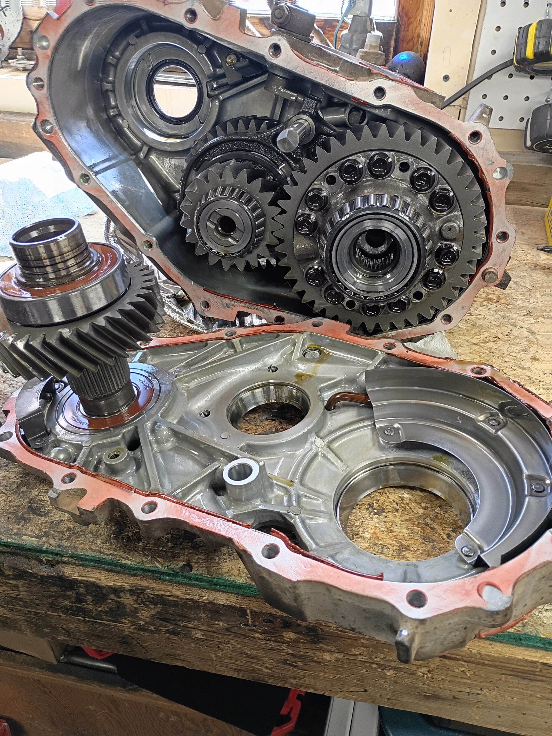

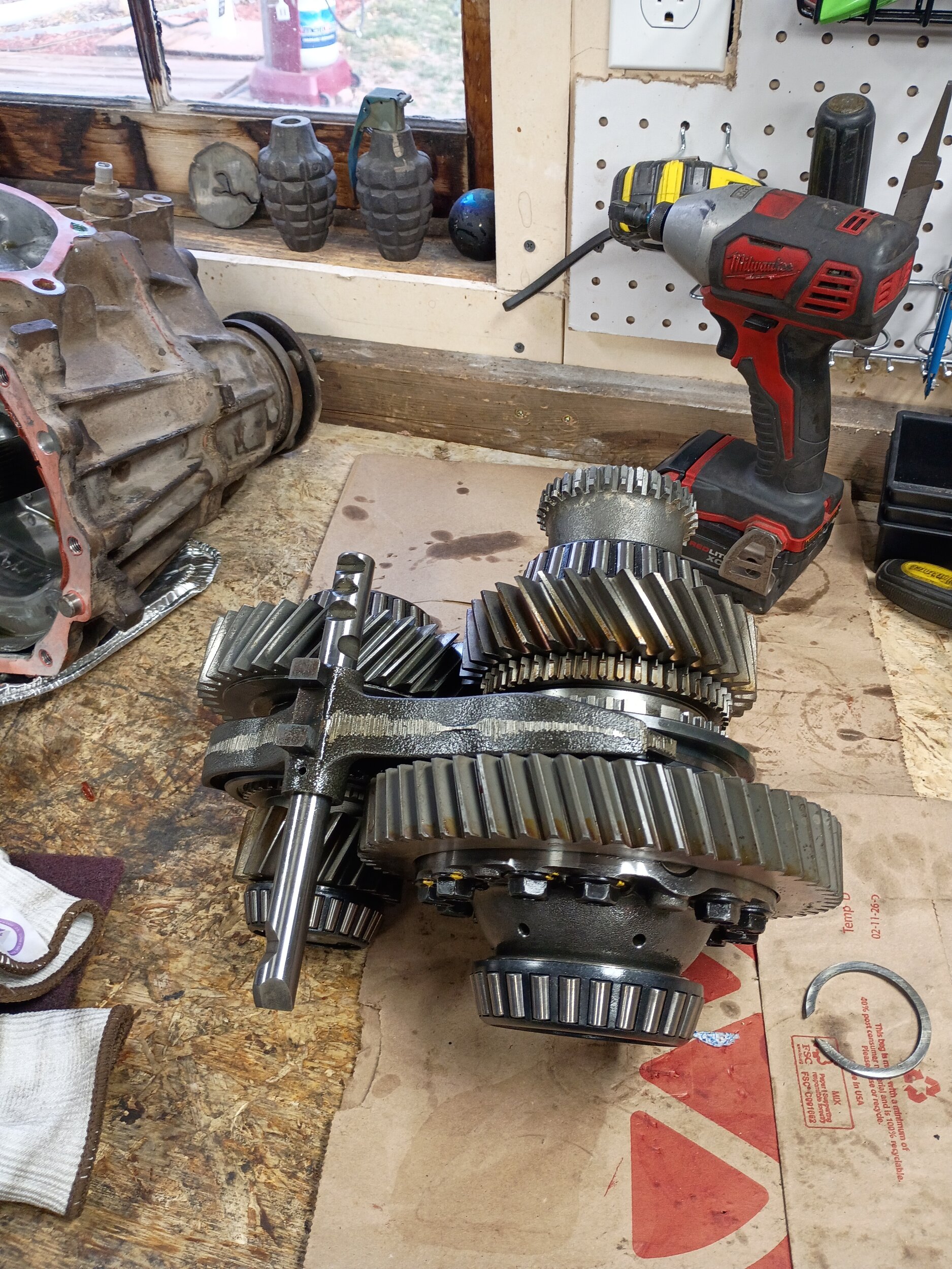

10% underdrive high range, 3.1 low range tcase gears.
pulling the tcase was the hardest part of this project 😂
we have the tcase reassembled and reinstalled, working on getting some break in miles on it now 😄
Also replaced u joint on both driveshafts

Notes about this install:
-the underdrive high range adds an additional 10% of reduction to the low range, this puts the overall crawl ratio of the truck at 39.91:1, not too bad for a fairly stock truck
-all work performed with a harbor freight press, a large gear splitter and a Milwaukee 3in grinder for oil slinger and case clearance, as this was my 2nd time doing this gear install, it went quickly
-this tcase did not want to cooperate with my transmission jack, I could not get the splines to line up, I ended up resting the case on my chest and bench pressing it to align the input splines, that was fun 😒
-part of the exhaust had to be removed on this early 80 due how the crossover pipe is routed
-comfort is where you find it, crossed legs of concentration as Allen said 😉
Did you video this technique?
There's a huge demand on youtube for these types of upper body workouts.....could go viral!

Did you video this techniques?
There's a huge demand on youtube for these types of upper body workout......could go viral!
Haha, I realize in retrospect that my statement may read as bragging about strength, please understand that this was a single attempt struggle-fest and not a full repetition lift set.😄😉
In my past GM days, I went through a few NP241C transfer cases (chain drive, all aluminum) that are relatively light weight and easy to remove by hand, so this was a fallback method for the LC tcase install and not something I would recommend, and something I would never have attempted with the NP205 I swapped in my old Blazer

Thanks! Brandi is used to driving my 80 that has this gear set up so that was part of the decision to do it to her truck. And with the early 80 trans having a lower first gear, the 3fe doing its best impression of being a NA diesel and the truck sitting on 33s (because she's a better driver than me and doesn't need bigger tires 😉), it pavement crawls really nice and can't wait to get it on trail

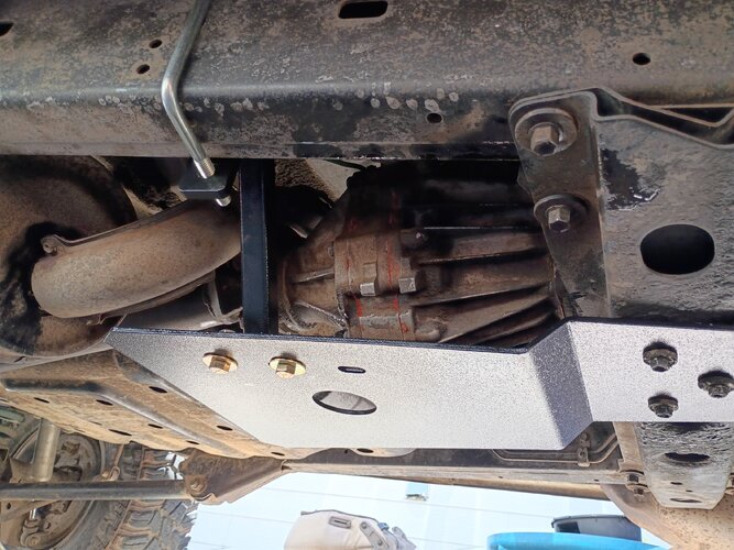

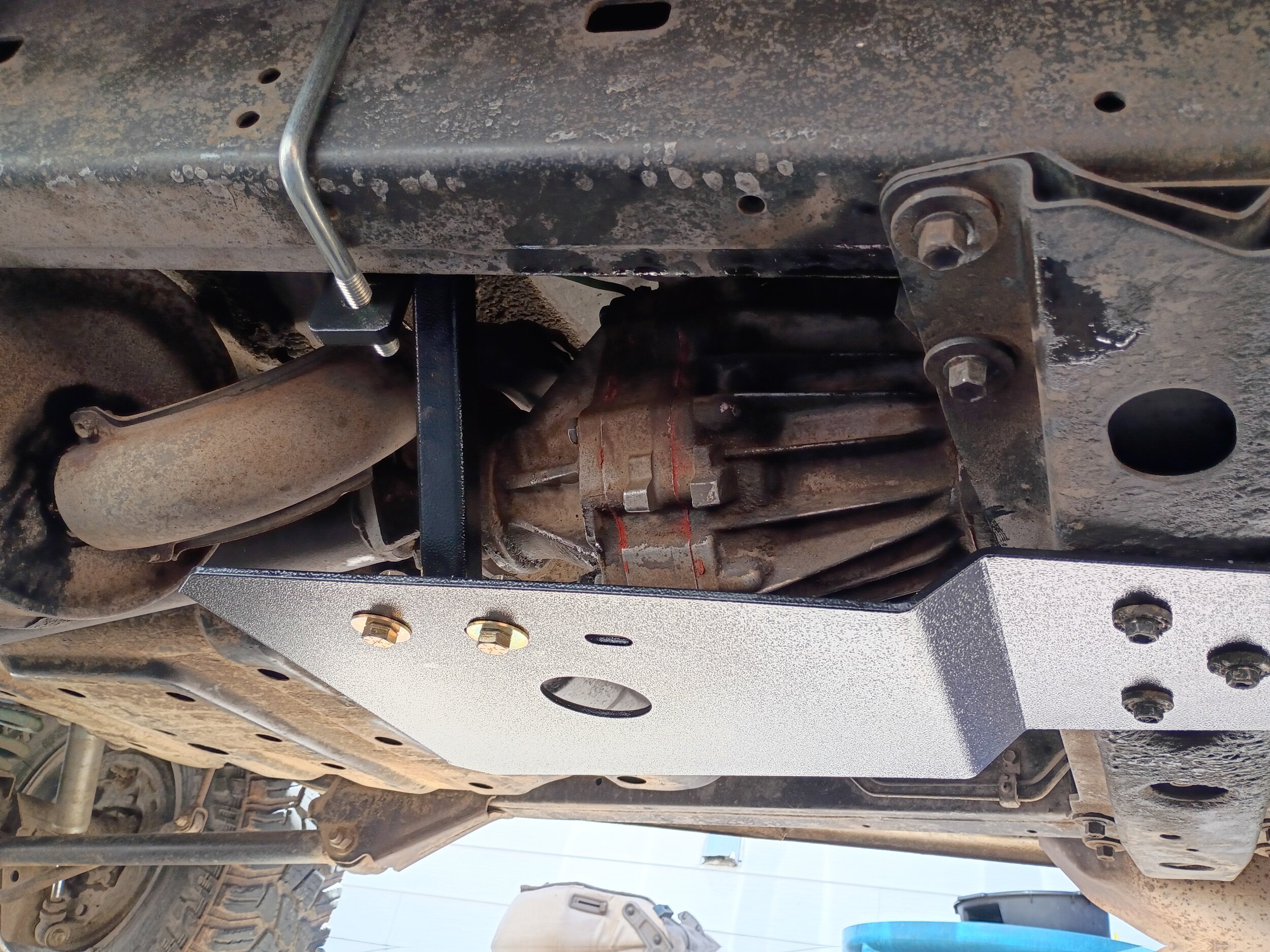

550 mile break in oil change on the tcase and Slee skid plate

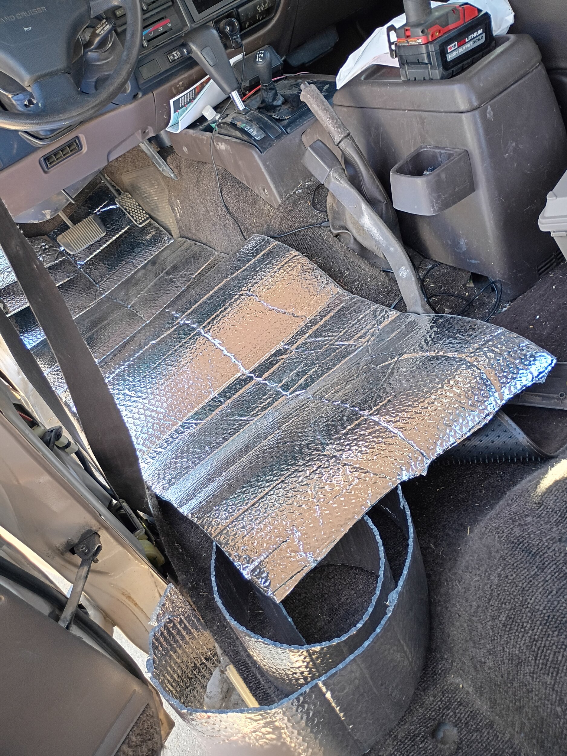

I had some heat shield that I cut to length and squeezed under the carpet to help with cabin temps. Need to do more and better but this was free and time was limited.

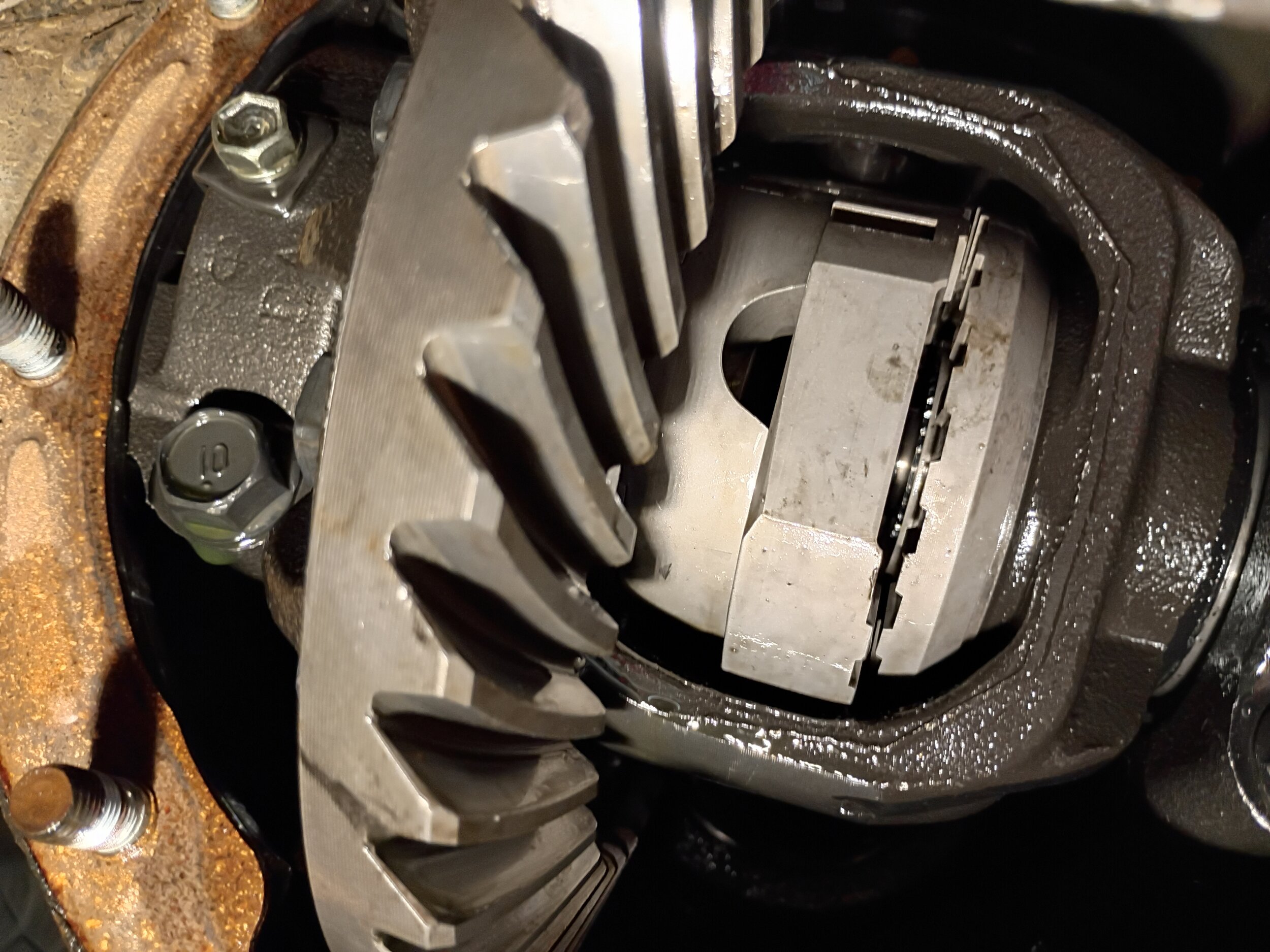

installed a Lokka auto locker in the rear axle, took some trial and error plus some help from MuD to figure out how to get the C clip placed 😂😂
use that tiny little slot between the dog clutches

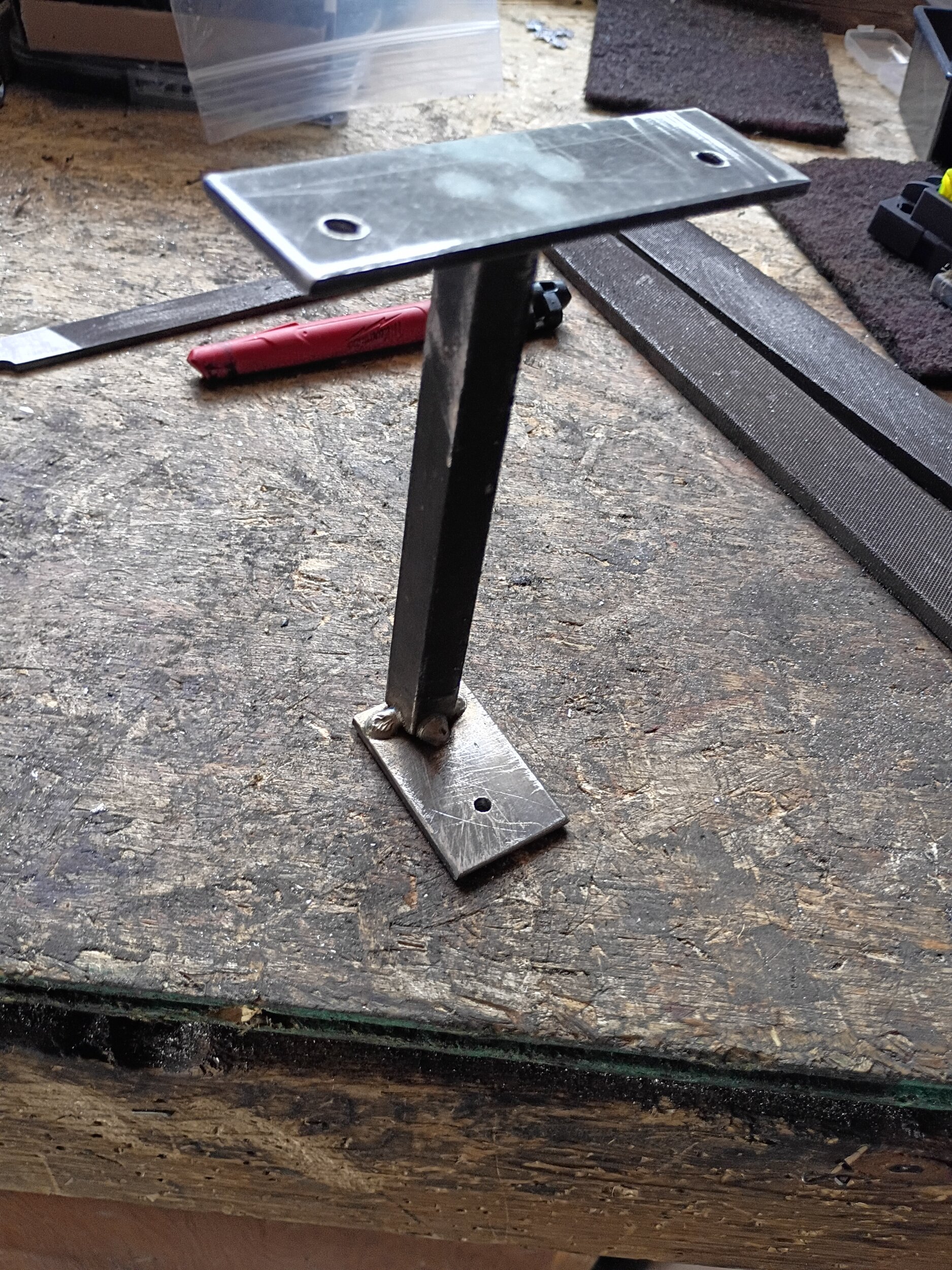

i fabbed up a little bracket to hold a cheap little accessory fuse block but forgot to take a picture of the final product before she left😅

How did I get so lucky to find you my love? I didn’t even know you did the heat shield for me! My feet definitely felt a difference. We have made it safely to camp with with @Cruisertrash Mrs trash and @fyffer ! We have had three days of travel via trail and dirt and I’m ready for a shower. Send @DomOfTheDead all the love as I wheel without him all week. He’s going to need the support 😂😉
