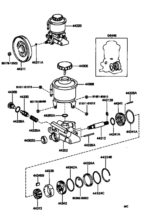

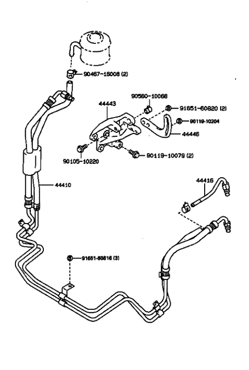

Question to the 3FE peeps: what does the spacer in the power steering tension bracket look like?
I cannot locate this part in my disassembly tray of bolts I removed. Maybe i lost it in the abyss of my chaotic garage, maybe it never had one. I found spare bearing that fits the groove of the pump mount but it isn't quite thick enough, gap is roughly 2.9mm vs my spacer is 2.75mm, causing slight deflection on the bracket.
I found this on mud but am having trouble locating a part #. Thoughts? @DaveInDenver @jps8460
@DanS

If I was to guess it's 90560-10068 "Washer, Plate" as description. The 90119-10204 didn't come up in web search but 90119 are usually bolts and 91651-60820 is for sure a bolt and subs to 90080-11271 now. Then in front 90105-10220 also seems like an unusual part number that doesn't hit in a search but also seems like a bolt,
The EPC diagrams aren't too helpful here and if I was to suppose it's NLA even if it ever was. It wouldn't be the first time a mechanic stacked a few washers to get belt alignment right...
