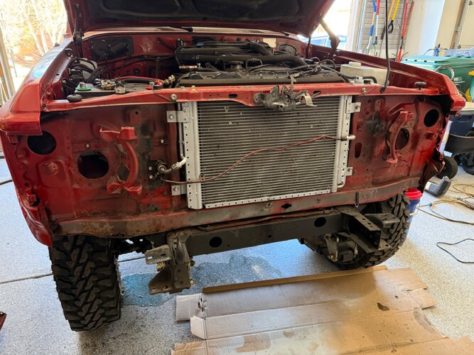

The thing is, I've run the clock on the welding. I'm dropping off the rig at the body shop on Monday, so I ended up purchasing an intact donor to avoid dealing with the body repair. I'll sell mine to recover some of the funds.

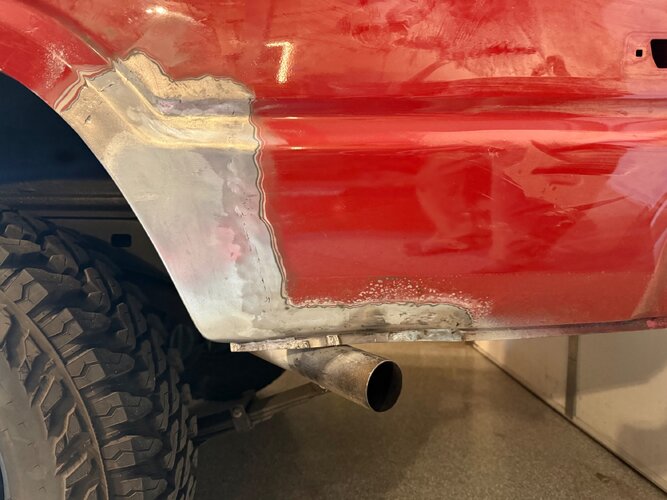

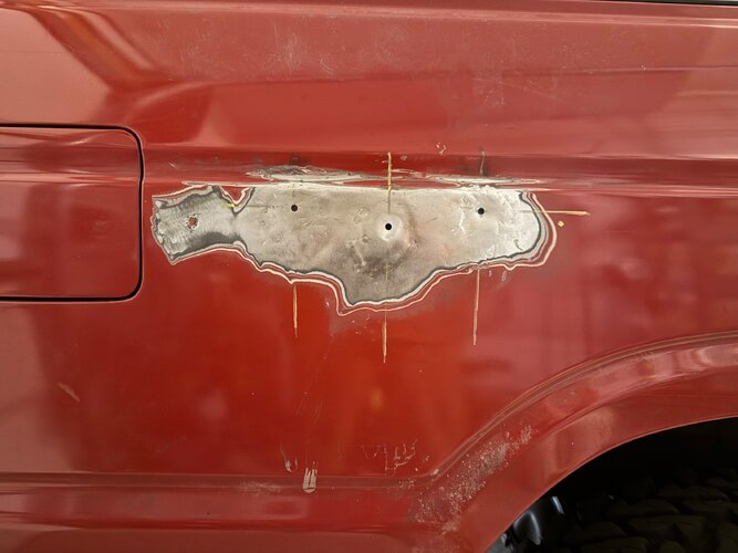

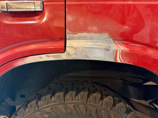

And we’re done on the exterior. There some bending on the panel, will need a slight amount of filler. I discovered pinholes on the driver side, using fiberglass cloth and repair kit to plug it.

It’s going to be awesome. Do you have an estimated time to complete? Hard to get body shops to commit…

I just got from the shop. We're looking at two +/- months; I spoke with JR, the owner, and his shop painter, who seems detail-oriented. I've been invited to visit the shop to see the progress, but for now I'm going to take a breather.

Where did you end up dropping it off? I dropped my HDJ81 to Southern Peak Auto Body 4 weeks ago for a stated 2 week duration to repaint the sun damaged hood, rear hatch, and side mirrors. This morning they told me it would be at least another 2 weeks from today. I'm okay with it since they do great work and don't want them to rush it, but it may take longer than expected based on recent experience...hopefully not!

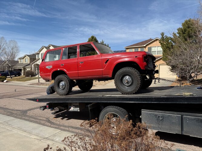

Just this morning. I was following the tow truck on the way to the shop. I was like, "Man, that's a gosh darned, good-looking rig, I'll tell you what."
They're taking the doors, hood, panels, including the radiator brace, all the way off. That labor is time-consuming. It's going through an interior and exterior repaint. We agreed that the interior floor is getting an equivalent of Lizardskin in red. Same with the inner wells in black, definitely don't want them to rush it, but also don't want it to sit there longer than it has to, because that means money out of my pocket.

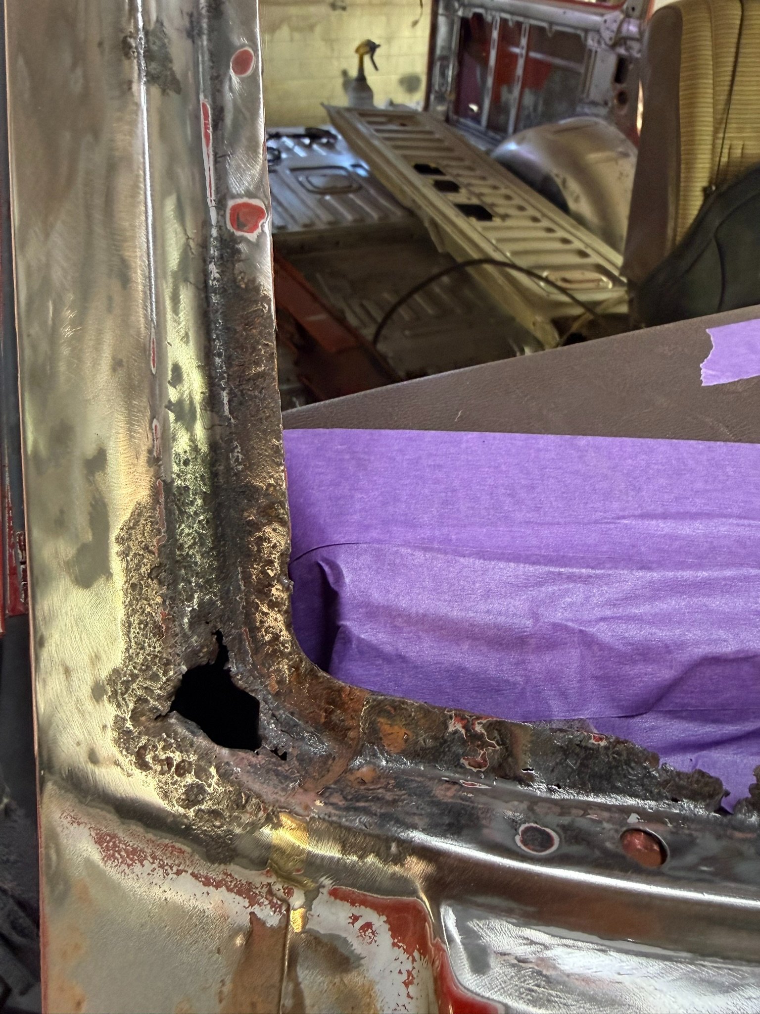

:rant:The breather wasn't nearly long enough. Some progress, some setback, though localized and very much the only "trouble" spot. The replacement inner-fender went in, so that's good. That core support is getting blasted and repainted today, and I so lucked out on that one since it's in immaculate shape.

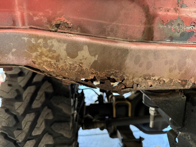

Youre going all in! In hindsight, do you wish you had started with exploring for rust on the exterior body vs doing all the interior work?
I am amazed the rockers are solid, as they usually are toast if the floors and fenders have any amount of rot.
Keep up the good work, going to be super nice when its done.

It's all a lesson learned. Like, inspect the rig before buying and know what to look for. The first time is always rough. It's like the "Money Pit" movie. If I ever decide to do another rig, I'd be much more prepared.
^ me with the new pitting.
I go through enough hindsight fallacies elsewhere not to do it here. I don't know if I could have come up with a project plan or sequence that would have started in one area or the other. It's either a slow discovery or bulldoze my way through everything in quick (relatively speaking) succession to get it over.

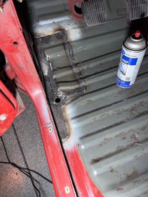

I did the interior to preserve some capital on labor costs, check for any other hidden problems, and take care of the already visible parts of the interior/exterior to get them out of the way. The floor pans consume the bulk of the effort.
I wasn't aware that the A-pillars are problematic, though it makes sense when the floors are rotting; the issue goes upstream. It gives me pause. I'd like to inspect the firewall now.
Hold your thought on the rockers, we'll see.
Edit: didn't mention, doing the interior first was also to figure out how much of a pain it might be. For example, knowing if the roof is in decent shape. Also, now that I think about it, I should have removed way more on the exterior, panels, the whole thing. Would have saved me more dollars.

Yeah, I'm definitely not chasing perfection, but I can't tolerate obvious problems, so I fix them. I see the light at the end of the tunnel; the A-pillar is the worst part.

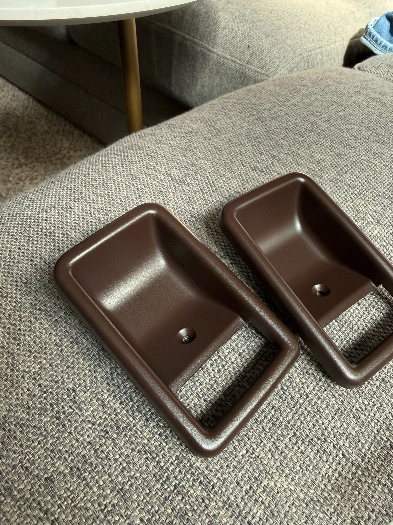

Meanwhile, I've been gathering odds and ends. I bought door bezels; the seller claimed they're brown, yeah, right. Nothing a SEM 15023 can't fix, and at this point, I'm pretty much repainting the bezels and interior parts with the same rattler to maintain continuity. I also found out SEM has a satin clear for plastic, so that'll be my next experiment to see if I can harden the paint so it won’t chip easily. The first try at painting from black to brown turned out okay. I bought an extra set, but the next step is to clear coat those to see how they'll hold up.

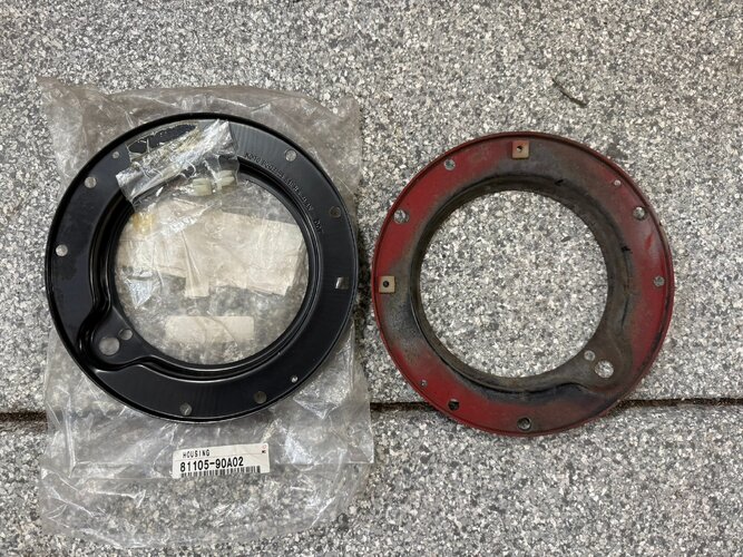

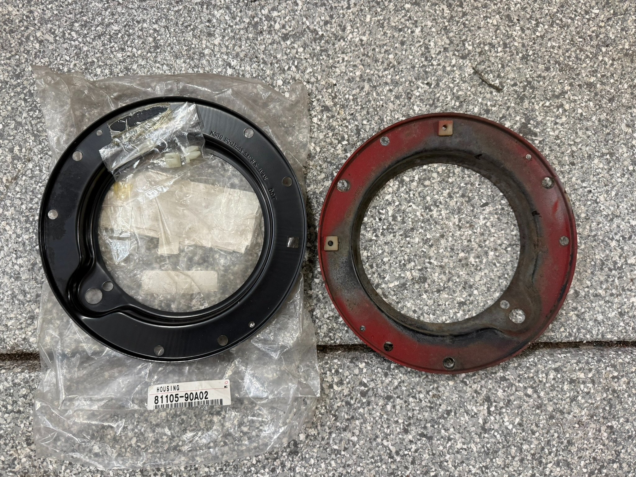

I accidentally damaged the left headlight housing because the bolt wouldn't budge, so I searched around and, surprisingly, found a $26 OEM replacement. Phew!

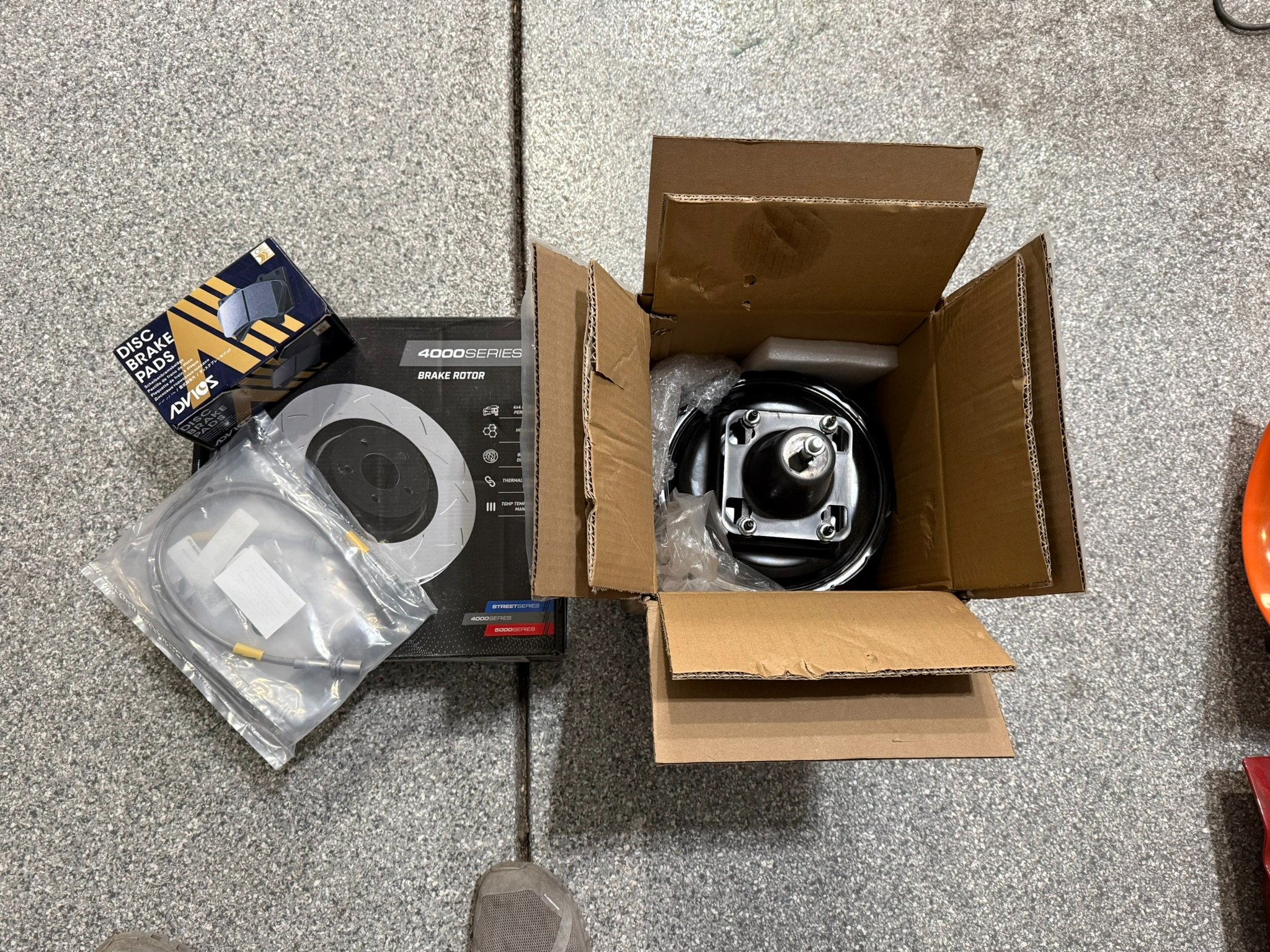

Finally, after posting about the brake upgrade a few months ago, I decided to keep it simple and make an incremental upgrade without overhauling my brake system: dual-diaphragm booster from City Racer, new pads, DBA rotors, and extended metal-braided lines. I might eventually try a different master cylinder when I'm brave enough to figure out the intricacies.
4,647
The OEM parts that are still available for our old iron makes it smart to check with Toyota before settling for aftermarket. As for brake master cylinder, I tried a non-abs 80 mc thinking it might add a little extra braking power but it didn’t work out that way. Went with a new OEM mc for my 62 and was then able to lock up all four wheels without problem. That was with lots of body armor and 35” Swampers. With all of the new brake parts you have I’m guessing you will be very happy with the results.
