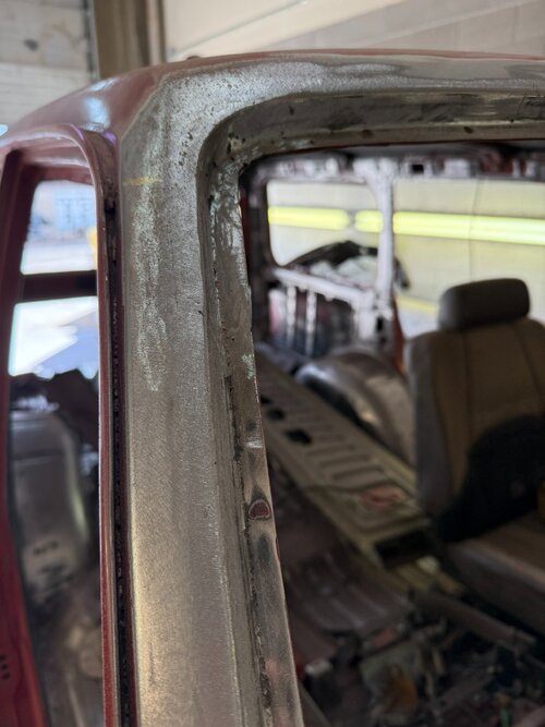

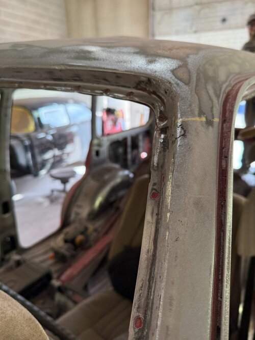

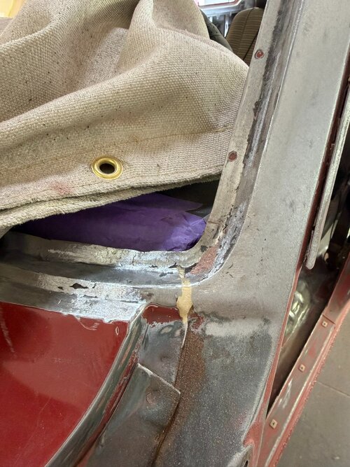

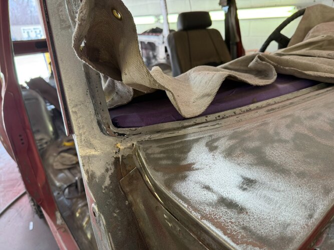

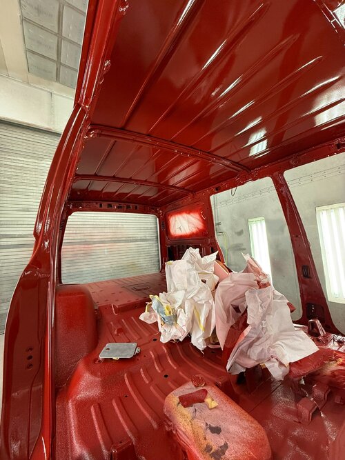

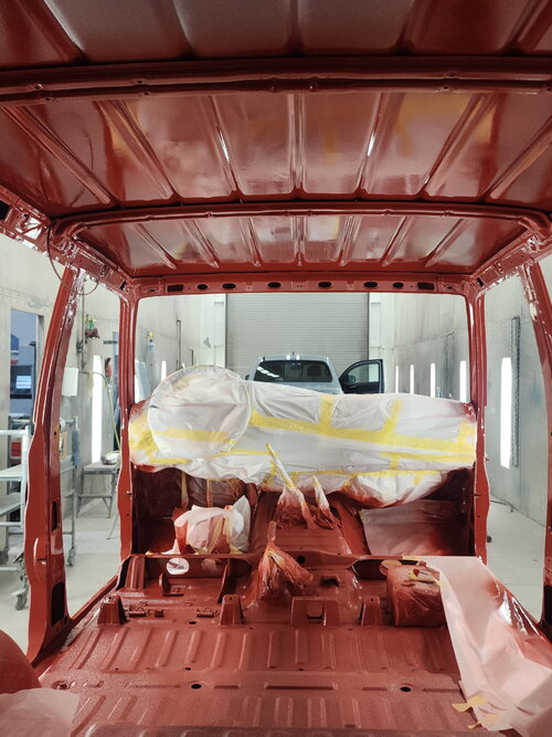

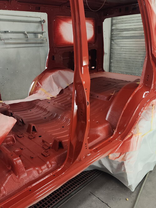

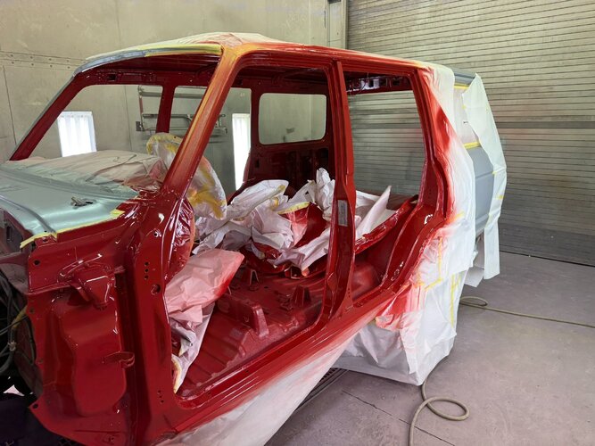

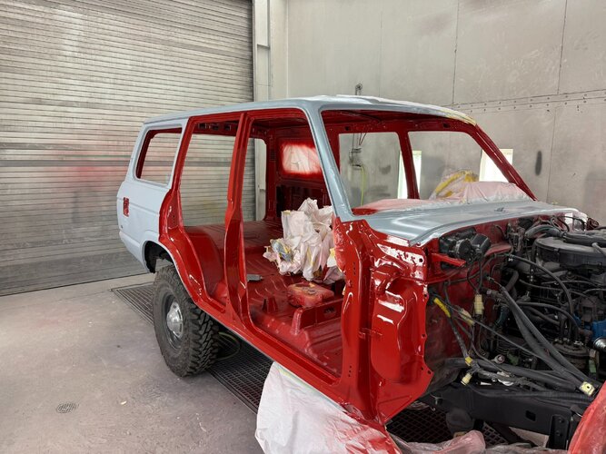

Popped in the shop to see the progress. After about 14 hours of work, it's as good as done; they've moved on to stripping the paint on the roof elsewhere.

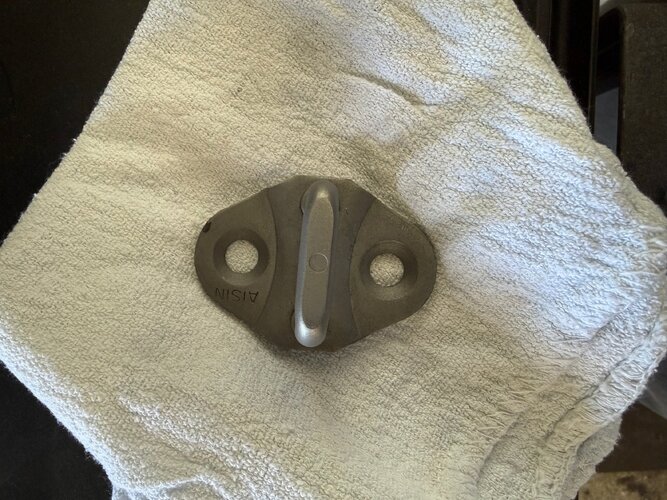

I went and picked up the hardware for the door stuff, going to zinc-plate them to see if I can make them shiny.

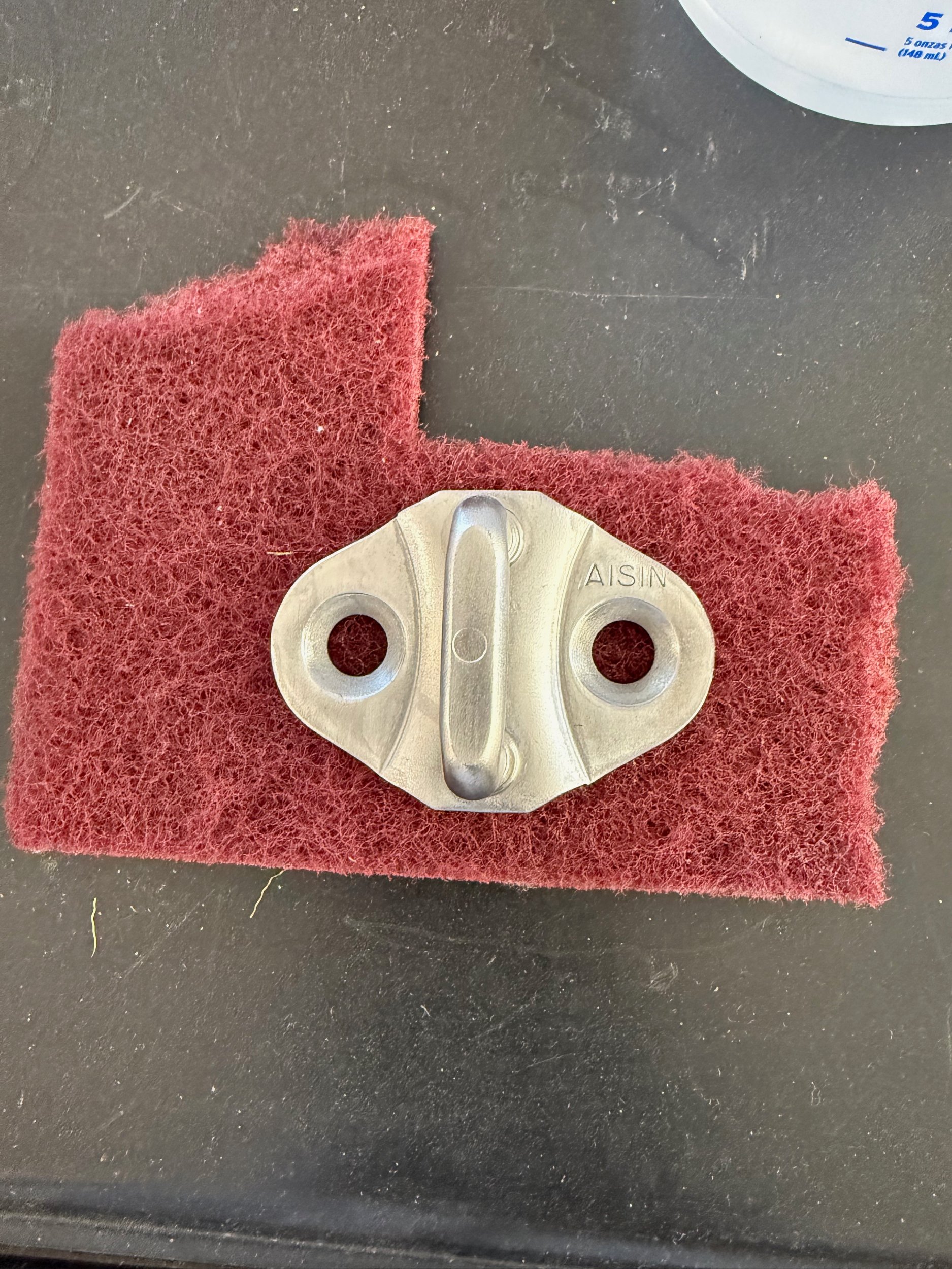

Sandblasting without the proper setup is PITA. I set up a tent in the garage and went at it, lots of dust, the media remained in the tent, so I can sweep. Have I told you IH8RUST? Lots and lots of prep work to get the parts ready for the zinc plating. I'm hoping it won't turn into a disaster, requires a non-trivial amount of prep and setup.

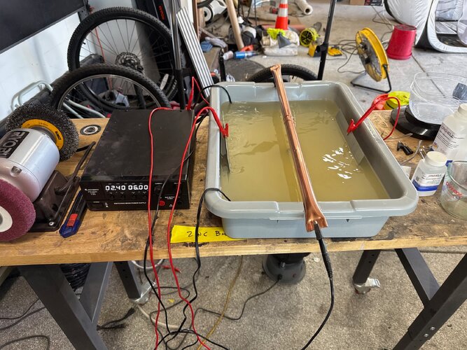

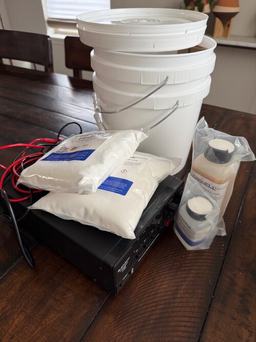

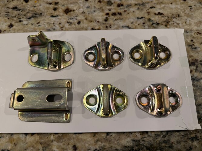

I get super excited over things that includes chemistry, so here we go, the kit has arrived, will be setting up the workstation to zinc plate the parts this weekend!
IH8RUST
Jun 13, 2024
398

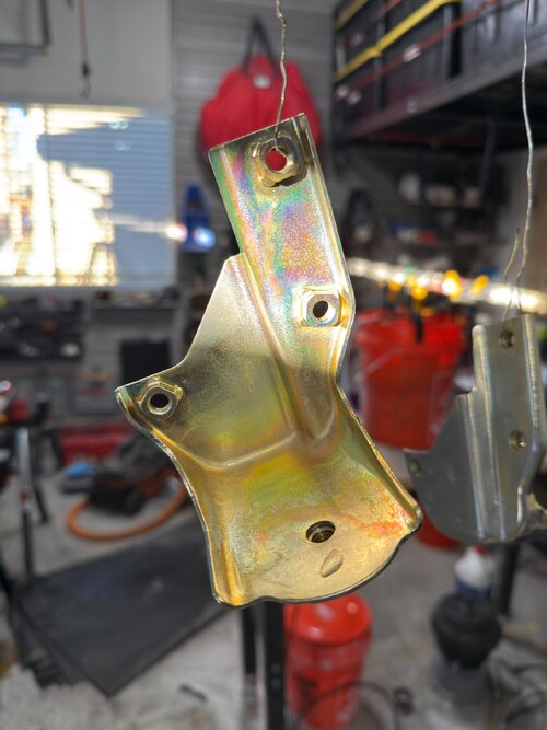

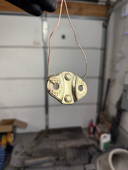

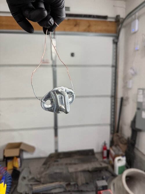

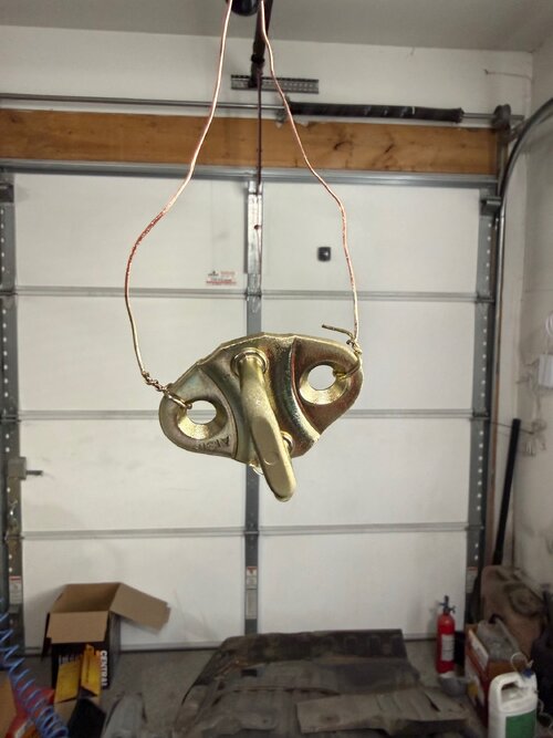

First attempt at plating, like wow!!

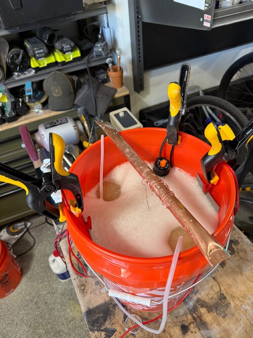

The setup. There are also Acetone and HCL baths on the other side for clearing, degreasing, and etching.Sandblasted version.Wire brushed version.
Zinc bath version for about 40 minutes.Yellow chromate 30-60 seconds.

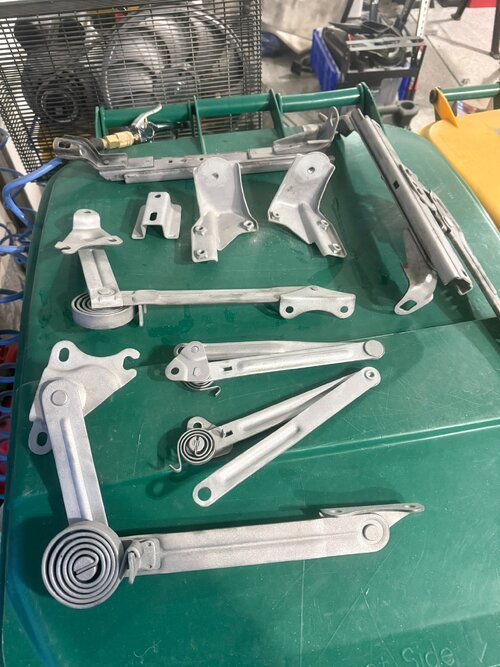

Jun 13, 2024
398
It took all day to do these and I still have to do the hood and hatch hinges. Some came out a bit chalky, unsure what I’m doing wrong, guessing +/- current issues. Anyway, I’m tired.

Still in the garage. Had to add fish tank aerator because bubbles work better somehow. It’s getting more complicated by the minute.

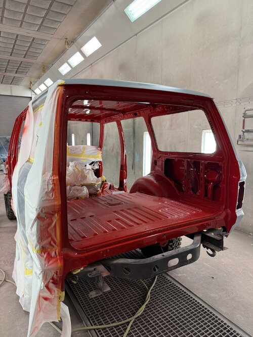

First off, so shiny and glowy. I went and looked at it since JR sent me the pictures earlier. Dropped off the plated hardware and walked into the paint booth to see the progress, and what a progress they've made.
I might have cried a little.

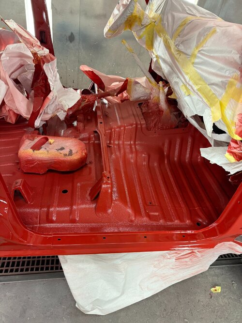

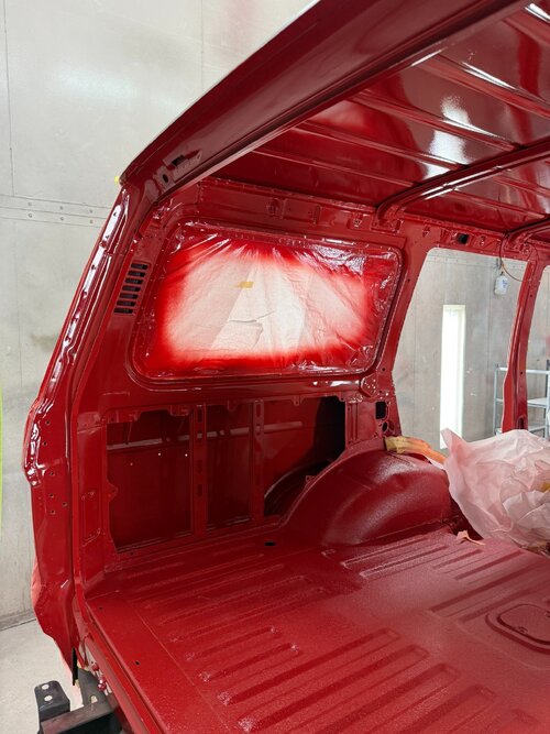

Looking good! Looks like rhino lining on floors? Curious why with carpet?
Not quite the same material, but just as durable, I forgot what it's called. The fenders are also getting the same in black, which means I did all the work for nothing. The rationale is foremost rust prevention, and my unscientific, unqualified understanding is that the texture can damp road noise to some extent. If I recall, we have a musician engineer amongst us, maybe he can chime in :)
On the note of the floor, I'm going with ResoNix CLD.
