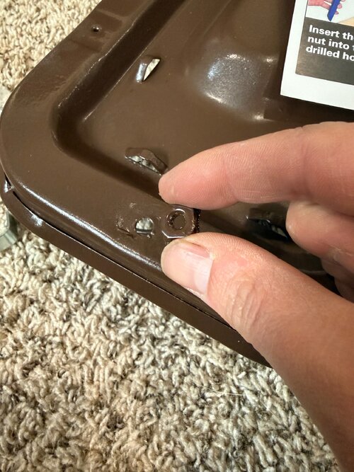

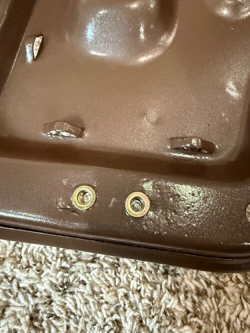

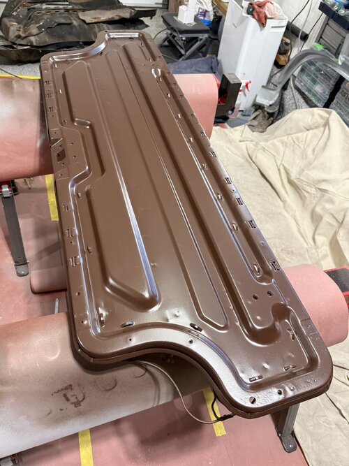

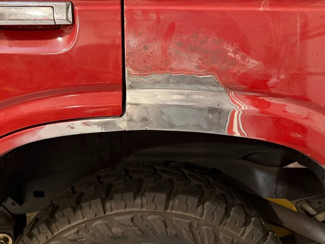

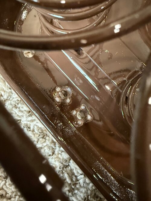

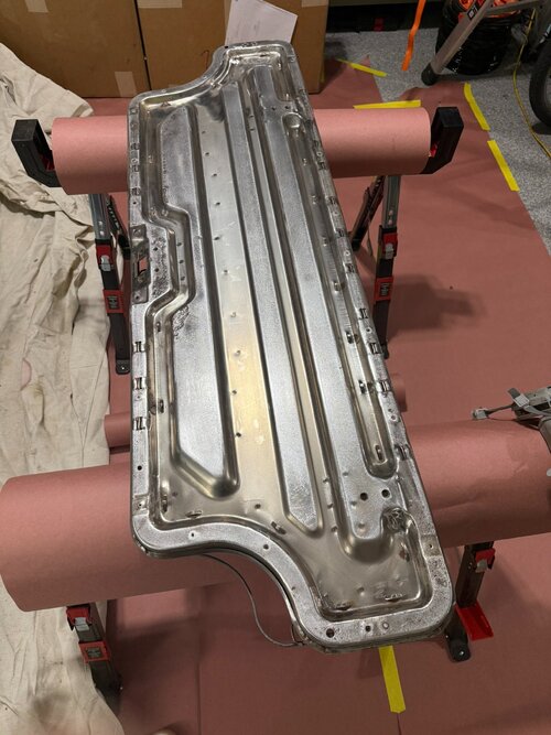

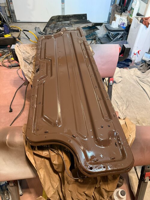

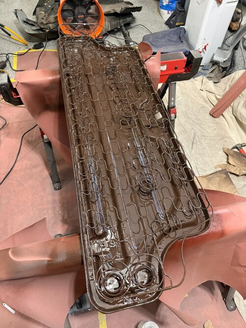

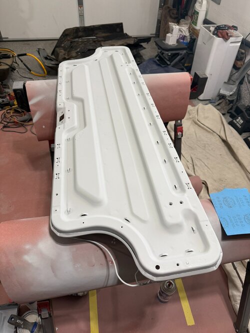

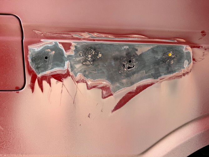

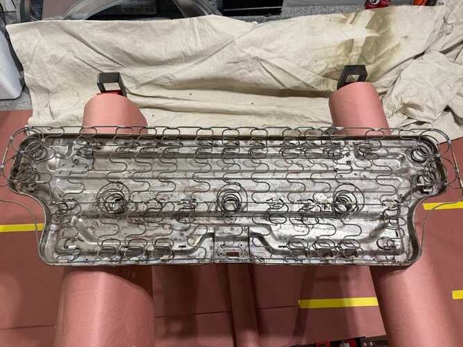

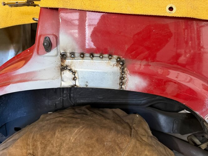

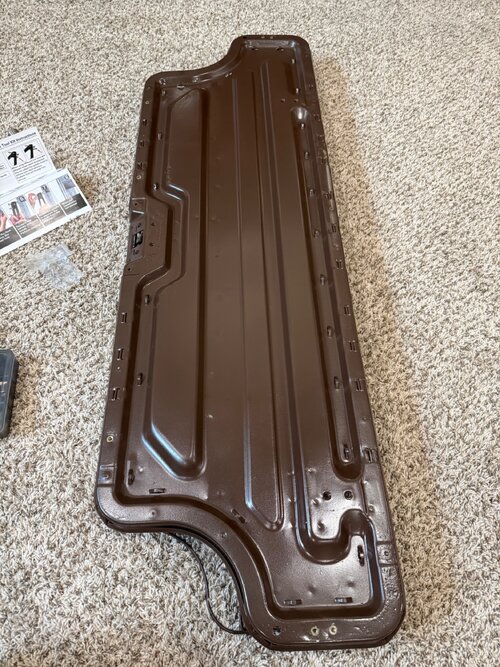

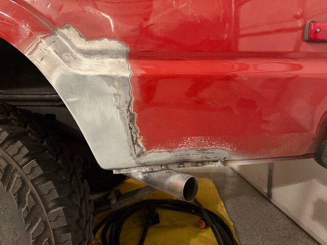

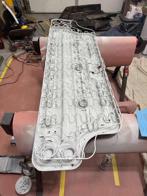

The fender well patch is near complete and tacked; we are almost there. Meanwhile, got up early and finished the rear bench bottom. Did some light sandblasting to get all those nooks and crannies, epoxy primer, sand, paint, and clear coat. The temperature in the garage kept throwing me off on the flash and cure times. I ended up with imperfections that I had to sand and redo because I touched it too soon and left smudges, so it ultimately got more than a few coats. Nothing a little space heater and a heat gun can't help. I was annoyed with my impatience.
The last two pictures are the final coat of the 2K clear; it really draws out the color, that's for sure. No one will ever see or know how much time I put into it since the bottom of the bench is all covered.
If anyone is looking for a good upholstery shop, Top Notch LLC in Springs is the place to visit. I'm going to do the hardware restore, then drop off the bench and front seats for them to refoam and reupholster. They can finish it since the price was right.

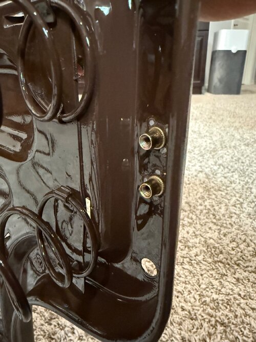

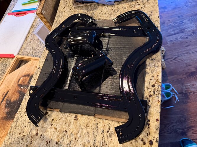

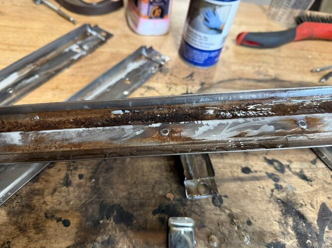

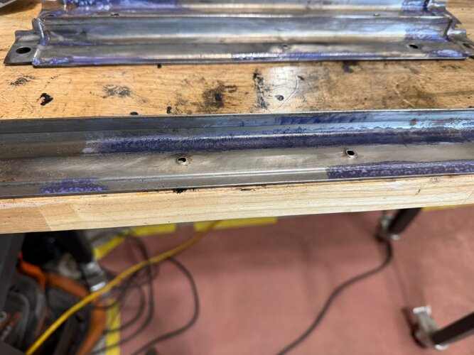

Working on de-rusting the bench brackets. That Rust-Oleum Rust Dissolver stuff is pretty decent for pits. There's also the Black Star Rust Converter, goes from purple to black, good stuff.

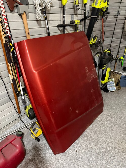

Took delivery. I have a new, fully intact, non-dented, non-rusted hood, all the way from Virginia. Surprisingly, no rot seeing where it's from.

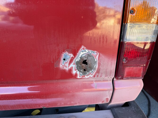

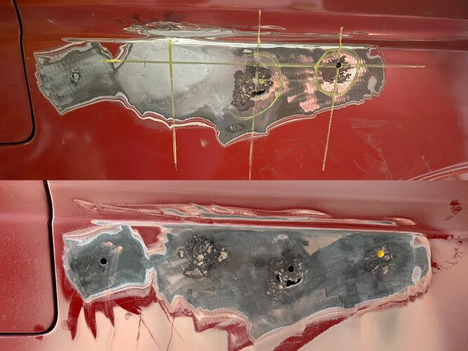

One dollar coin at a time. I've decided the far left will remain as-is; it isn't worth cutting.
Capriblue45
May 28, 2023
523
Will, be sure to check out the bottom 2" of the tailgate as most of them rust in there. There are patch panels available for this area.
