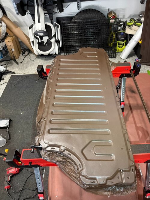

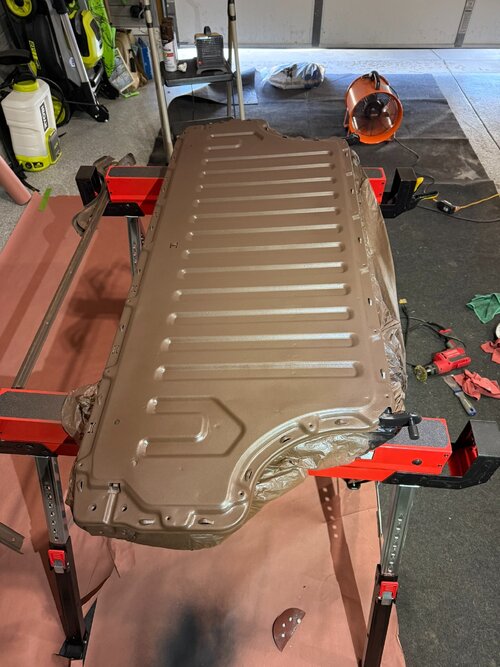

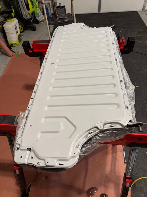

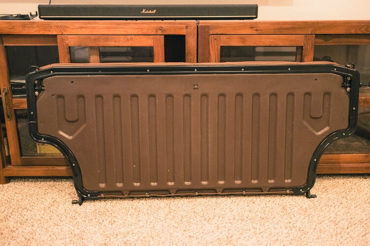

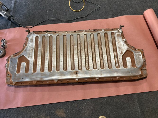

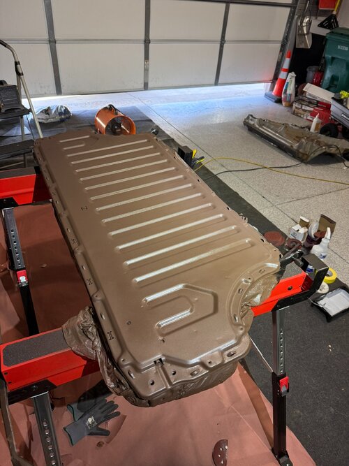

In the meantime, I focused on the rear bench seat. It was all surface rust, so I ended up disassembling, sanding, and priming it. I've never done priming before, so it's a new experience. The Optiflow stuff is runny, but it beats having to spray.
I forgot to take a before picture (doh), but it was completely rusted out. I also bought a couple of folding stands to give my back a much-needed break.
I have to wait 24 hours now, then sand the primer and reapply because I ended up with some contamination during the application.

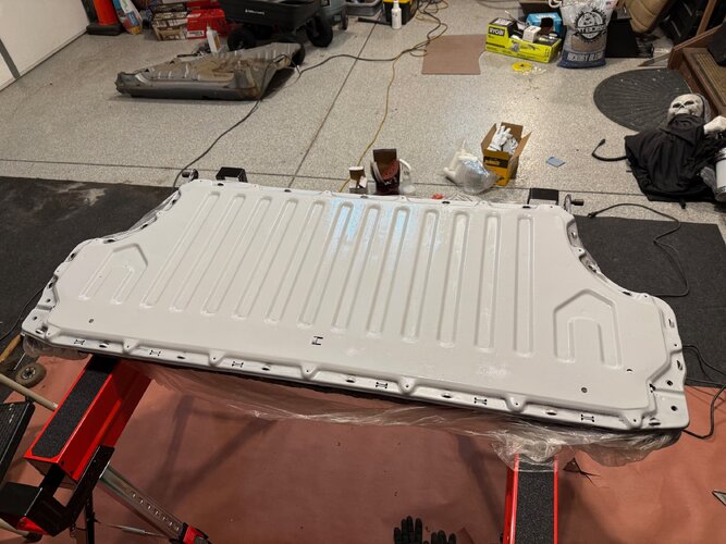

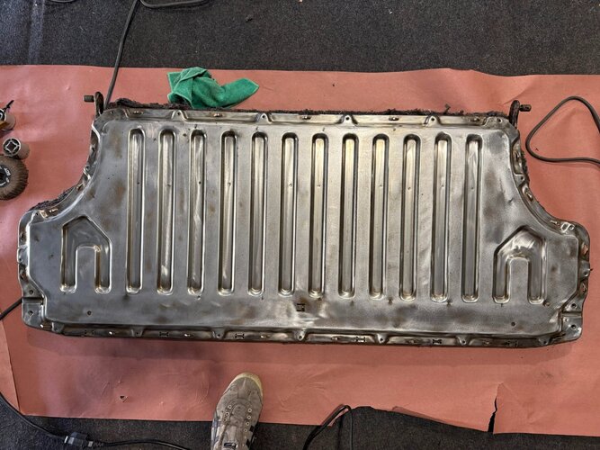

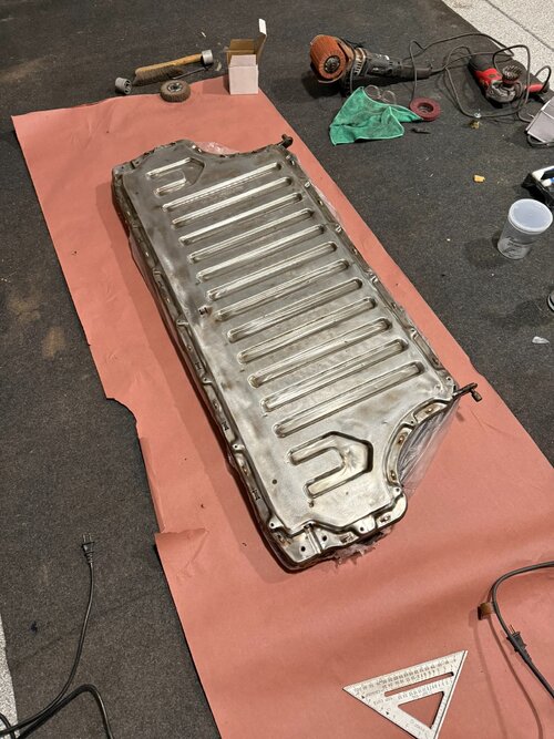

My OCD wouldn't let me stop, so I ended up stripping it down to redo the primer. I'll hit the remaining spots with the spray can. I'm pleased with the results.
Note to self, shake the can before mixing with the catalyst.

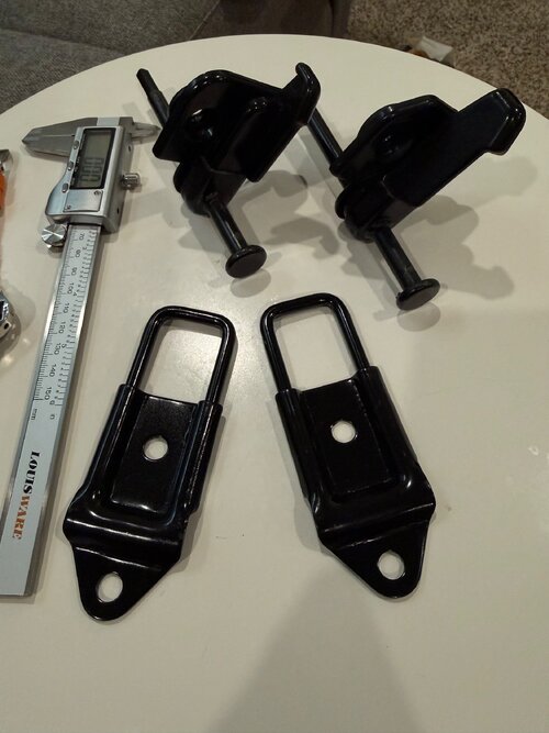

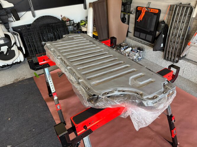

Restored the seat hardware as best as I could. I can finally put it all back together now.

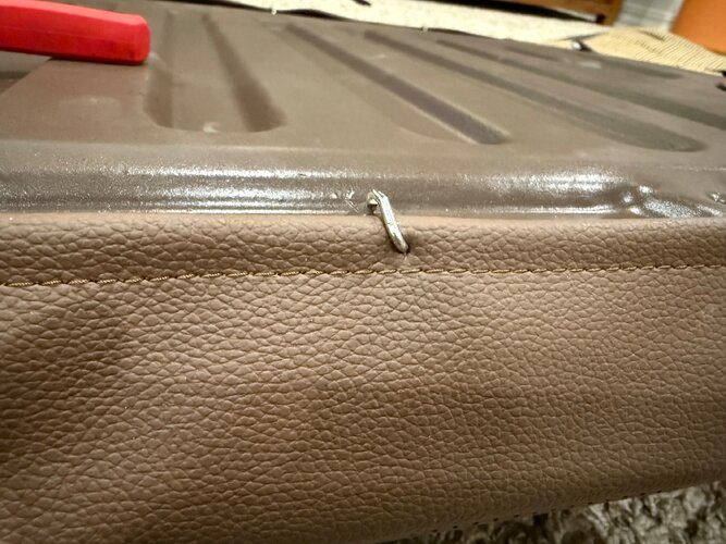

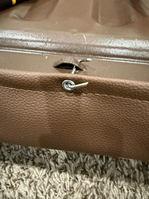

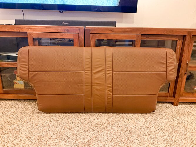

Mosley! I was skeptical, but the material turned out to be nicer than I thought.
Edit: was at a local upholstery shop, the guy asked where I got it from before telling me the material is _really_ nice, so there's that.

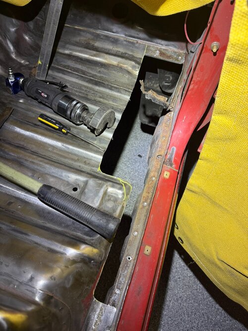

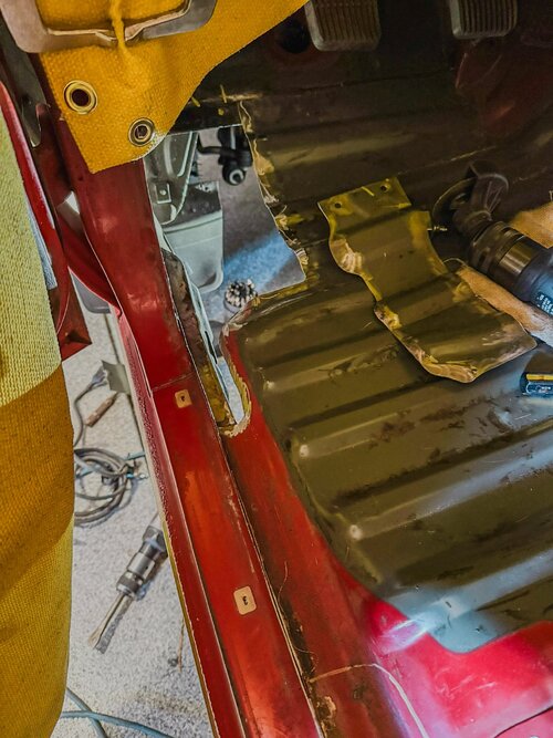

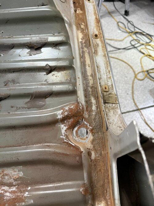

Nope. Called in a pro to help. Thankfully, the rust is localized and didn't seem to reach the A-pillar or within the rocker, so that's a plus. Sadly, the donor part on the driver's side is a PoS and can't be used, which is a blocker.

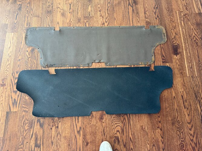

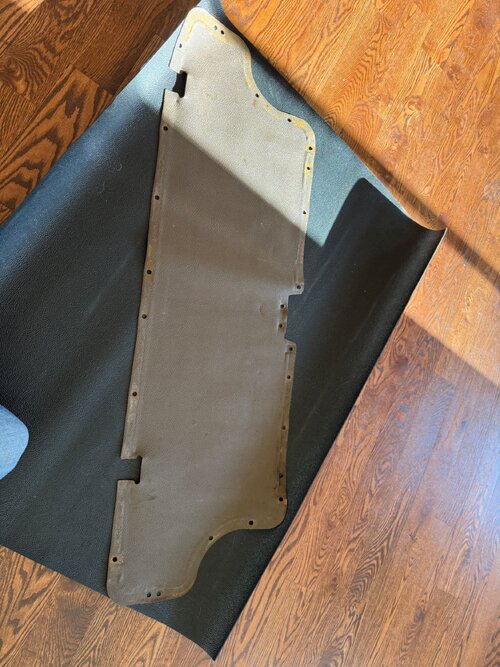

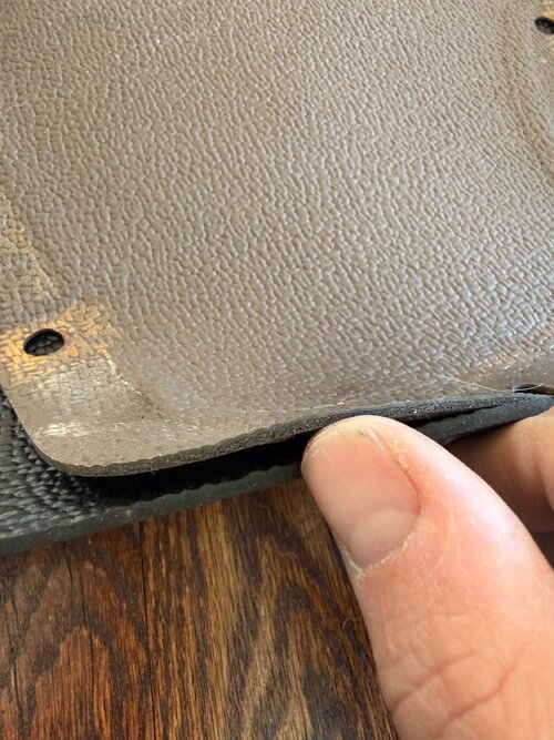

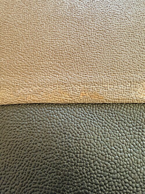

Meanwhile, the interior upholstery continues as well. The bottom of the rear bench had this interesting rubber material that’s like unobtanium in brown. My exiting one is OK, if I’m spending the time, I might as well just replace it. I found a potential suitor, slightly thicker, but should do fine.

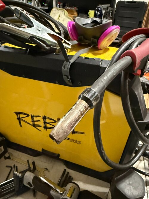

Welding machine is kaput, I do something else.

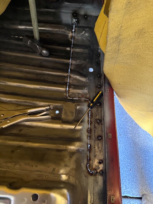

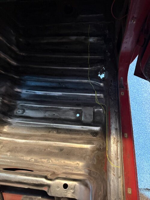

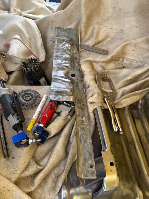

The driver donor floorpan is crap; I should have stuck with my gut feeling, but I decided to bring it home, which means a setback. It'll likely require custom fabrication to make it all work, bleh.
IH8RUST
Jun 13, 2024
403

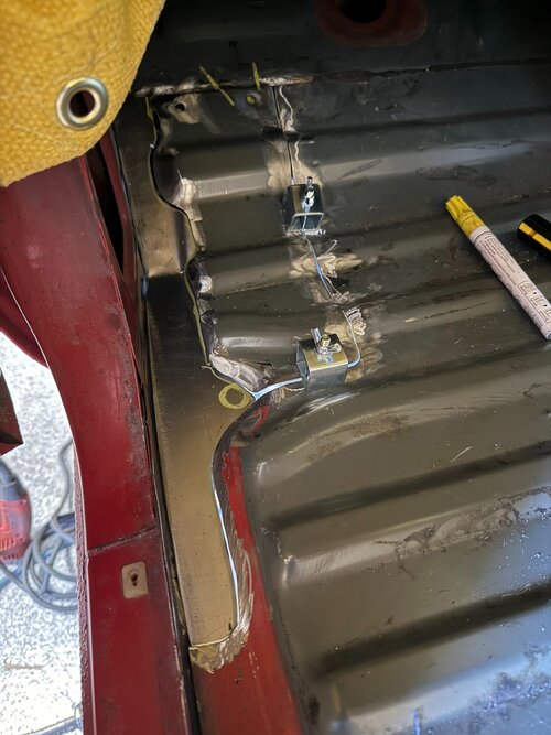

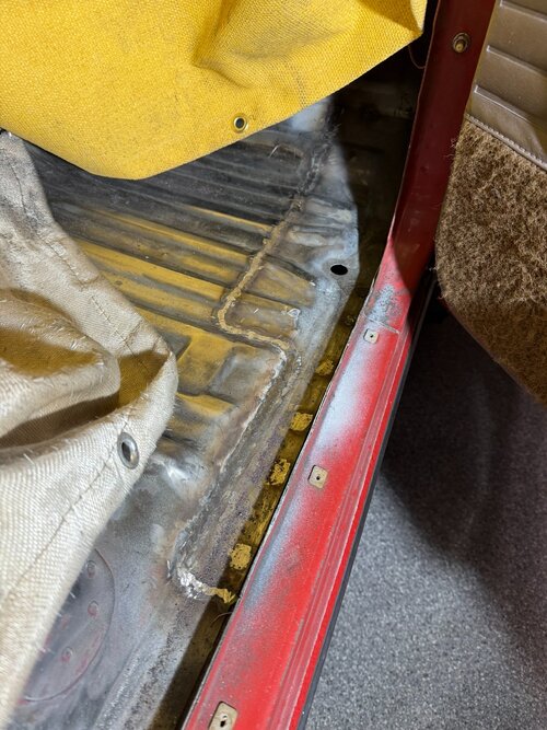

It has, without a doubt, turned into metal fabrication, so instead of cutting a near plug-and-weld, several parts must be cut and welded together to make a single replacement.
IH8RUST
Jun 13, 2024
403

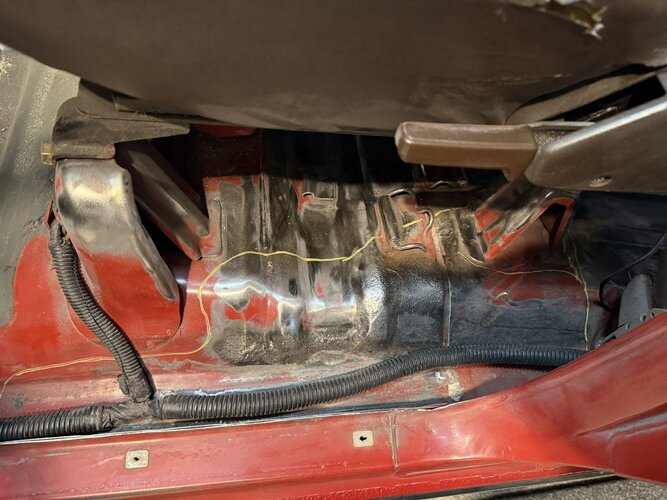

It isn't pretty, but it's close enough. Yes, we'll put a hole right there.
8,020
That area often rusts because there's a leak in the sealer on the firewall that allows water into the cab and it collects in the footwells. Common 60 issue. Could also be the A pillar seam.
IH8RUST
Jun 13, 2024
403

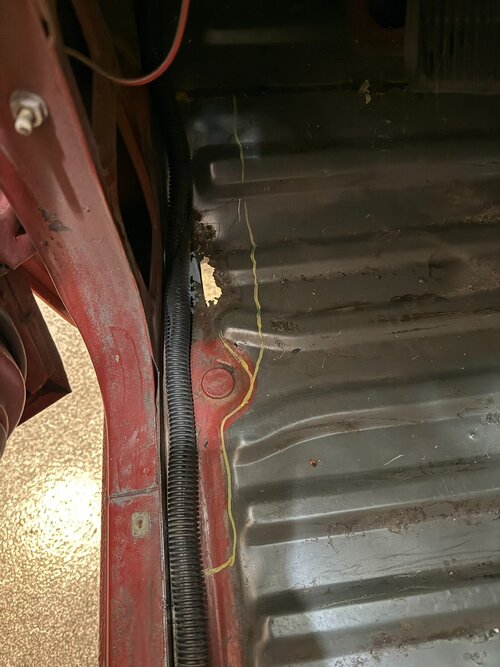

Is there any way I can debug this? I guess just run water outside and identify problem areas while I have it bare bones?
