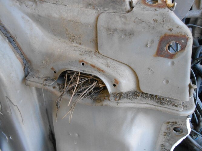

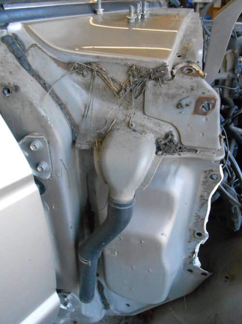

Yes - behind the front fenders are either seams that leak, can leak, or are rusty. My truck was parked under pine trees for years and I had huge wads of needles to clean out. Only because my truck wasn't driven on salty roads for many years did it survive - the behind-the-fender parts were in surprisingly good shape and the caulk was intact. My leaks are at the windshield corners (no matter how many times I have caulked...)

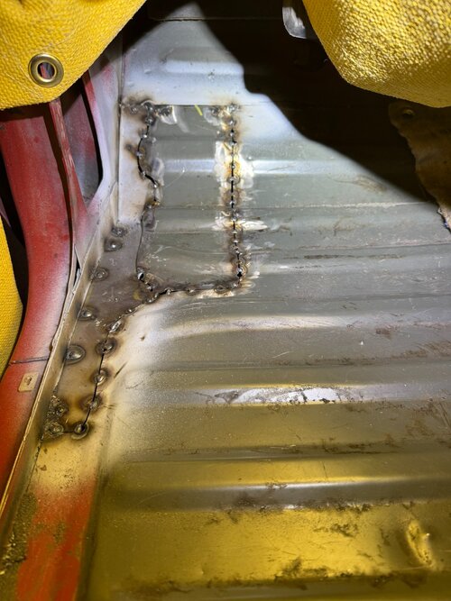

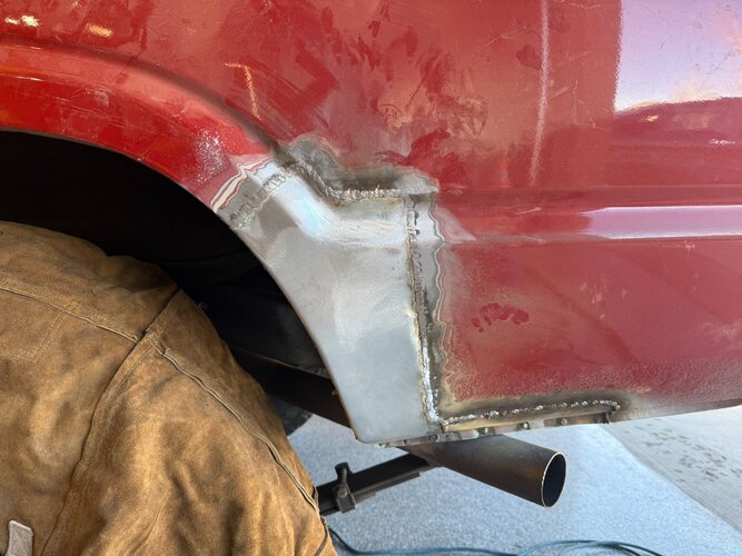

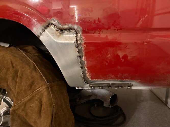

Things that were accomplished in 24 hours.

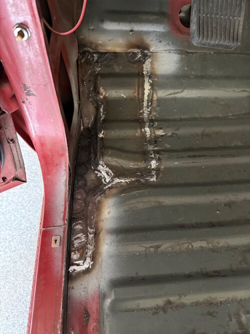

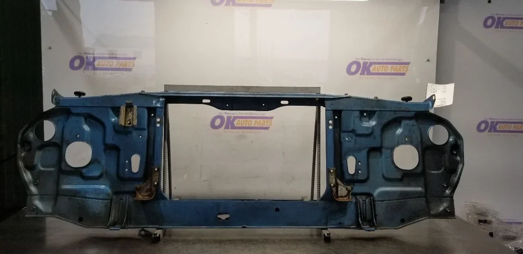

The driver side patch is tac-welded in place; there is still more to do. It was time to figure out what to do with the front radiator core support, since mine is completely rotted, presumably from battery leaks. I already have the inner-fender well, the choice is to pay someone to fabricate or... eBay!! OK Parts had a completely intact, non-rusted, non-corroded radiator core support for sale. And look at that packaging, Man-a-Fre could learn a thing or two from them. This reduces labor since it's now mostly cosmetic work with no fabrication required.

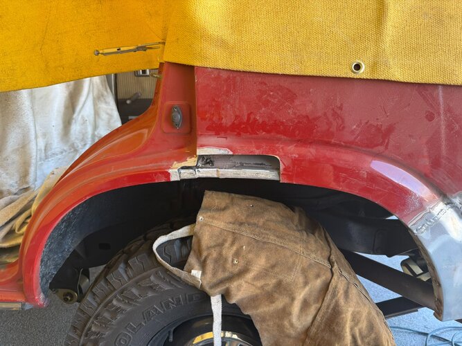

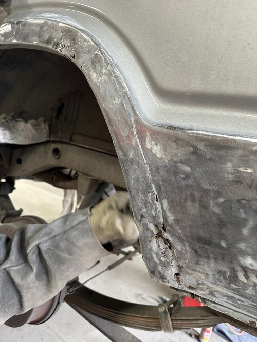

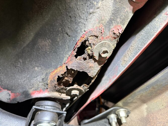

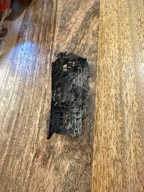

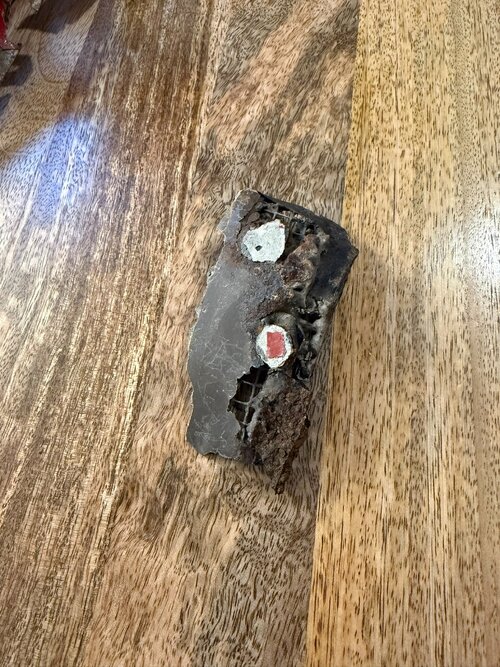

I sure could use a break right about now. We cut through the rear right fender to find the sloppiest Belogna ever. A big, beautiful wire mesh patch with plenty of Bondo to cover the mess. They would have been better off not covering, letting it just rot instead of doing this. I'm upset, and kind of mad at myself for being ripped off.

Here. Typical, right? Like they went out of their way to do a shitty job, and for what?
Two theories now:
  1. I'll find more down the line when it goes through body work; any other spots that haven't yet shown will appear right as they sandblast, so more dollars spent.
  2. Whoever worked on it, approached it the same way elsewhere, and my hope is the rust has had enough to rear its ugly head to let me know where it is, which means these are the only bad spots and I'm OK, but I'm also not very hopeful right now.

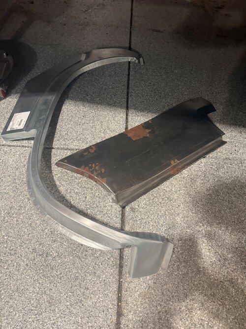

I remember seeing how much work yours had. Also, I guess I had the right idea when I picked up the donors from Cruiser Corp.
Those are 18 gauge, original is 16.
4,647
I bought the Cruiser Corp over the wheel pieces for Bart’s project and Gonzalo made me send it back to them. He judged them too flimsy for the location and cut and formed thicker gauge metal for less money than the CC cost.
