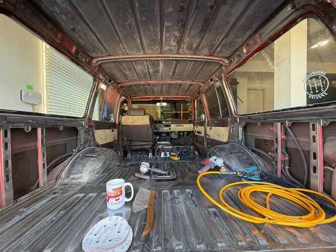

Now that I’ve cleaned it up, the right hand side is far worse. Interestingly enough, the right side of the rig is where the majority of rust has occurred.
Typical.

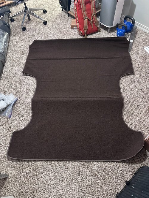

In the meantime, take a look at the previous post. Do I need that Aussie quarter panel, or this fancy carpet kit? Like what? Nope. That should tell you all you need to know about the direction I'm headed now; it is no farm build.

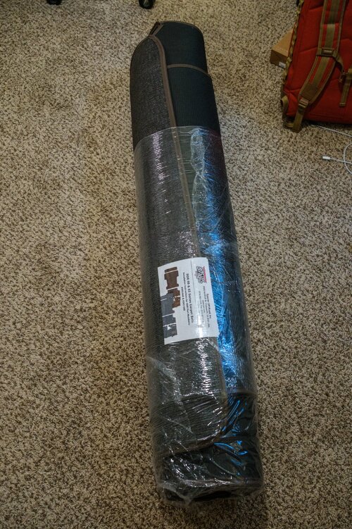

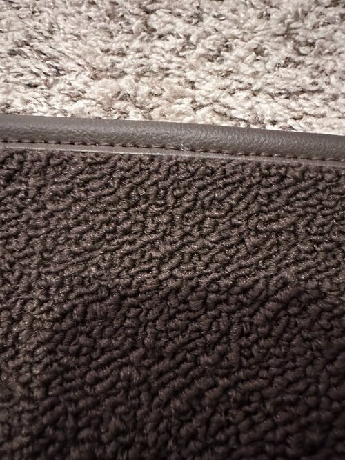

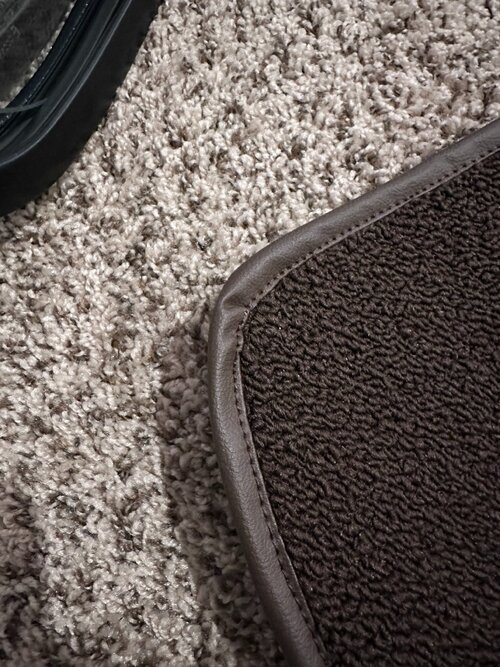

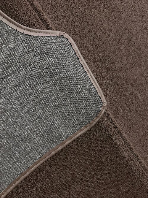

I unrolled the rear section; it's pretty decent, with good stitching, though I can see it eventually wearing out and disintegrating. They used a rubber mat or whatever it's called on the bottom, which would really stick to the felt pad or the sound deadener.

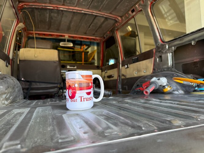

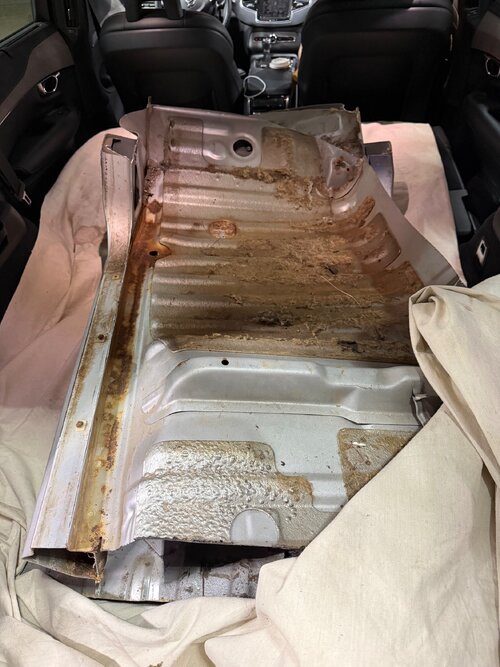

A few days off from this to work, got back in there and did my things for a few hours. I found floor pans with the rocker attached. I plan to cut and weld in January. I am not looking forward to the ceiling; my arms are puny.

Carpet looks nice.

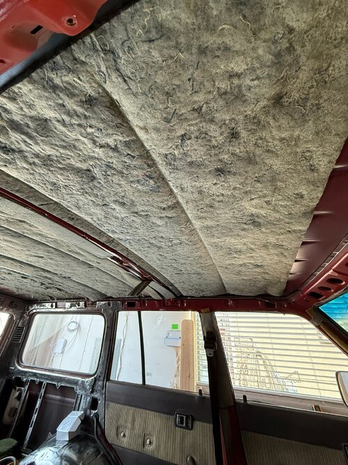

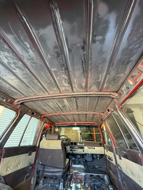

Making great progress. What made you decide to sand the roof interior?
IH8RUST
Jun 13, 2024
403
This stuff.
One way or the other, it had to be removed before the cabin repaint. The adhesive they used was old and flaky like me. I didn't want to leave it there, so I decided to go all in. I used a glass scraper to shave most of it. It'll get a single-stage coat, I'll install new sound deadener, and a new headliner. No one will ever know, except us.

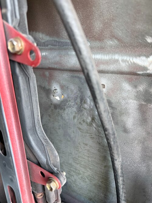

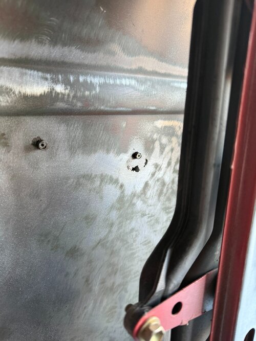

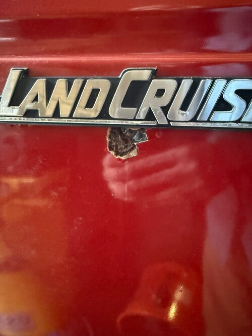

I'm not building as much as I'm finding or making new holes. The pricks bondo'ed over the rust and oversprayed. I have several more significant bubbling in other areas; I guess I'll find the same issues there.
8,020
Yikes, not a good sign. Wonder what you'll find in the rockers, rear quarters, rear hatch and door bottoms? Those are usually the worst areas. Gutters and A pillars too.
I found some bondo in the rear sill of my 40 recently. Luckily that was the only spot they had "touched up", but still isn't fun undoing someone else's dirty work!
