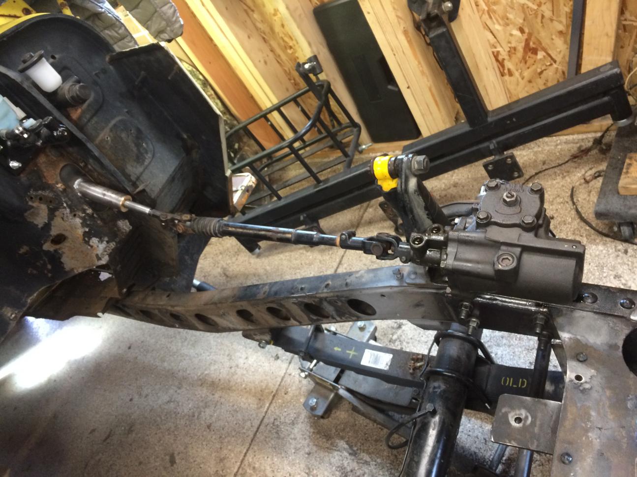

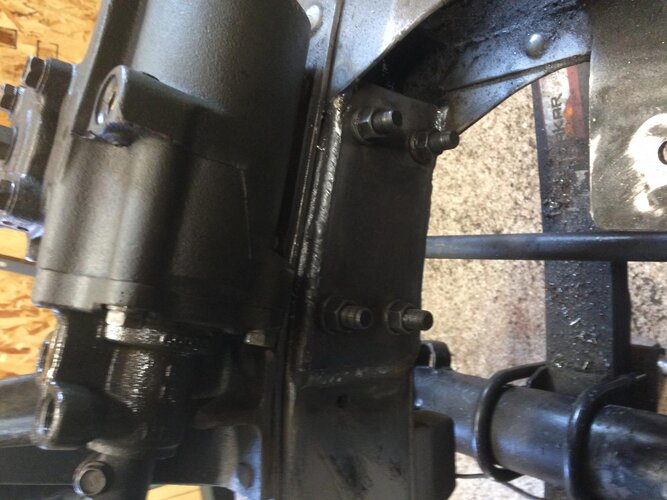

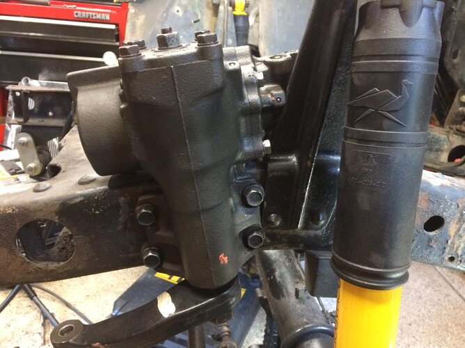

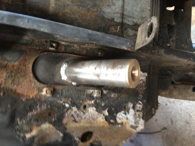

Updates. Adam and I worker on getting the steering on this weekend. I used an 80 series PS Box, a 60 series intermediate shaft thats collapsable, and part of a 2nd gen 4runner intermediate shaft. We cut back the steering column tube and used cruiser outfitters brass bushing for then end. The plate at the firewall is from cruiser outfitters also. We clearnaces the frame for the ps bix bolts that were from the 80 series and welded on a 1/4 plate for strength. Still need a 60 series pitman atm and 70 series relay rod. Turned out great and all Toyota!
