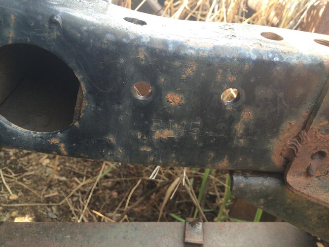

Look at the VIN stamped on the front right frame rail and see if it has a digit in front of it.

Frame rail

There is no number stamped in front of the FJ

There are no other identification plates to my knowledge this early. It also does not have the brass tag. If anyone can shed any light on this I would love to learn more. Is there anyplace I can find out the original specs and time of import running the VIN?
8,994
in da house
congrats, based on the frame # and SOR data it's 8-9/64 mfg probably sold in early 65. I would have thought all the 64 mfg would have the 4 proceeding the vin but i guess not.

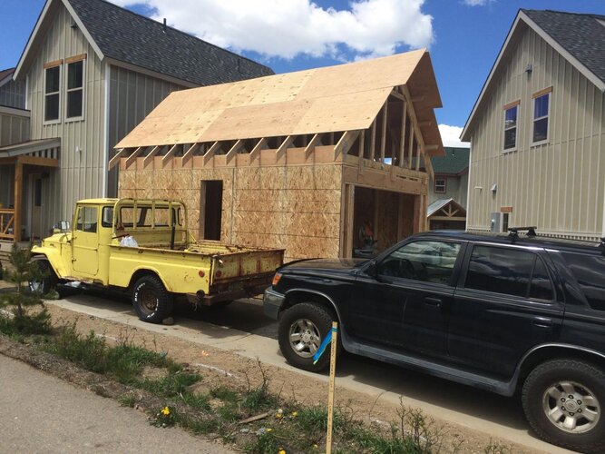

Updates
Well mot much on the 45 but started building it a home!

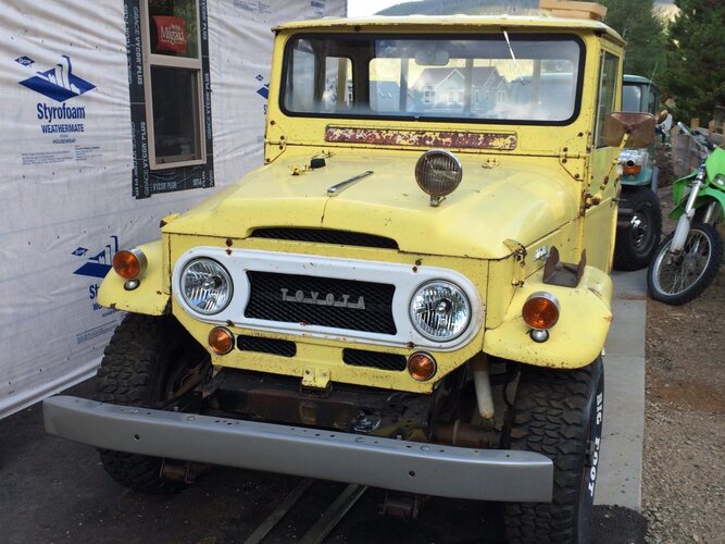

Face lift
Been slowley working on the 45. Here are a couple photos. New light and bumper.

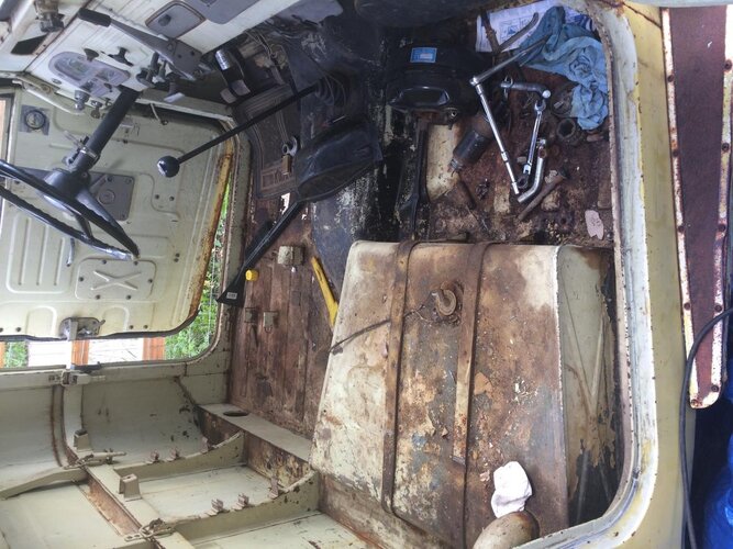

Floor
I got the seats out and upholstry ordered and pulled the tank. Also I picked up a 84 FJ40 front disc axle, 4spd trans, and late matching rear third memeber from Dans. Also picked up some late in er adles for the fine spline so I can run the early housing with late innerds.

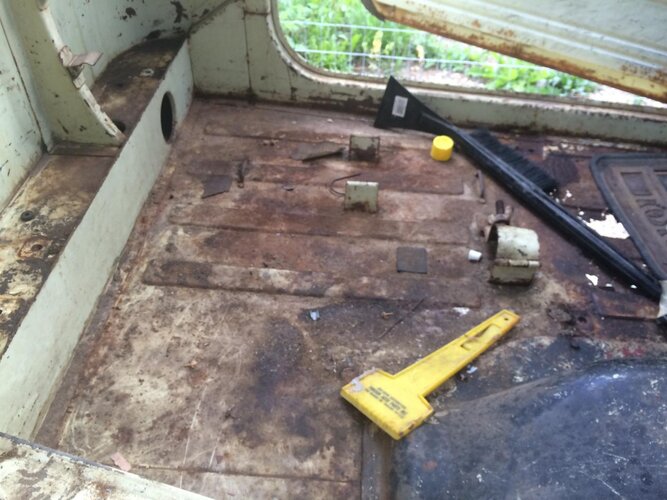

More
More pics

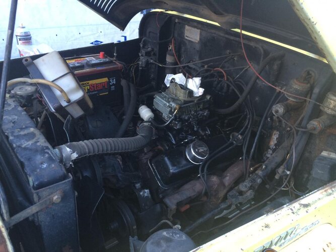

Motor powerwashed
Washed the motor down. After soaking the carb and changing the oil the motor actually runs good. The motor will be available with adapters in a couple months. Putting a 2F in it.
18,189
Looks good. What's your method for washing down a motor? Can you just take it to the self-serve car wash and blast it?
aprosise
Mar 10, 2014
857
He just used some of the spray engine cleaner stuff you get at the parts store, then used my power washer. Seal off the carb and Distributor and you will be fine.
