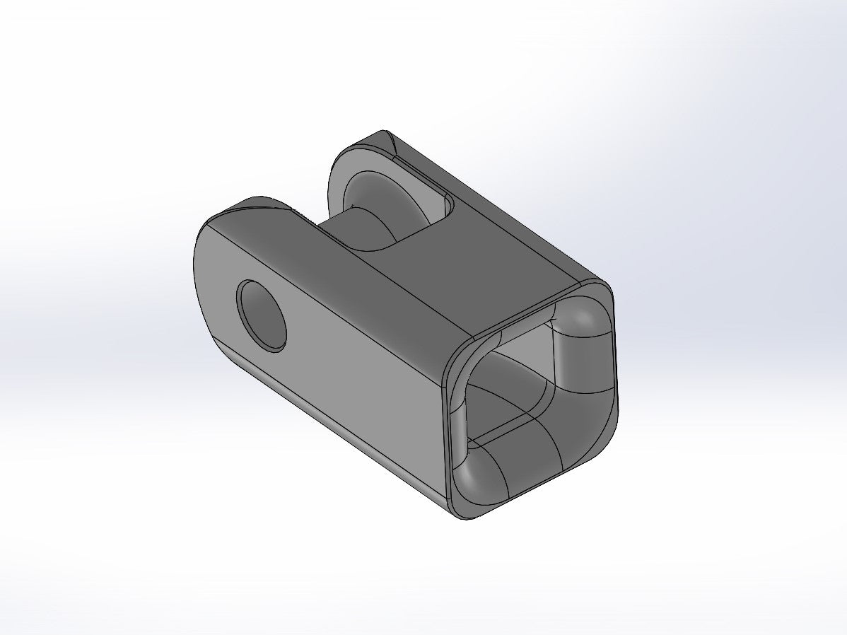

Its not terrible. I would like to see a Working Load Limit for the aluminum, and Working Load Limit and MTS (Minimum Tensile Strength) or MBS (Minimum Breaking Strength for the soft shackle. However, the hitch pin is really carrying the load here while the aluminum is just providing a nice radiused surface for the soft shackle. Good that the soft shackle can be removed and used elsewhere.
Downsides: 1) it does only one job, 2) pin locations vary on receivers so it is possible that the AL part ends up recessed on some, which would be bad. OK if it sticks out a bit.

That soft shackle adapter is made by a person who goes by Metcalf on Expedition Portal.
A 5/8" grade 5 pin has a single shear strength of 22,000 lbf so in double shear it's at least 2x that.
Looks to me like a solution trying to find a problem.
Agreed. There is no reason for this when a traditional shackle serves the purpose. Also, people tend to leave these in, subjecting the soft shackle to the elements, wearing down its life.

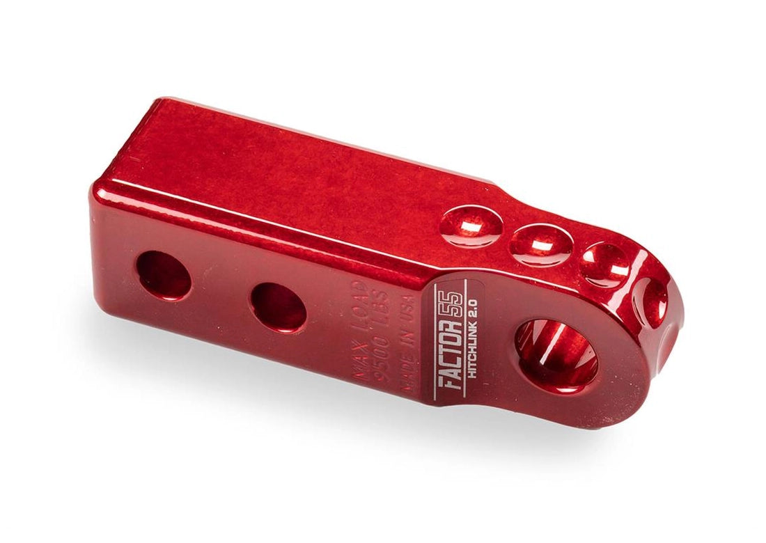

Factor55 has a nice aluminum adapter for comparison. It's intended for a traditional bow shackle. They give it a WLL of 9500 lbs (so appropriate for a 3/4" or 4.75 ton) and design margin of roughly 5.3:1 at 51,000 lbf.
It's not 1:1 because Factor55's is traditional with the block of aluminum in tension while the one above the aluminum is in compression. So the material strength isn't as important to WLL as the pin and rope loop.
In tension I'd take steel over aluminum but in this case a big hunk of either isn't the problem. My suspicion is that in all cases the component that is most suspect is the soft shackle, meaning it's the most difficult to pin down to a WLL and be in known good condition.
I just bought that one a few weeks ago.

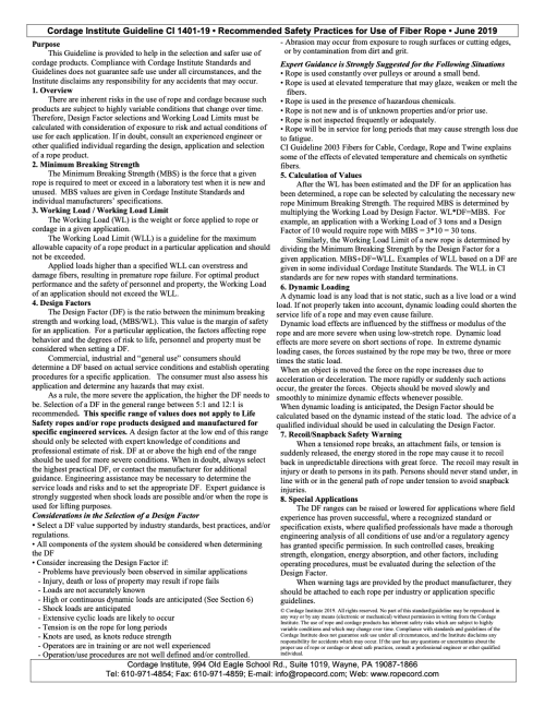

"Soft shackle rating. Doing an 'official' soft shackle rating is not something I want to get into. I've done both destructive testing and a LOT of real world testing. Since every unit is slightly unique in it's construction, it just isn't practical. You can stick a pretty tag on it, but it doesn't really mean much in my opinion. I use quality materials and quality construction methods, including a high force setting of the top knot, and that is as far as I want to go down the rabbit hole. If you need a fancy tag, just buy them elsewhere if that makes you feel more comfortable. There is not a higher quality soft shackle on the market at this price point in my opinion. I do this because I enjoy it, I am not trying to sell millions to the military or something. Soft Shackles, just like their steel cousins, are for all intents a wear item. We aren't logging and tracking every pull or lift on them. Most people have never used a load cell during a recovery. They do wear. They are often abused. They should be inspected and retired as required."
So the gist is "Trust me, I know what I'm doing. But don't actually put me on the hook for anything."
There's design and test standards that apply and installed tags indicating compliance to them aren't just cosmetic. Like the Cordage Institute (what a bunch of chumps, they've only been around 102 years and represent the manufacturers) and their 5:1 to 12:1 recommended design factor.
Cordage Institute International Guideline CI 1401-19 - Safer Use of Fiber Rope
