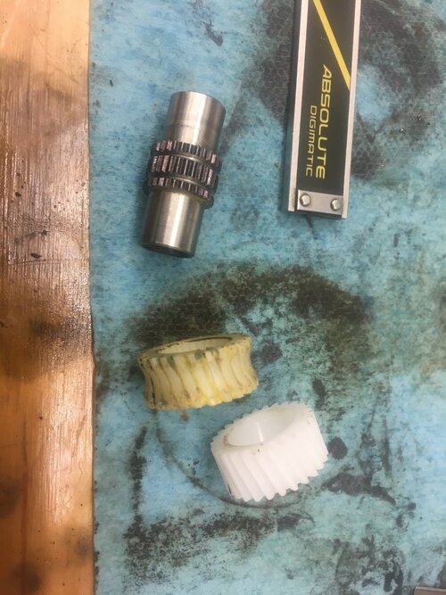

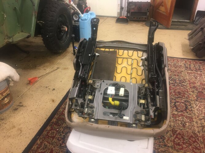

80 series baptism continues with the most recent ritual being a seat gear replacement! After acquisition of some sweet seat gears from the fine folks at www.gamiviti.com I was able to complete the process so quickly that Allison aaaaaalmost bought of on the tale that I went to the garage to load up the bikes in the car!
Ok,ok it took about 30 maybe 45 mins but it went fast and watching the new video was the key:

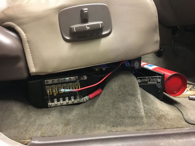

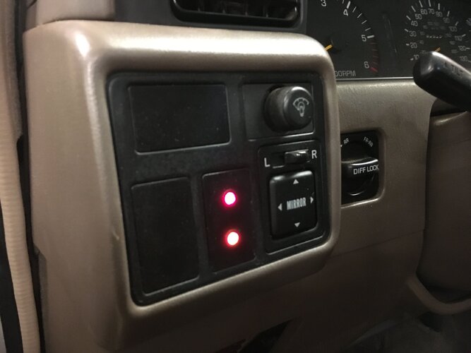

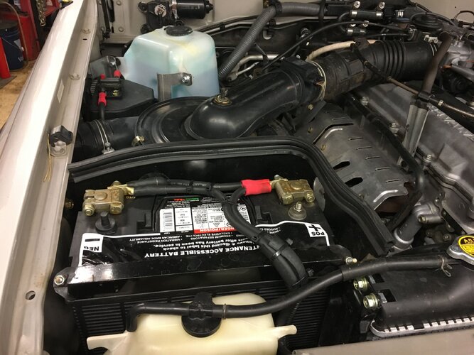

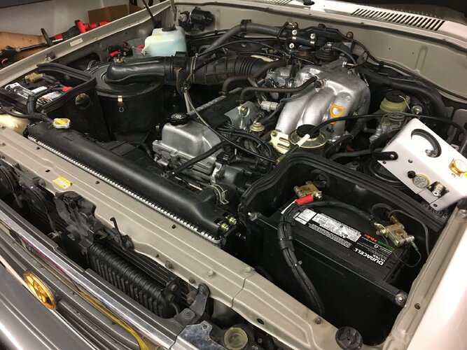

Second battery and aux fuse box installed. Went with 2ga wires to the fuse box and to tie batteries together. This time I opted for simple and went with a 200a relay controlled by the alternator light circuit and a Slee dual battery led monitor thing. Simple. The fridge I plan to get will tell me the second batteries voltage anyways and shut down if the party goes too late. 100a circuit breaker to the aux fuse box and the Slee washer bottle relo kit of course...
Also wonderful how the OEM right side tray fits a group 31! How rad is that? All I had to do was go to oriely and get some long j hooks and fab up a bar for the top.
I Also did the wits end fire extinguisher bracket with a switch for the future fridge. The bracket is a nice piece. No more fire extinguisher either lost in the truck or banging around. And for those wondering yes it’s Halon. Oldie but goodie. This one in particular has put out I think two separate car fires?
