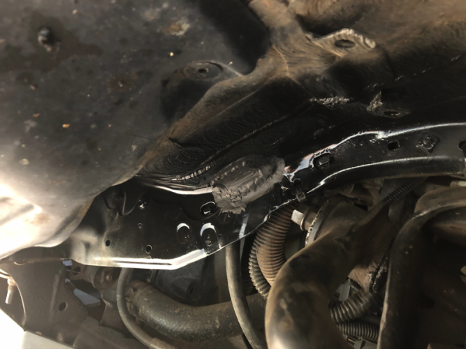

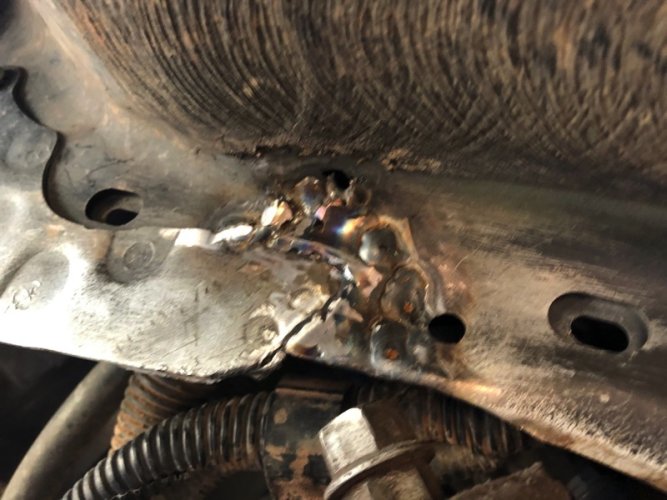

Didn't @Squishy! crack his frame in half somewhere up front in the last year or two? 🤔
Are people reinforcing 3rd gen frames for long travel and big tires like people did with mini trucks when SASing them? It seems like a natural progression to keep welding on more metal 😅
4,225
He discovered cracks, but don’t think the frame was reinforced when it was originally SAS’d. It has been now for sure.
I’d look at Big mikes build on the Marlin forum to see what, how, etc he’s done to his truck.

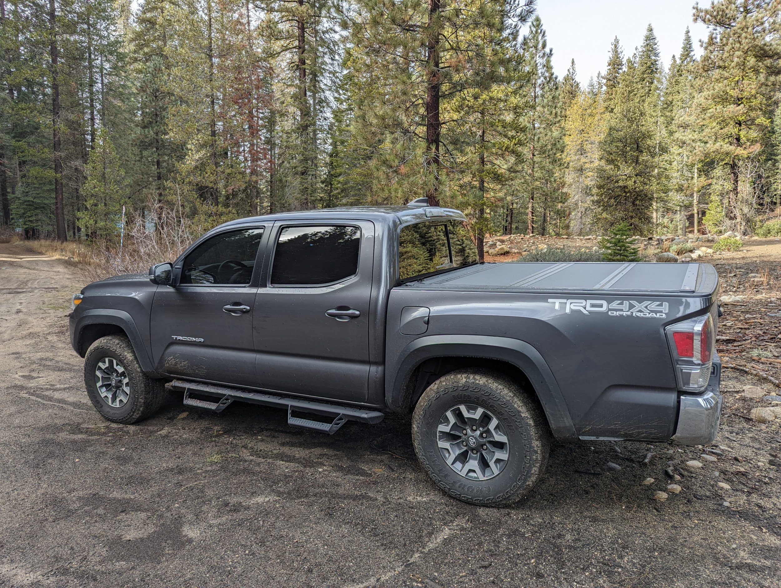

Baby's first 4L and engaged locker!
All of the trails are closed near my parents place (high sierra ranger district in the Sierra national Forest) due to a lack of snow and soupy muddy conditions so I went for a little drive around my parents property on their forest access skid trails. The steps need to go ASAP and I need full skids 😅
It performed very well and can happily crawl along at idle in 4L up a hill doing about 1mph. I did bottom out the suspension on a few big water bars made by the skid steer plow but that was mainly because of over exuberance on my part. Although it would be nice having long travel and air bumps. It would also be nice to bob the bed by about a foot.
I'm still hunting around for an answer on the exhaust reroute being okay for Cali smog. Although I'm not really sure it matters considering there are two braces that tie between the frame and the transfer case cross member that seem to hang down just about as much. Do those get removed when the exhaust is rerouted to have a smooth belly?
