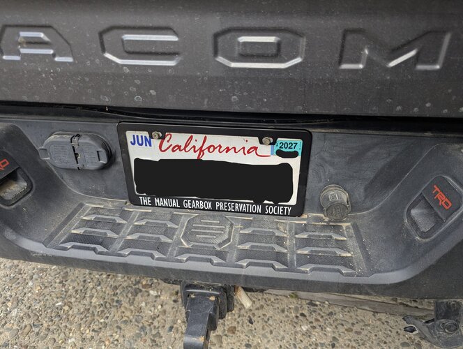

Okay my build is now complete. I found the perfect license plate frame.

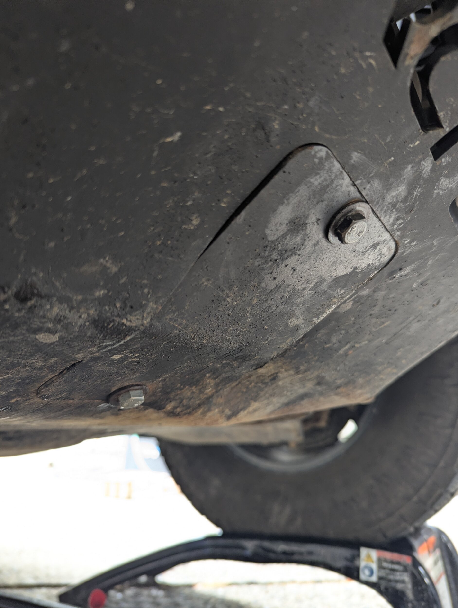

I did an oil change and tire rotation at 35k miles today. It took more time for me to get the tools out and put them away than changing the oil and filter, and checking everything else.

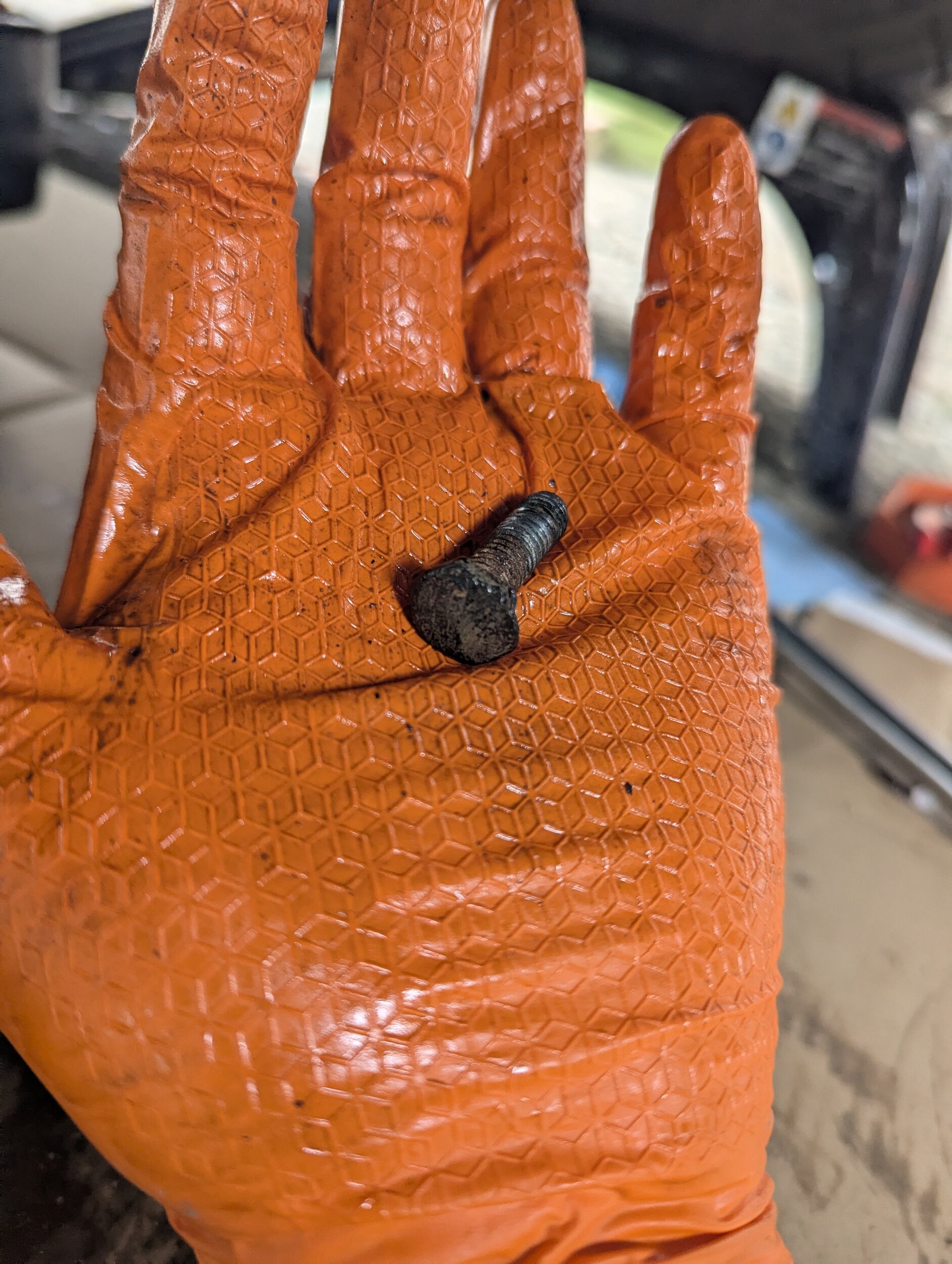

I want to mention one thing I dislike about the RCI 3rd Gen Tacoma steel engine skid plate. And this is the same for the OEM Tacoma TRD aluminum skid plate. The oil filter access hatch has a lower bolt that's right in the line of scraping and impact when I hit rocks on the trail. There's just no way around the design flaw because of where the oil filter is located but it's very annoying because I go through a bolt every oil change after the head is deformed and partially ground off. I'll put some photos below of the issue. The RCI skid plate came with button head Allen wrench bolts originally and now I'm using normal 14mm head bolts because it was nearly impossible to get the button head off one time after most of the head ground away. Usually I'm using a vice grips to remove the bottom bolt.
The photos of the access hatch in place on the skid plate are after I replaced the most recently destroyed bolt with a new one.
Maybe I'm driving my truck harder than the average RCI customer but I can't be the only one with this problem 😅 But otherwise these skid plates have held up to a lot of abuse. A- would buy again.

Most RCI skids plates are "mall spec"
I have found the same with bolts in direct line of fire. Grade 5 or metric 8.8 hex head are totally fine for the application like this.
Personally I also slather anti-seize on them and I do not tighten more than to hold things in place. I find it definitely helps make sure I can take the bolts out, and the thick anti-seize prevents backout by absorbing vibration. YMMV.

The aluminum skid plates definitely would be. The steel plates have held up pretty well overall but I'm just on stock suspension and the stock tire size. When I go to bigger suspension and tires, I'll probably do the front crossmember delete/relocation and then I'll need a different skid plate anyway.
