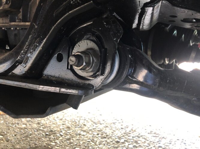

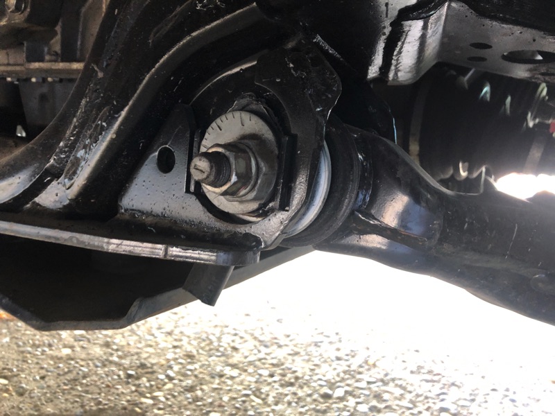

Is this the kit for protecting the alignment?
It's a bit beyond what I can achieve to do that welding. I haven't found anyone out here yet who I would trust with something like that. Is there a bolt on option you're aware of?
13,084
Not the alignment directly, although there is some benefit for that. It's to protect the two tabs on either side of the cam. They are not known for being strong so overzealous mechanics can bend them over. Or they can get hammered by a rock.
I did the Marlin because, well, I like to support them when possible for everything Marlin has done for me.
But also it's a small skid under the bracket and funnily enough I had caught the rear driver side on a rock and peeled it open slightly. It's a spot where no plates really cover and I had first hand experience needed some. So it solved a couple of problems for me.
The Total Chaos kit beefs up the tabs themselves and would be quite a bit easier to weld. Marlin's kit works with these super thick tabs and I plan one day to cut little strips to backup mine. Someday. Understand that the easier weld comes with a price that you have to drill out 3 spot welds and chisel the factory tab plate off first.
