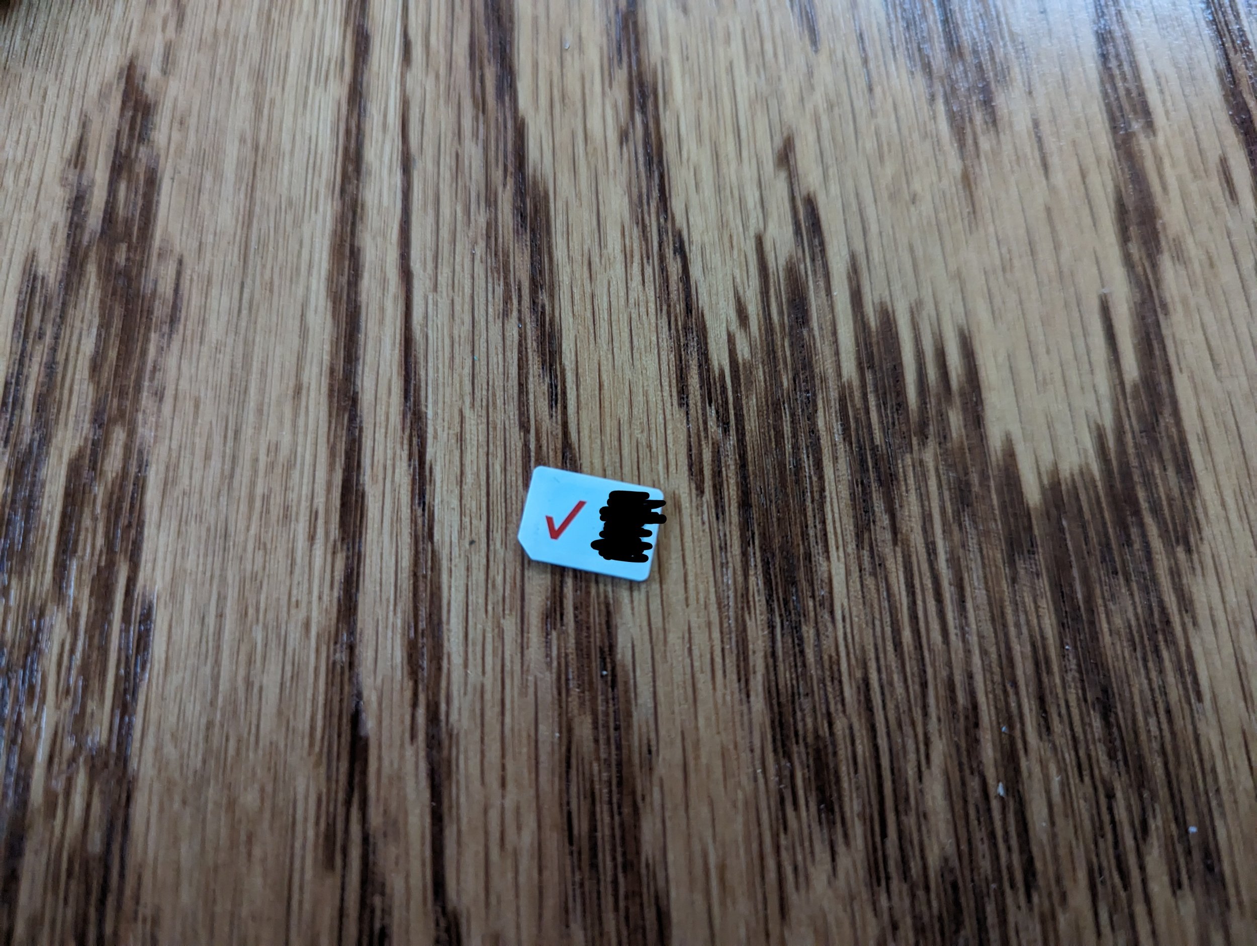

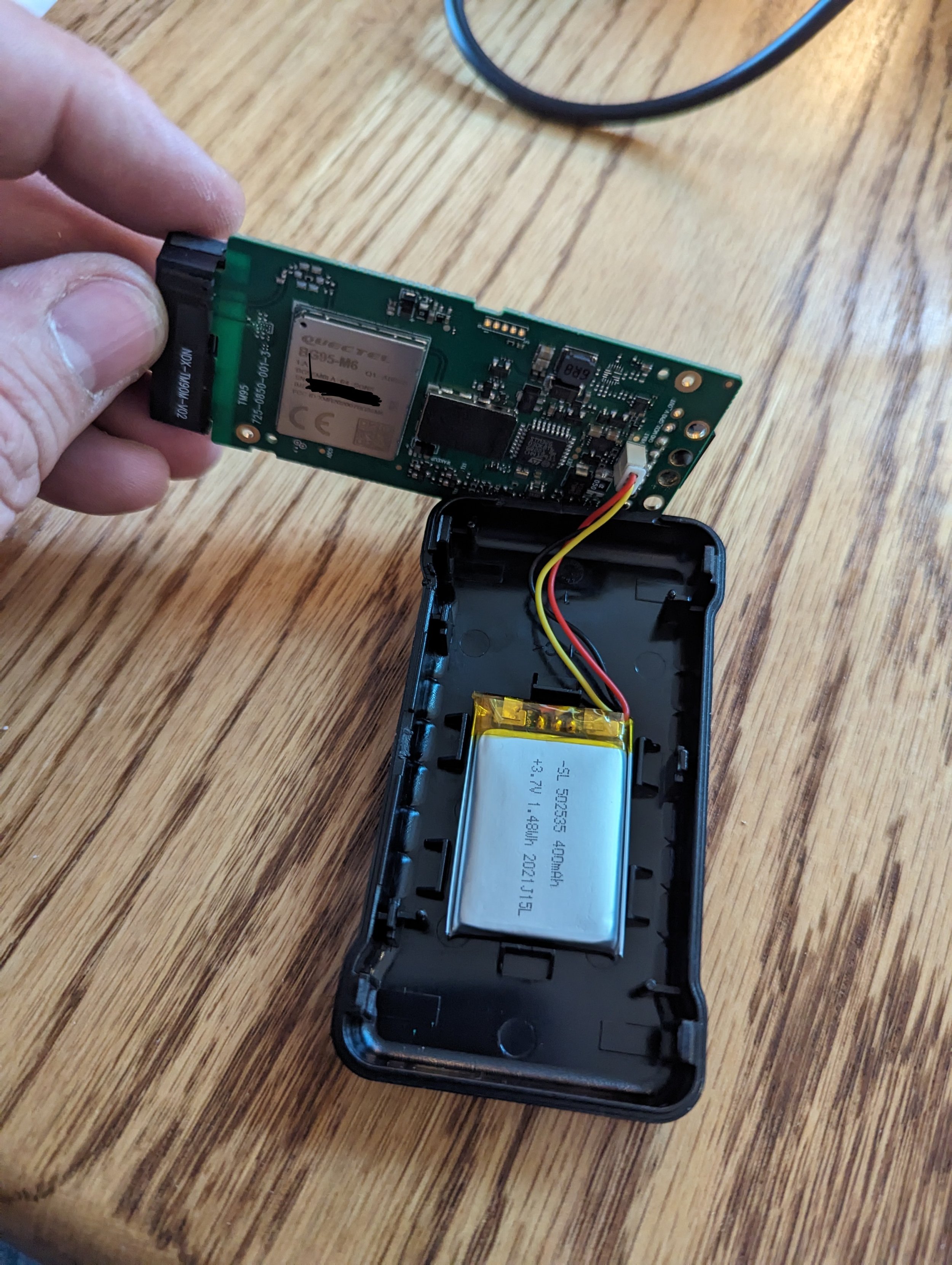

Here's some close up photos of the guts of the StarGard SG950MV.
I wonder what fun things I could do with that micro SIM.

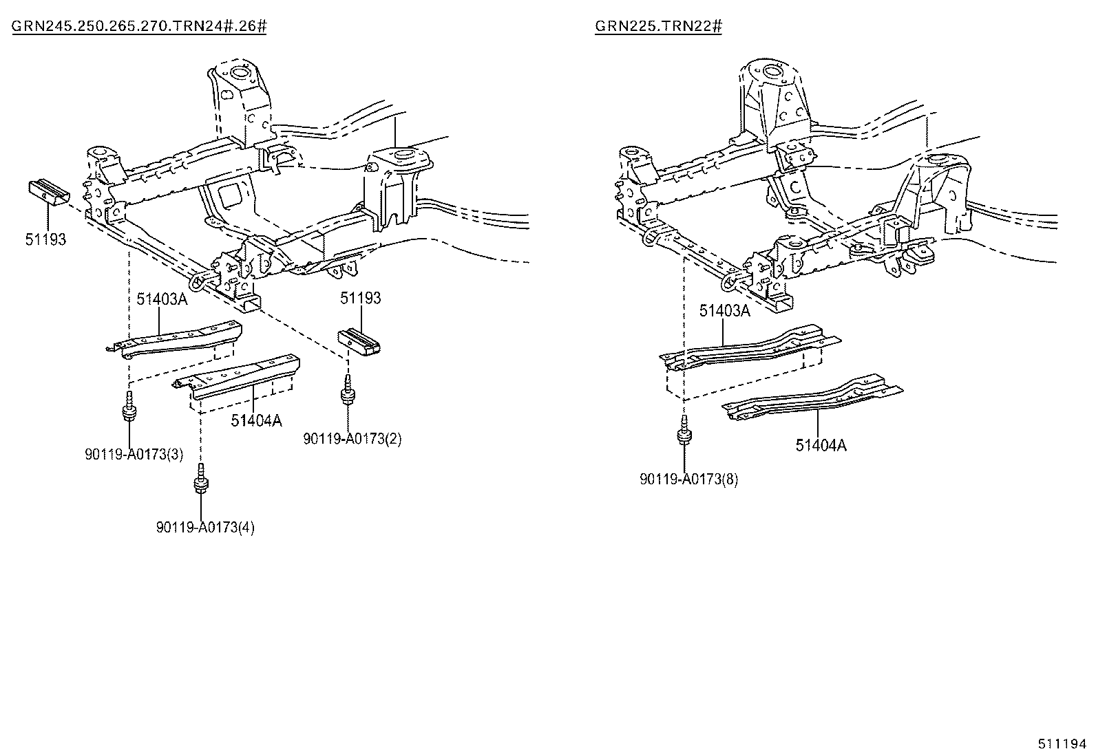

I need one of these bolts. Anyone know what it is? The directions from RCI indicate it's an M12 and I'm guessing it's fine pitch thread.
I'm out of shape so now I'm tired after manhandling that skid plate into place. I'll work on the sliders tomorrow after work.
14,274
All Toyota bolts are JIS, thus end up either fine or super fine metric pitches. In this case it's super fine, M12-1.25 x 35mm long on mine, not including the captured washer.

Do you have any idea what the Toyota p/n on that bolt might be? I've tried looking through the Toyota parts database but haven't figured out where they give the bolts.
