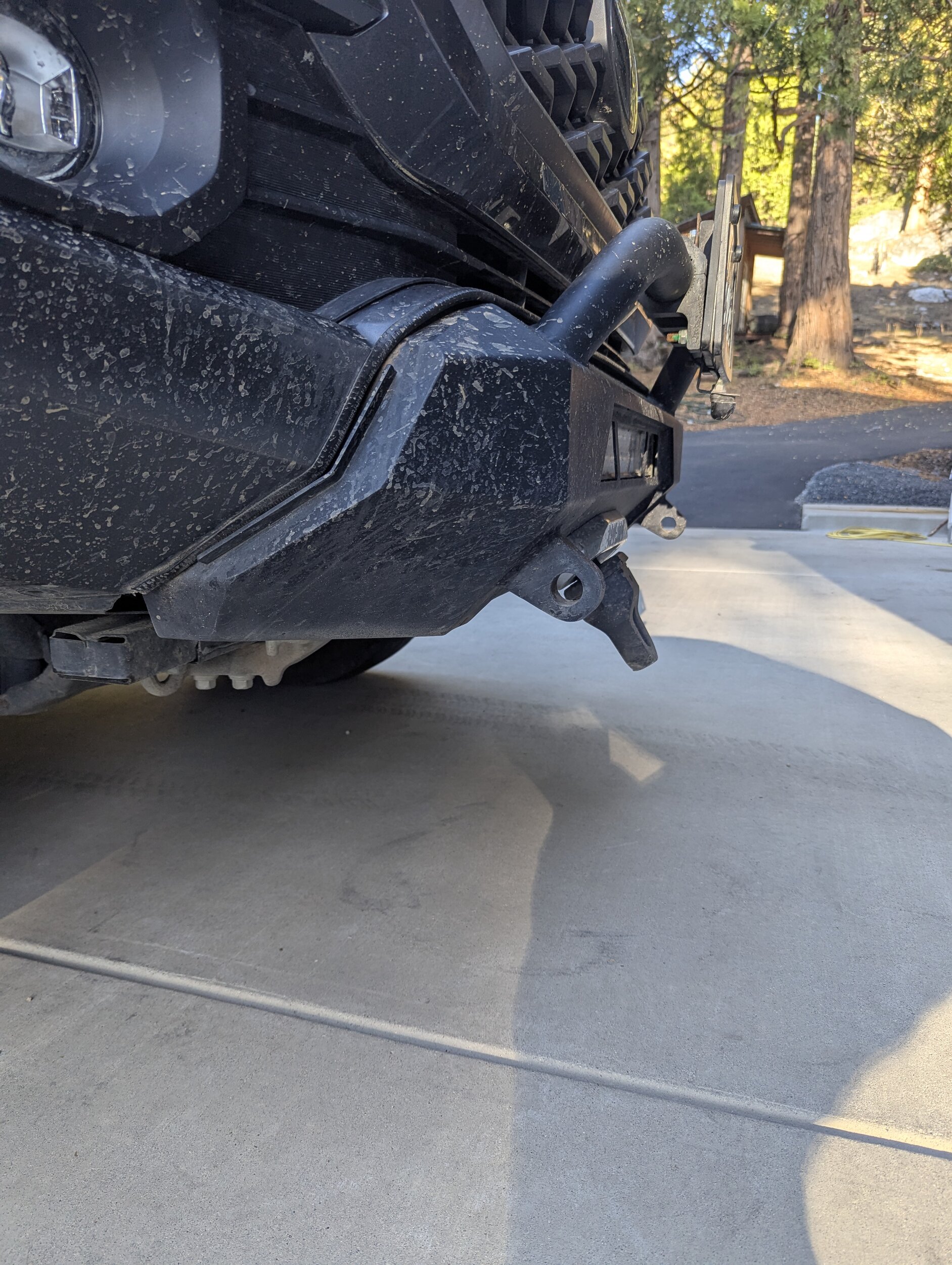

I really need to figure out a better solution for the front bumper and winch thimble/hook situation on my truck. The fairlead points down at an angle off the front of the bumper because the bumper is a dumb design. It's a Body Armor Hiline bumper. This makes either the thimble / hook or the fairlead the lowest part of the bumper.
I currently have a thimble from Harbor Freight on the end of the winch line to protect it from the sun. I previously had a hook which exposed the end of the winch line to the sun. I have been thinking about sucking the winch line back into the bumper and running it without anything but the fairlead would then be what contacts the rocks first.
I keep jamming the thimble onto rocks when there's a steep approach angle. If I didn't have the thimble, I'd be grinding the synthetic line or the fairlead.
If I had the equipment and expertise, I might cut up the bumper where the fairlead mounts to recess it and make it perpendicular to the ground. But I don't. Although perhaps I could learn. There is space behind the bumper and before the winch to do just that.
Or I could get a different bumper which I want to do anyway to give myself much better approach angles.

Here is what I'm talking about

I'm planning to buy a Backwoods Overland front bumper for several reasons including it's fairlead placement is more protected and perpendicular. Plus the winch is maybe as visible as on an ARB but it's lighter weight with an aluminum shell. That's my $0.02 planning if it helps.
At the same time modifying what you have might be totally doable. An alright welder that will definitely work is around $300-500 at Harbor Freight. Youtube has a lot of pro welders that have great content for beginners. The fairlead is a low load portion of a winch bumper. Also I'm happy to help if I can. In addition to all those reasons it being doable, you'd also have a chance to learn a new skill that can serve very well in the future.
Allen
14,252
Is it though in that pointed down orientation? Even a straight ahead pull is putting all the force on the top of the fairlead. Normally the winch line comes out in the middle the throat and in that case I would agree the fairlead is under no stress unless you pull way off center.
As an aside this fairlead orientation will also ask the winch line to always pull over the fairlead, which can't be good for the fibers either.
People dog on the ARB for being ugly and heavy but at least there's no question the winch is protected and supported, the fairlead is oriented right. And you're gonna distort your frame horns long before the bumper fails or pulls off the truck.

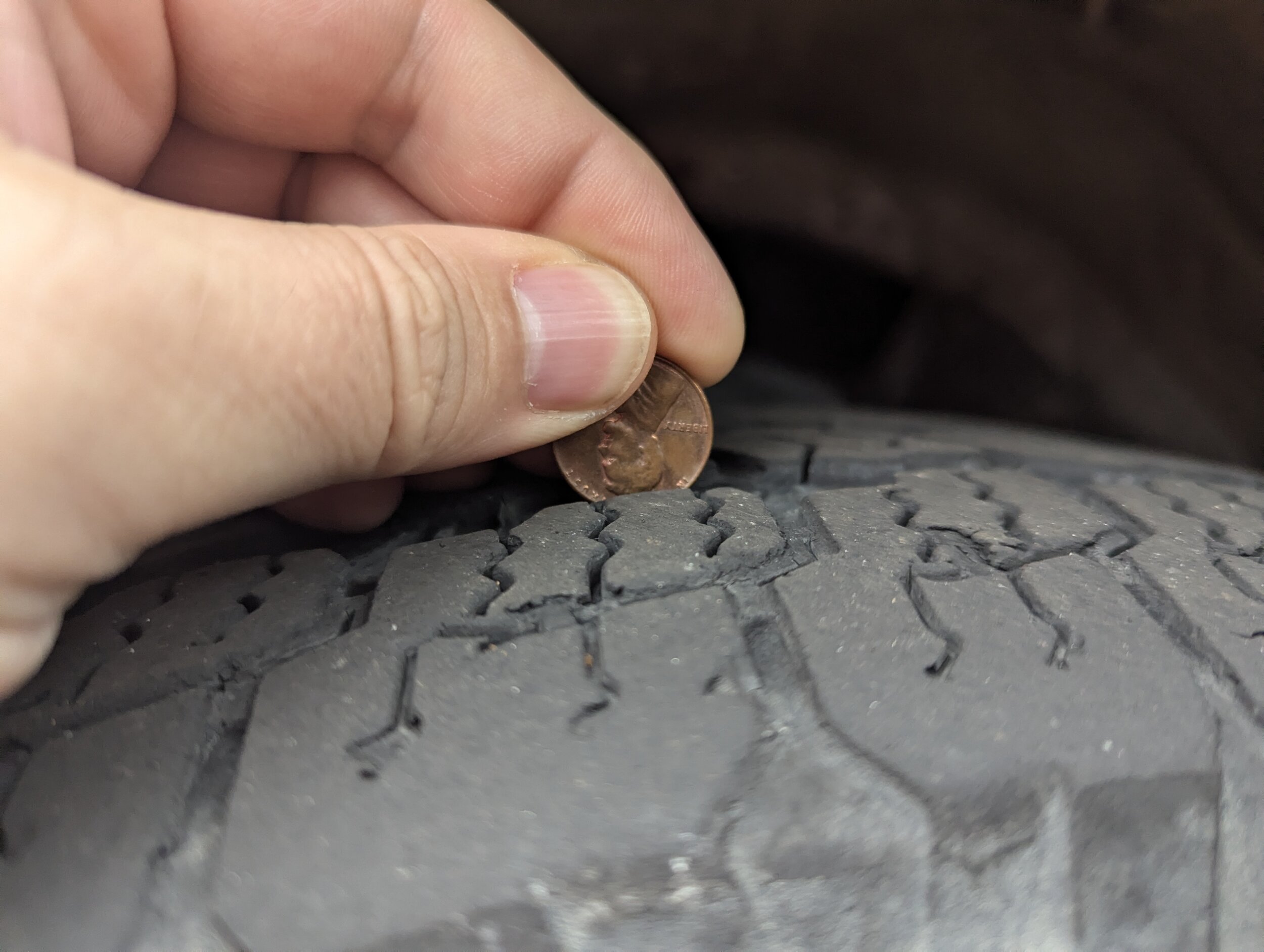

tl;dr: What tires would y'all recommend I get?
I probably need to get a set of tires by Thanksgiving for my truck. The original tires from the factory are still on it (Goodyear Wranglers) and while I haven't hit 30k miles yet, the tread depth is getting a little low and three out of the four have slow leaks. We're also thinking about doing a bigger trip in December out to Death Valley and around, and I'd rather have a set of tires that isn't full of plugs and patches for the trip.
The truck is still all stock suspension and considering I've been working but not getting paid for the past month and with no end in sight to that situation, I think I'm planning to keep it that way for the next set of tires. That means getting a set of 265/70R16 tires.
It would be nice if I could get a mud and snow tire for winter driving or at least something that'll allow me to skip tire chains when we're in R1 chain restrictions in California.
The two big tire chains in my area are either Americas Tire (Discount Tire) or Costco. The closest Big O Tires is a bit over an hour away. The closest Les Scwhab Tire is about an hour in the other direction. There is a Walmart tire center in the area although I generally try to avoid having to go to that particular Walmart.
There are a bunch of independent tire shops in my area that sell various brands of tires but I've been served well to buy from big chains in the past when it came to getting a tire replaced for free while on a trip.
The spare on the truck has never been rotated into the mix as far as I'm aware. I plan to keep it as an unused spare so I only need four tires.
What is everybody running these days? Are there any great tires or any tires that I should be staying away from? I haven't had to buy new tires for a truck since I lived in Colorado almost ten years ago so I'm hella out of date on my tire knowledge.

They've done well other than getting a somewhat significant gash in the tread that I had to patch with a number of bacon strips. I'm still not sure if I ran over a piece of metal or if it was just a sharp rock.
The OEM tires haven't done very well in the snow and ice though. Even when they only had ~5k miles on them, they did not have much traction in those conditions. But I only encounter that maybe 10-15 times a year so it's not a huge driver of tire choice beyond needing M+S rating for chain control.
