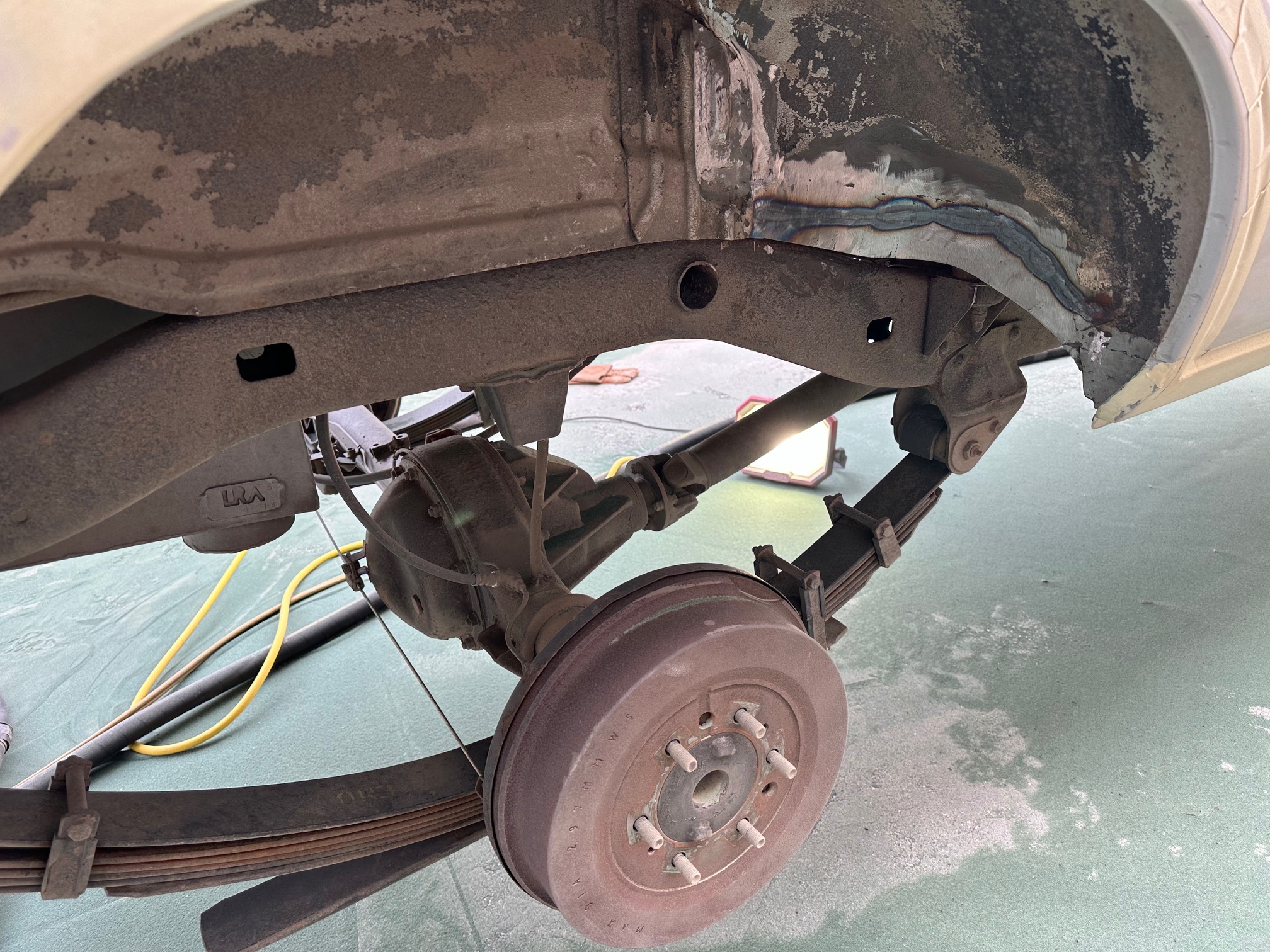

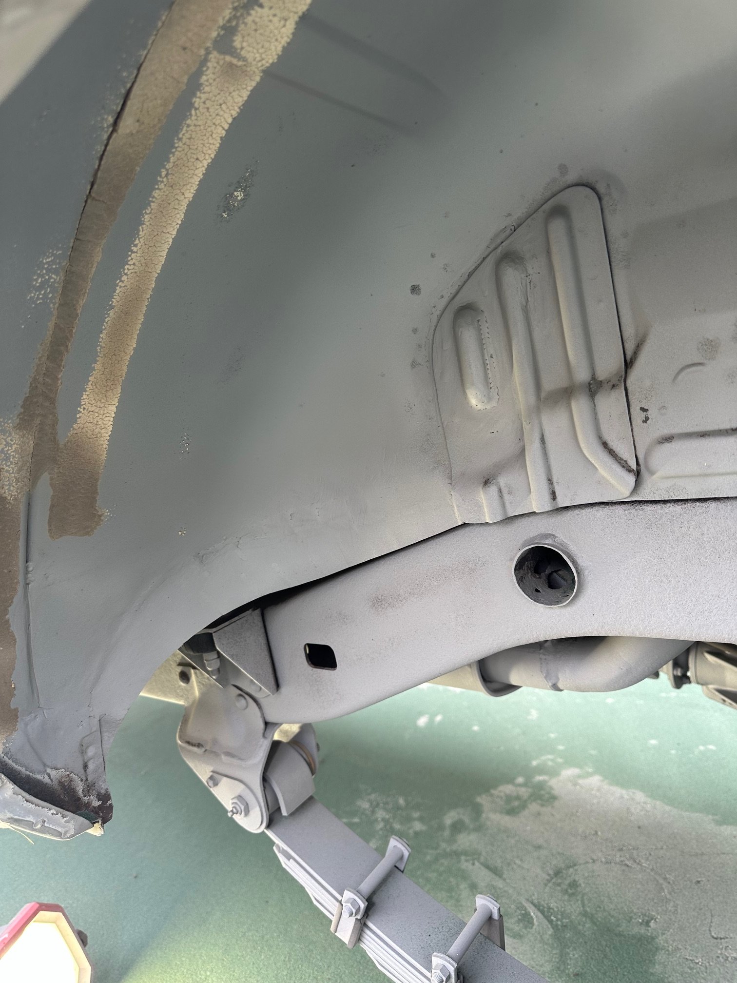

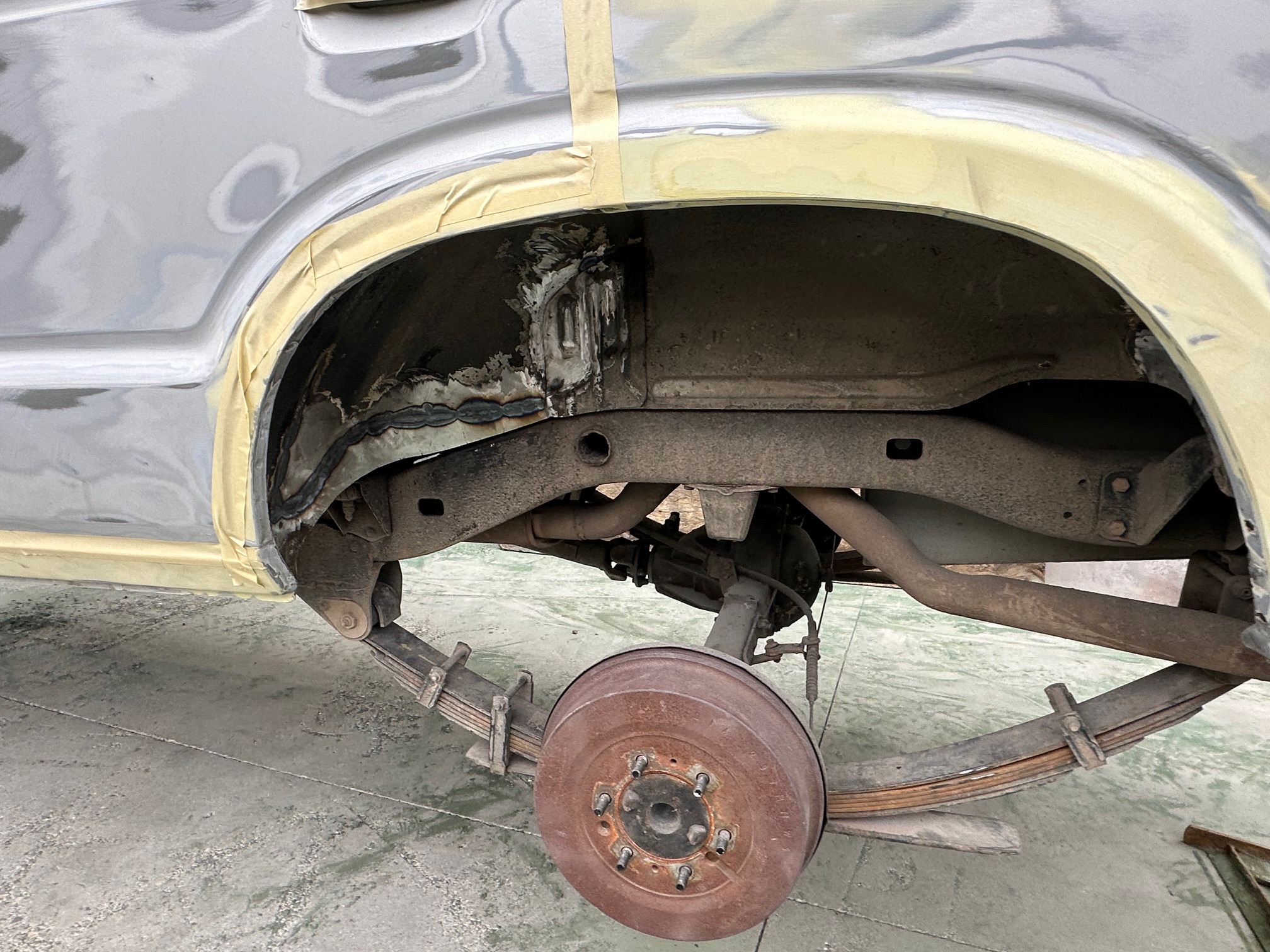

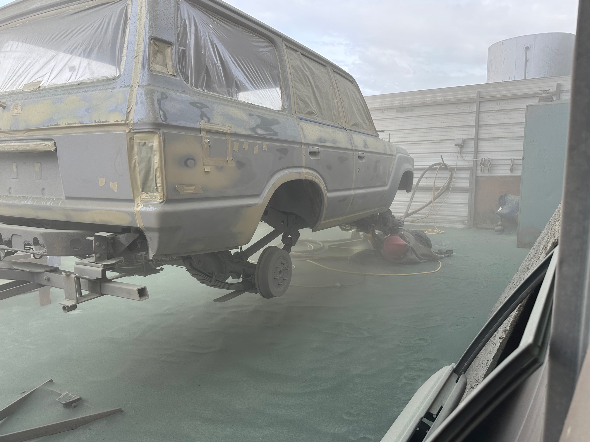

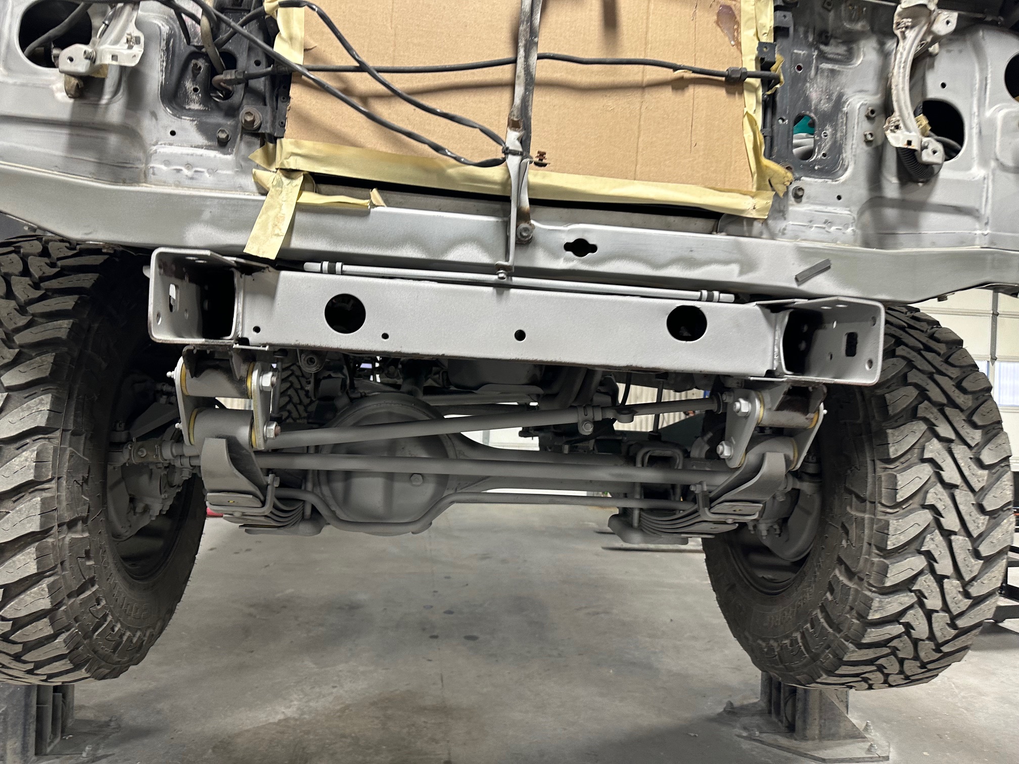

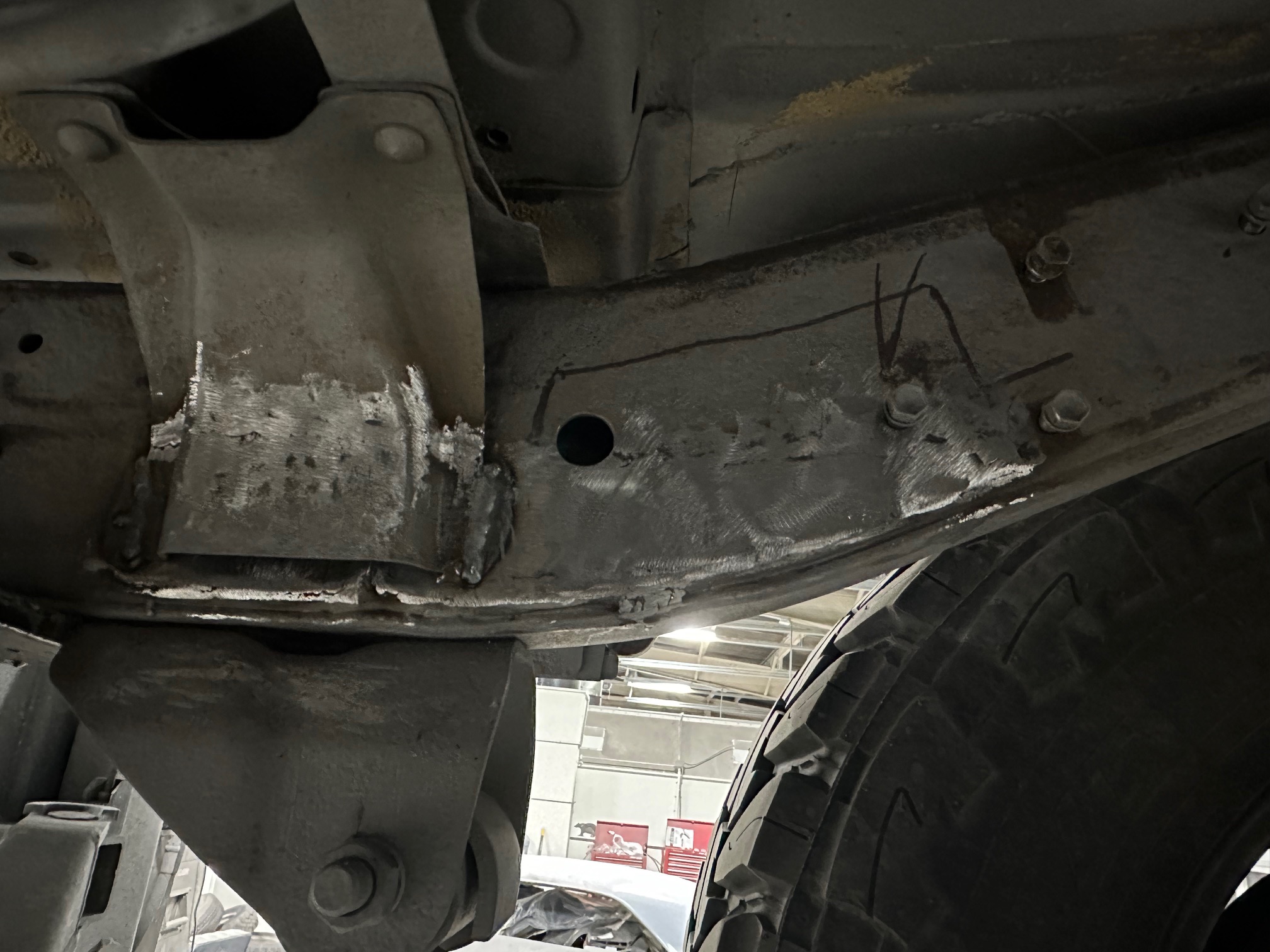

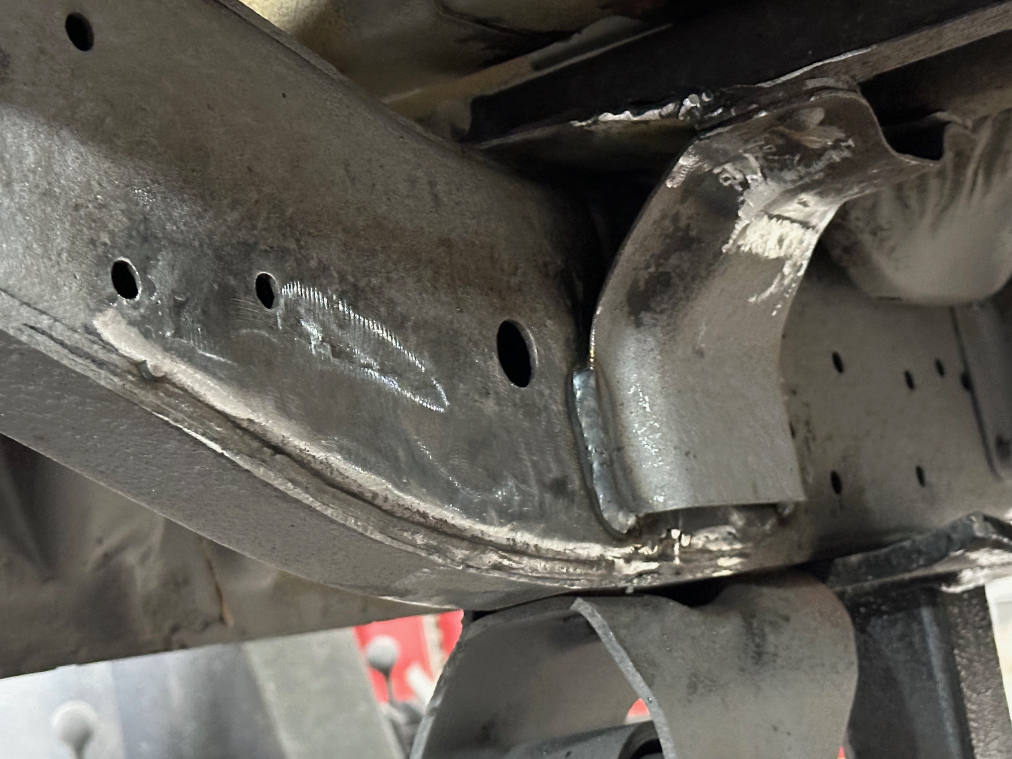

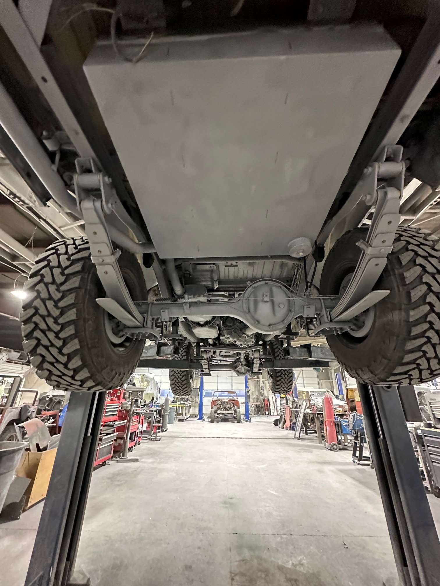

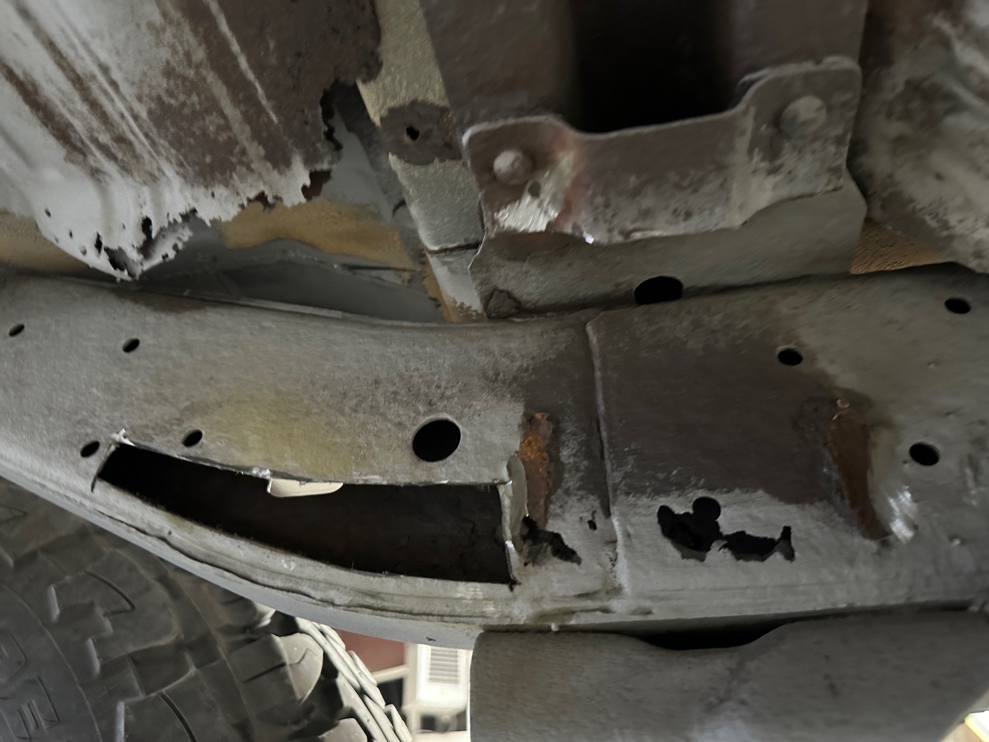

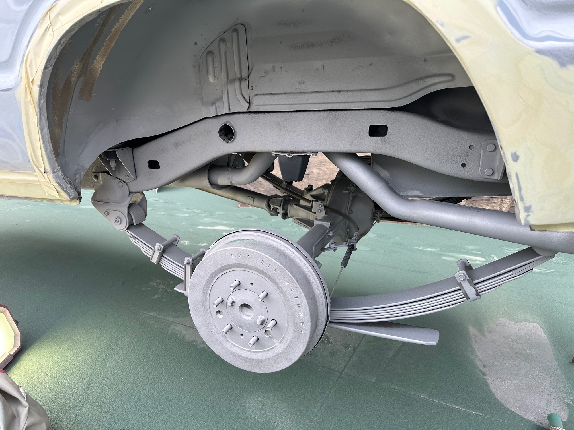

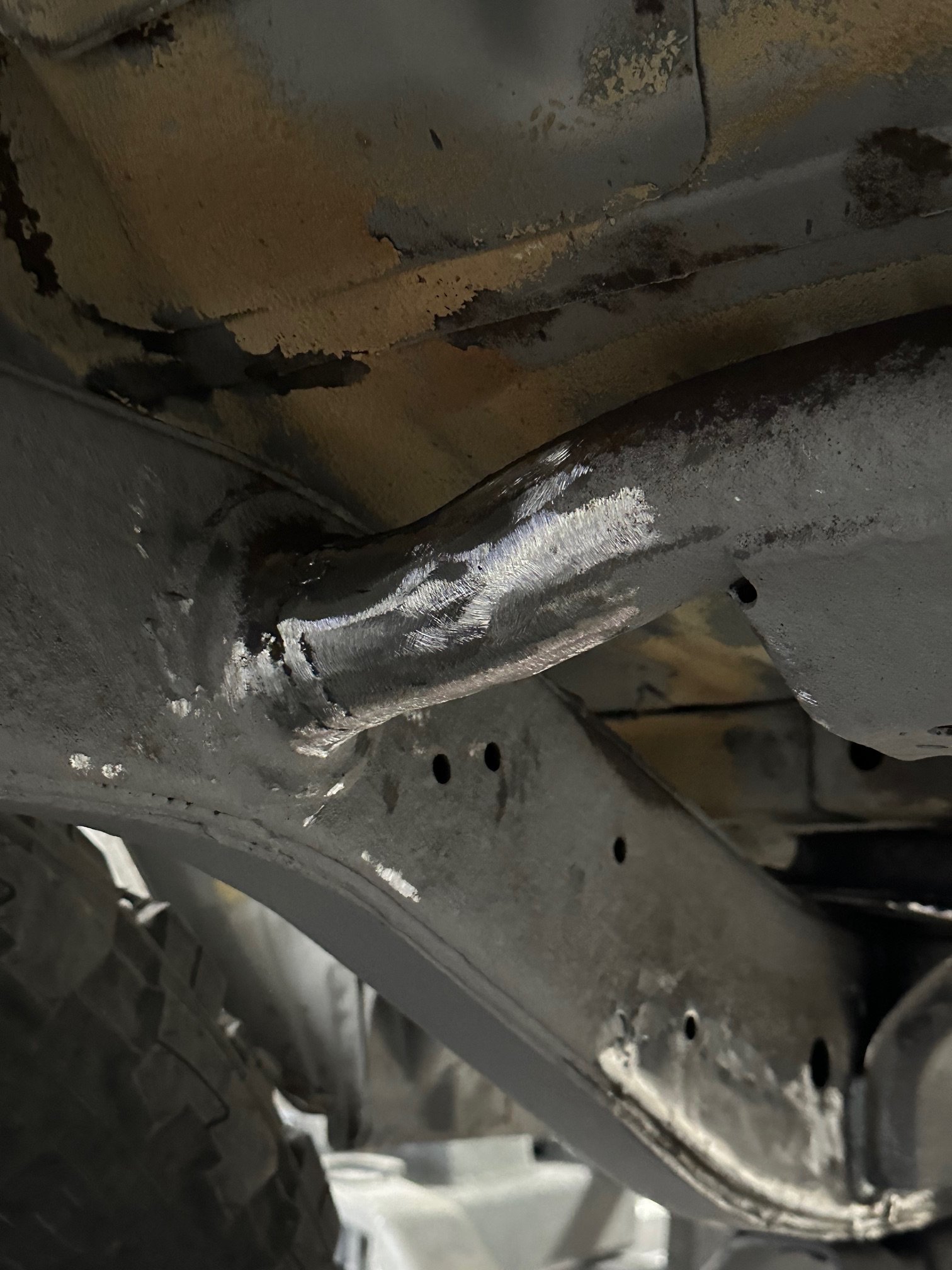

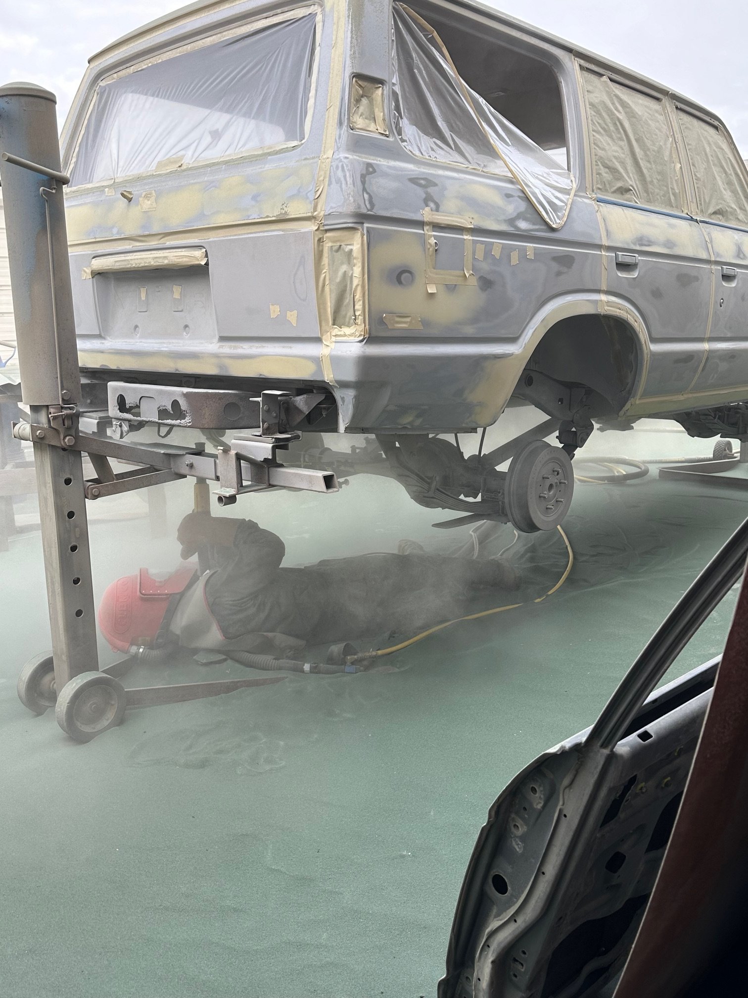

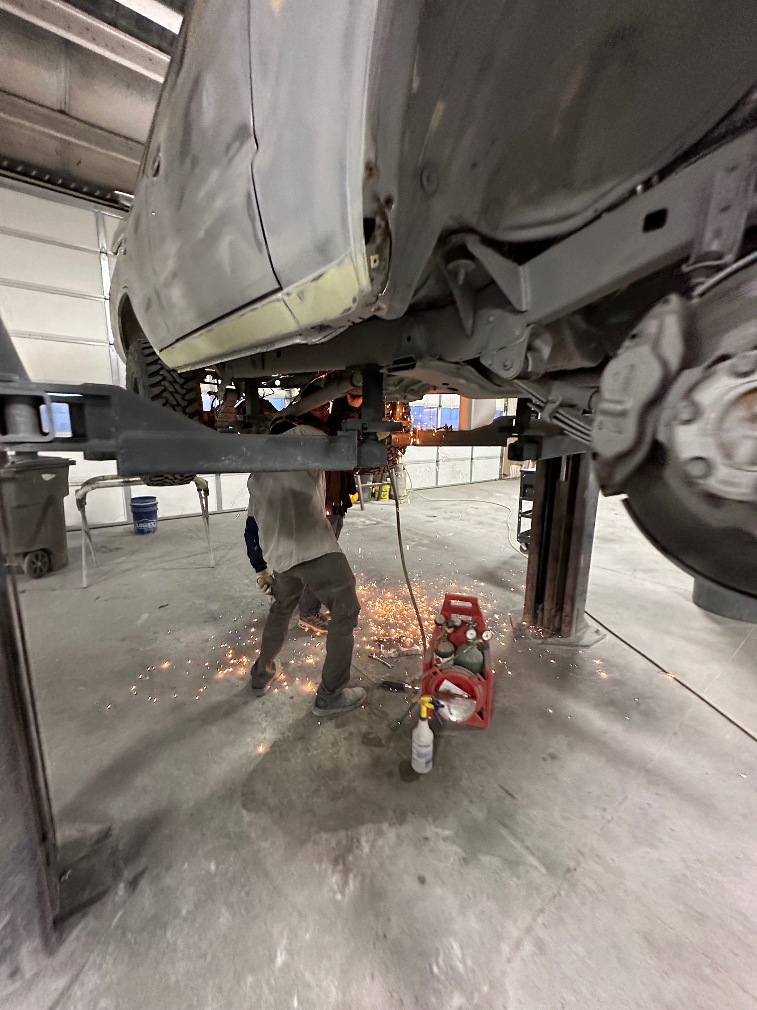

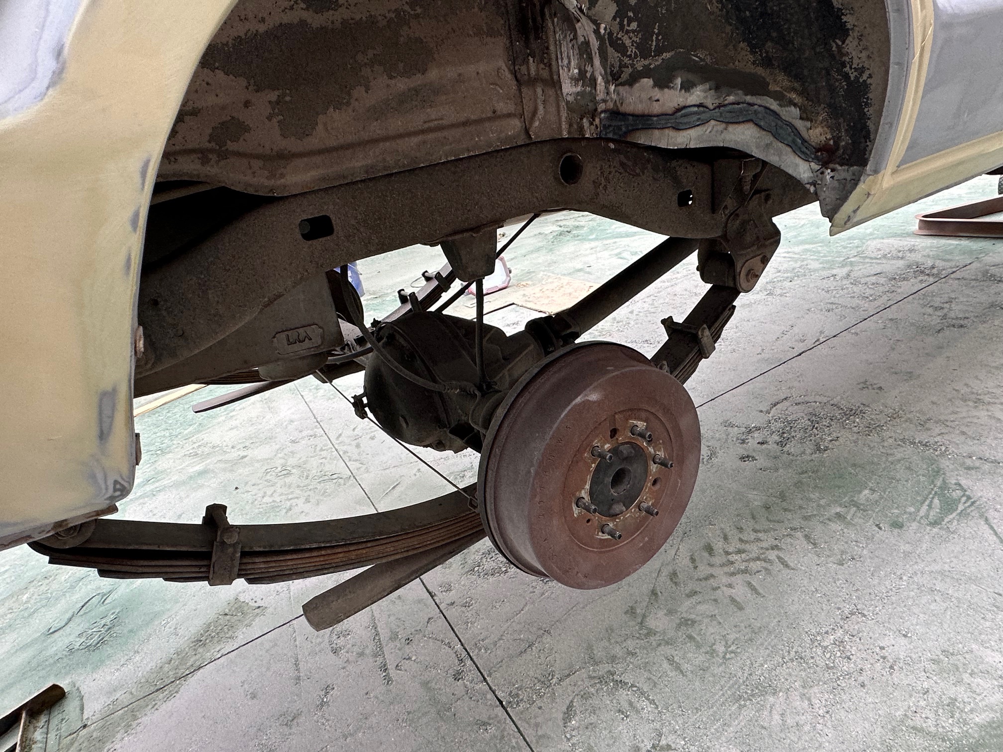

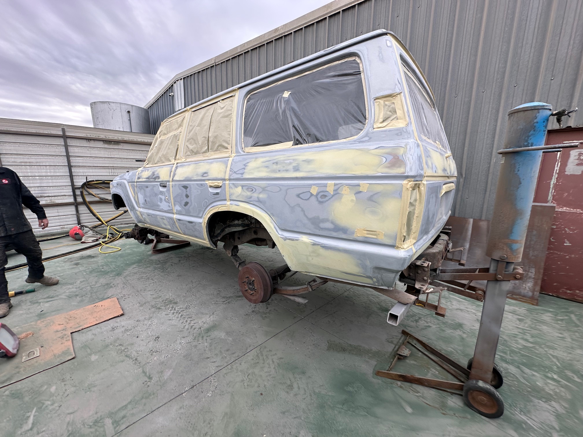

Day 16 - Sandblasting is magic.

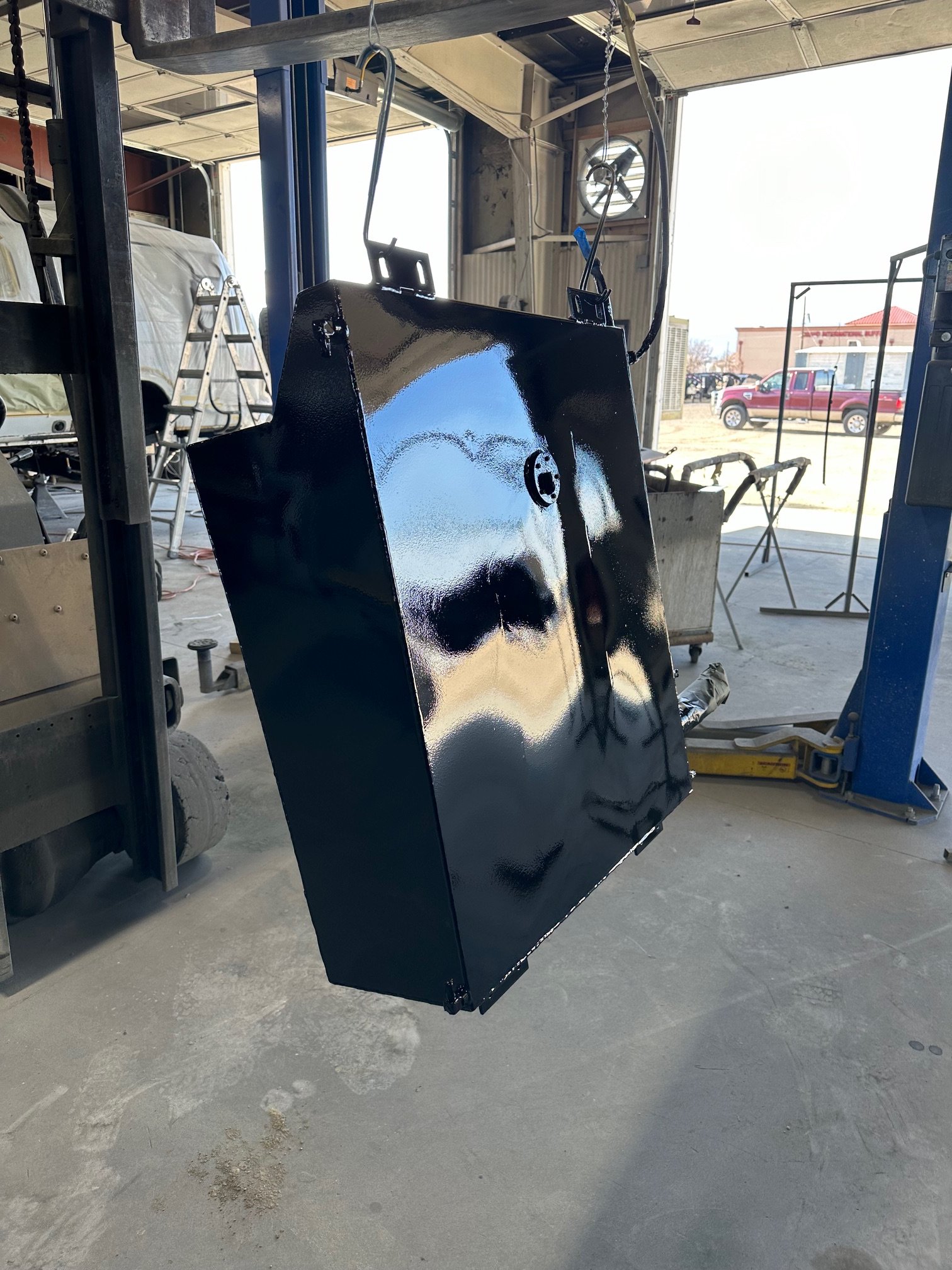

Body work is done and the frame was blasted for paint prep. The gas tank will be dropped before final paint and will be painted the same black.
Great news that there was no unknown frame rust present. About what I expected and easy to patch.
@Rzeppa Look like some familiar spots? Same exact area on the shock crossbar.

Yes, crossbar rust in same places, both crossbars. On the one for the shocks, I sleeved both ends and rewelded. Your inside frame rust looks worse than mine was, maybe because mine was originally an Arizona truck and had literally no rust when I bought it in 2011, so everything I experienced is thanks to CDoT's mag chloride, and to a lesser extent NaCl. If you go with the 4x4 Labs rear bumper, that rear crossbar gets cut out and replaced with a new, beefier crossbar.

What size Tank was that again, looks a lot like my 38gal.
I was listed as a 40 gal LRA but it looks a bit different. It does have the LRA stamp, maybe they changed the design? Good chance its the same as yours.

I don't know if it is the forum software or what, but a bunch of the images in the post above appear duplicated multiple times when I scroll through it. Good pictures though!
4,789
The wheel chair seems like a brilliant idea. Is it common in shops like this or unique to the Rust Doctor?
4,375
I’m guessing he needs it.
